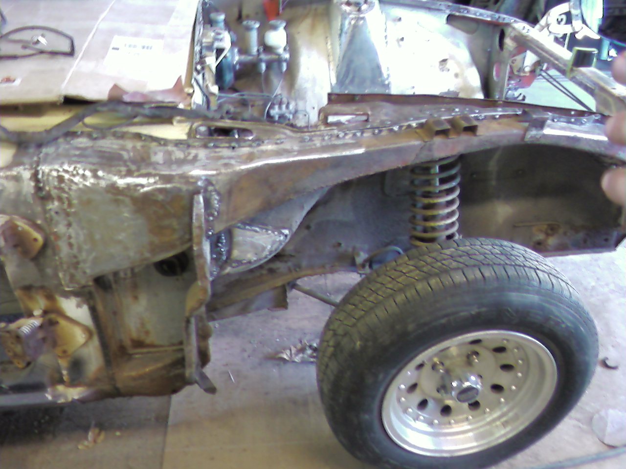

HS30-H Posted September 22, 2009 Share #50 Posted September 22, 2009 Matt,I'm sorry I could not answer you more promptly, as I was away for a few days and am now trying to catch up.I'm glad that you didn't buy the 260Z that was on ebay, as I think it would have been a mistake. Yes, the bonnet and tailgate from that late 260Z would have fitted your 240Z, but the doors would not. Cutting it up to use as a donor for chassis / bodyshell parts would have been a lot of work, and many of the sections are different anyway - even if they were sound enough to be used. Have you uncovered the 'air tubes' on your car yet? I'm afraid that if the rot is as bad as you describe ( you mentioned the radiator support panel is bad too ) then you might need to sit down and think about this car as too much of a moneypit to be worth continuing with. Even if you do find the chassis rails, air tubes, rad support and other sheetmetal that you need, it all still needs to be attached properly and you still end up with something made Frankenstein style. It will cost thousands, for sure, and then you need to paint and trim it.....My advice would be for you to consider sourcing a similar-year car with a sound bodyshell to put the RHD parts from the green car onto. If you source a complete LHD car, you will be able to 're-shell' your RHD and save a lot of time and money into the bargain. In the long run, you will be left with something that is better than the possibility of a patched-up mess or even an uncompleted project ( been there, done that! ). There's what I think is a good candidate on ebay in the UK at the moment: http://cgi.ebay.co.uk/ws/eBayISAPI.dll?ViewItem&item=250500841929&ssPageName=STRK:MEWAX:ITAlthough I don't know what that car will eventually sell for ( possibly around £3,000? ) I think it would not take long for you to spend the same amount on your car and for it still to be no better. A pair of good, sound and unrusty 240Z doors will easily change hands for £600 in the UK these days. Add in a sound bonnet and hatch lid and you'll have no change out of £1,000. Professional repair of your originals will likely cost just as much, if not more.I'm betting that most of the suspension components, brackets and pipes on your UK car will also be pretty much rotten. The USA car would likely be much better in that respect too. Don't underestimate what the whole thing can end up costing you if you go ahead with the rusty UK car.Sorry to sound like the messenger of doom, but I'd like to try to guide you away from taking on something that you might never be happy with.Cheers,Alan T. Link to comment https://www.classiczcars.com/topic/32980-datsun-240z-barn-find-restoration-cont/?page=5#findComment-295410 Share on other sites More sharing options...
Montezuma Posted September 22, 2009 Share #51 Posted September 22, 2009 I think Alan might be on to something. I am shocked by the rust in your car. If you are willing to do all the welding in of the new parts and spend the money then go for it. Link to comment https://www.classiczcars.com/topic/32980-datsun-240z-barn-find-restoration-cont/?page=5#findComment-295431 Share on other sites More sharing options...
mattbibbey Posted September 23, 2009 Author Share #52 Posted September 23, 2009 I couldn't agree more alan! And no worries about the reply. I was doubting whether or not to buy it at an early stage any way . The more time i spend on the car the more encouraging, rust free stuff i find. I believe that i've discovered the worst of it now so that's the air tubes ( which may be repairable, i think they're holed and not totally shot away), that front right chassis member that the picture shows by the sway bar, the floor pans and the rad support panel, small patches under the drip rail above the doors. other than that there's just the odd small bit here and there. My doors are in mint nick with not a patch of rust on them. The wings are rust free too. The car going backwards from the fire wall really, isn't too shabby. The only rust visible from inside the car is the floorpans, granted they're pretty bad. I'm in the fortunate postition where my friend (also in the army) and his father, used to restore classic cars for a living so they will help me free of labour charge as his old man is retired now and it will keep him occupied. Plus if i need a cash injection, i can always volunteer for a tour of afghanistan! I have to go anyway, might as well use the money for good. Haha. I am a realist and i fully understand the implications of all that needs to be done so i haven't ruled out the idea of getting a different car. I am quite overwhelmed by everyones help and advice so i thank you all! Matt Link to comment https://www.classiczcars.com/topic/32980-datsun-240z-barn-find-restoration-cont/?page=5#findComment-295515 Share on other sites More sharing options...

mattbibbey Posted September 27, 2009 Author Share #54 Posted September 27, 2009 when i finally get the wings off my car, and everything else, how do i go about cutting out the old chassis legs and welding in the new ones? i'm a competent welder but i'm not sure on the best method and order to do it. If anyone has done this before i'd be grateful for some pointers!Matt Link to comment https://www.classiczcars.com/topic/32980-datsun-240z-barn-find-restoration-cont/?page=5#findComment-295844 Share on other sites More sharing options...
EScanlon Posted September 27, 2009 Share #55 Posted September 27, 2009 Ahhh... English terms and Yank terms. I know "wings" = "fenders", but am at a loss to for "legs". Unless you're referring to an old ZZTop song, in which case I'd suppose you're referring to the tires (tyres?). I'm not trying to be offensive, but could you elucidate on "legs", that being the term that has me at a loss.In very broad general terms, measure between key alignment points, measure and compare to the FSM (Factory Shop Manual) dimension sheet... you may have to do some basic number crunching, and clamp, support and otherwise rig up a frame to hold it all together before you do your first spot weld to hold in position. Then once you've done enough of these to hold the pieces in position, re-measure and adjust if necessary.With your experience as an armourer, you know that it only takes a gnat's width to cause problems. Hope this helps.E Link to comment https://www.classiczcars.com/topic/32980-datsun-240z-barn-find-restoration-cont/?page=5#findComment-295858 Share on other sites More sharing options...
mattbibbey Posted September 27, 2009 Author Share #56 Posted September 27, 2009 Yes, unfortunately i do know only too well about small things making big problems haha!!The leg i was refering to is the front portion of the chassis member, the part running from the front towing eyes to the floor pan supports. The part that includes the sway bar bracket, the engine mounting brackets and so on. I found some from a UK company fpr 300 pounds each. datsun 240Z parts aren't common here.Thanks for the heads up about measuring before and after the spot welds! Probably would have overlooked that.ThanksMatt Link to comment https://www.classiczcars.com/topic/32980-datsun-240z-barn-find-restoration-cont/?page=5#findComment-295862 Share on other sites More sharing options...
