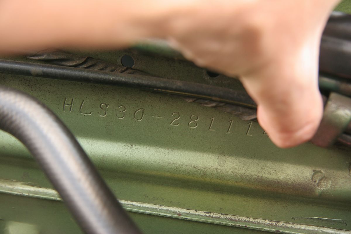

It doesn't appear as though the space OR alignment is uniform. The number isn't level either. It makes me wonder how the machine that made the numbers is used and set up. More so because of the theory that it was ground in place rather than before assembly of the fire wall which does not have much working space. Are you talking about the 'carat' (^) between the 3 and 0? That looks to me like the head of the rotary tool was dragged a bit between the two numbers. I wonder if the "serial number grinder" resembles some sort of Leroy device. That process involves a lot of hand and sight alignment between various characters.

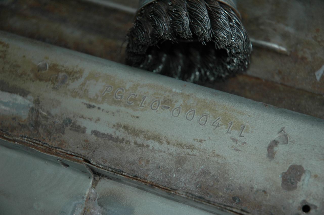

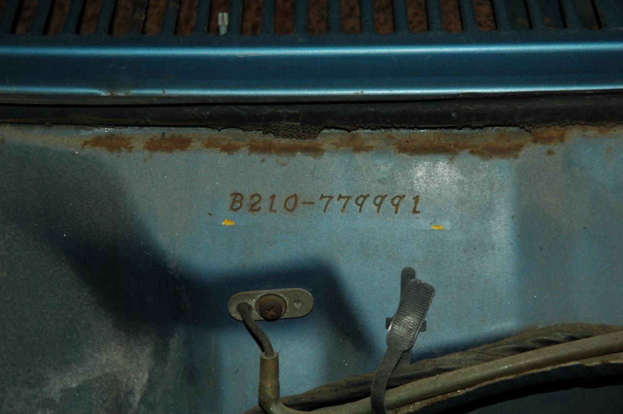

As reference, here are close-ups of chassis numbers on a couple of other models from a similar time frame to 'our' cars - a PGC10 Skyline GT-R and a B210 Sunny Coupe. Note that these cars were not made in the same factory as our Zs, so the same type of machine must have been used by other Nissan manufacturing plants too. Subtle differences in font, as well as noticeable similarities?

The B210 photo is very interesting, Alan. It appears level and uniform in contrast to the other photos in this thread. One thing shouts out to me. Is the B210 engraving after the body paint? Notice what appears to be remnants of a tape just below the serial number? I am reminded of the S30-00002 thread with a similar "something" around the serial number.
Don't get foxed by the remnants of yellow paint around the 'Shatai Bango' on the B210, Chris. That's just left over from the Japanese 'Shakken' tests, where the engraved number is sometimes highlighted to make it more legible and show that it has been checked. All of that is a continuing and regular thing through the car's life in Japan.
I agree that the B210 engraving is very neat and regular, whereas S30-series Z engravings can sometimes be very haphazard. They can look a little wobbly on C10 Skylines too. I wonder if it's something to do with the awkward location of the engraving on the Z in comparison to the B210? There's plenty of space around the B210 engraving. I wonder if the machine was fairly unwieldy?
It appears that either the equipment improved or the operators became more skilled by the time Michael's 11/75 build '76 280Z was produced. It is very well layed out, but my opinion is, if the paint was removed it would become obvious that it also was engraved. Also the B210 has a well refined appearance that seems to take human inconsistancies out of the equation. The PGC10 Skyline GT-R example is nicely done and perhaps more of a concious effort was put into its execution? Bonzi has a good understanding of the 60's technology that would have been used to engrave these numbers and can probably come up with a better explanation than me. I find myself comparing it to the operating principal of an old Wrico lettering set that I still have. I'm visualizing a small rotary cutter in place of the lead/ink stanchion, built into a compact, portable unit that is easily dialed in to the letters/numbers needed. There are several holes drilled into the firewall in this area that could have served as locating points for a small handheld unit. Is this along the lines of a "Leroy" device? Guess I should look that up.
