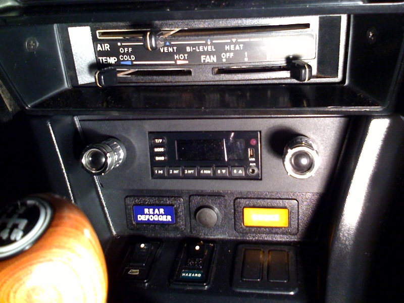

I had a lot of luck installing a retrosound stereo, I can plug a flash drive full of mp3's into it, or even connect my ipod to it using a headphone jack.
I cut the faceplate myself. It didn't require any modification to the dash, or console. So if I ever wanted (and I don't know why I would), I can always put the original radio back in.

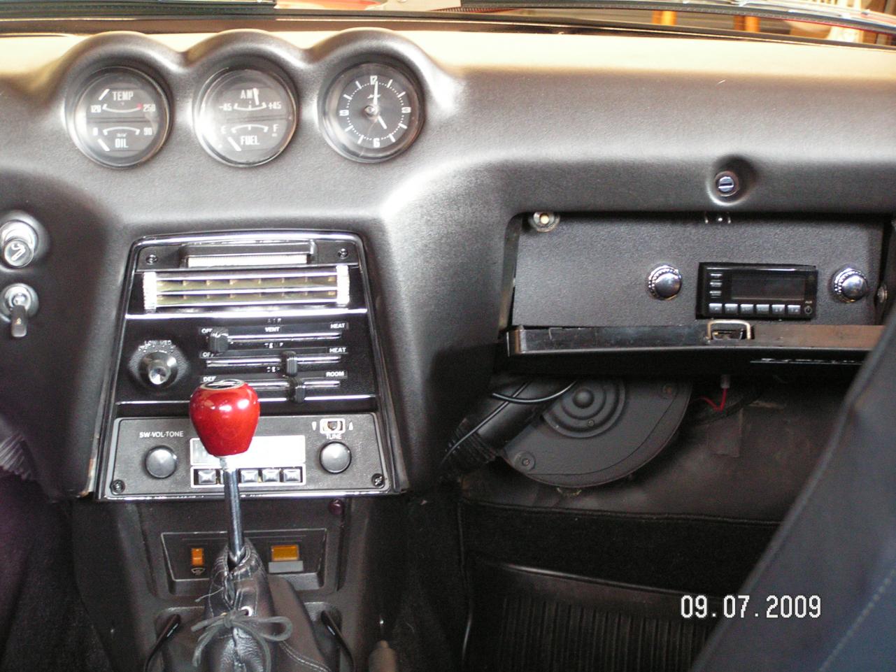

This stereo also comes with a remote control, so if you want to leave the original radio in place for originality, you can install the retrosound stereo under the seat or in the glove box.
