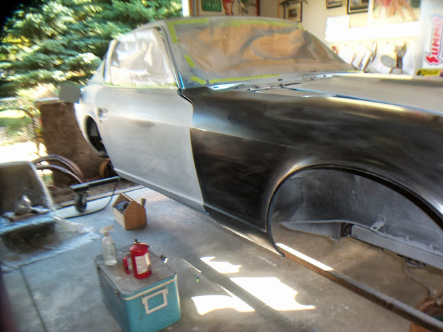

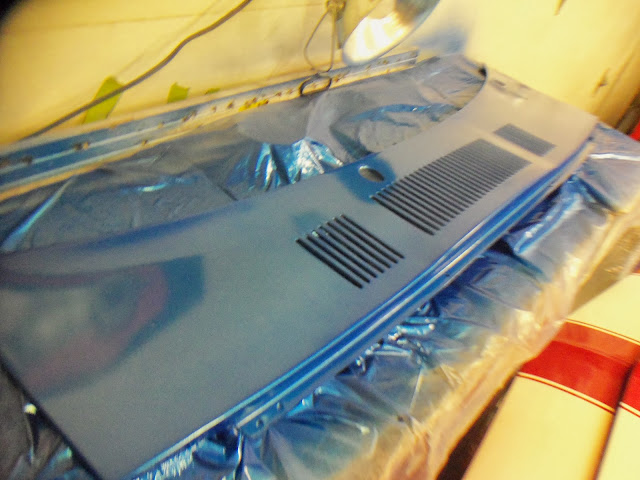

The entire job today took 6 hours, but I did the inners and exterior all at once this time. You can see the light-blue color I mixed first awaiting it's re-caoting. First up though, a sealer coat on the exterior panels:
I hung the hood and deck lid from a rope stretched across the shop so as to get at both sides:

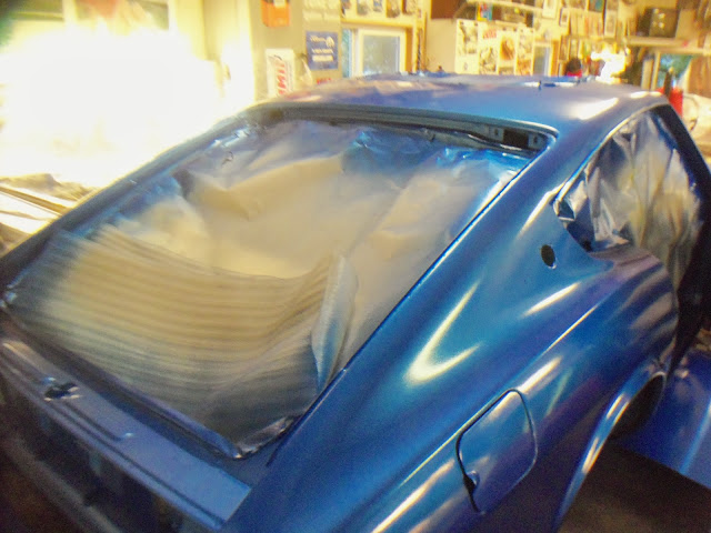

...and BAM! She's blue! I sprayed 3 coats of Dupli-Color's DIY-friendly Lacquer paint. No mixing, no thinning required. It covered extremely well,, went on like butta and the metallic sat right - the first time.
The 3-4 coats of Dupli-color clear went on really easily as well. All-told, it took 5 hours of straight spraying (including flash-times).
Lacquer doesn't have the same shine right out of the gun as do the 2-part Urethane products, but it can be "color-sanded' (wet-sanded and polished) to the same glossy finish.
