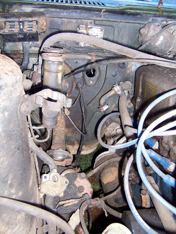

Do the Coupes use a mechanical or electrical fuel pump ?, since the engine has been swapped (L26) I don't know if the original engine had a mechanical pump or not, but on mine, it has a fuel filter holder on the shock tower, I know my 3 other sedans do not have that.

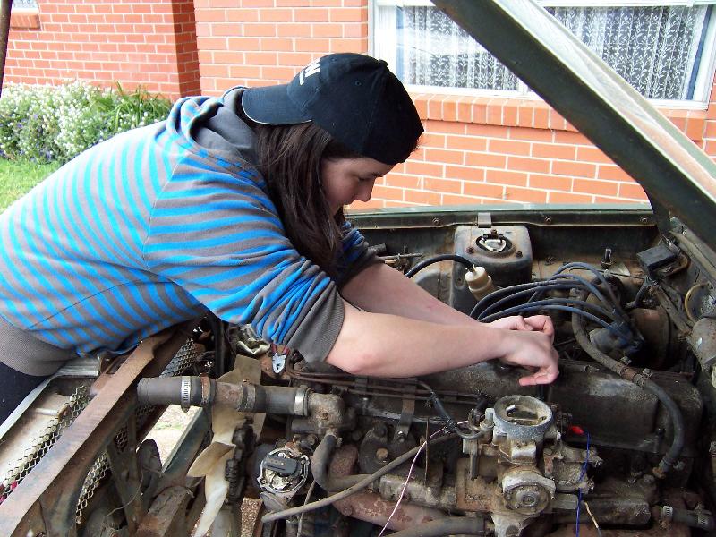

I finally got it running Sunday, a fair bit of wizz farting around, it would fire every now and again, and not run, in the end I found out the fuel line is blocked some where (in the steel line), and 60PSI of air pressure would not budge what ever is in the line, also I found the metal part in the coil (the bit in the hole) was rusted away, and in the end I found the points were stuffed, I fitted my electronic distributor (spare from my other car when I went waste spark), turned the key, fired straight up..
I made $2.00 from my daughter who said it wouldn't go.. :-)
but in the end she made a few $$ from helping me.
