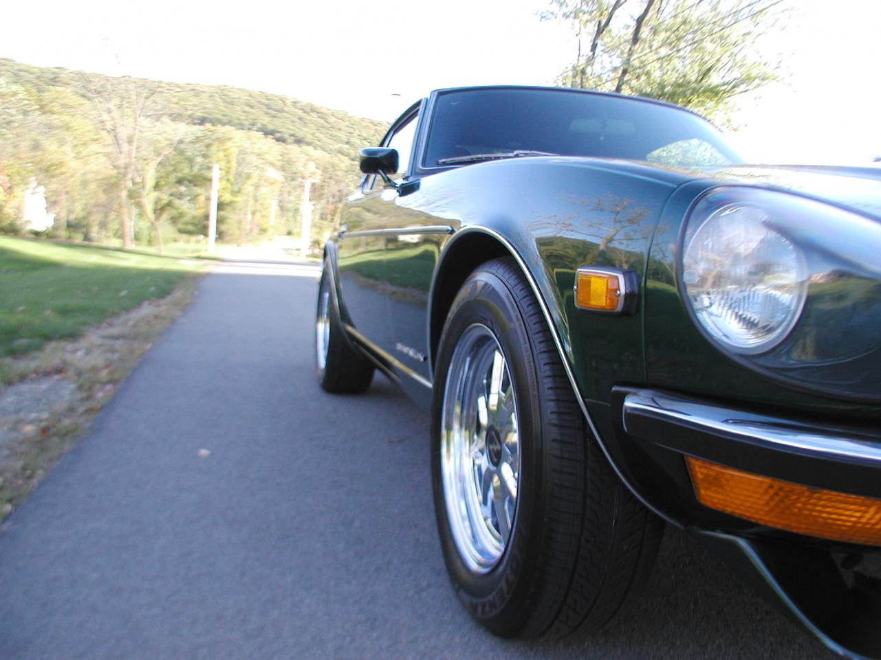

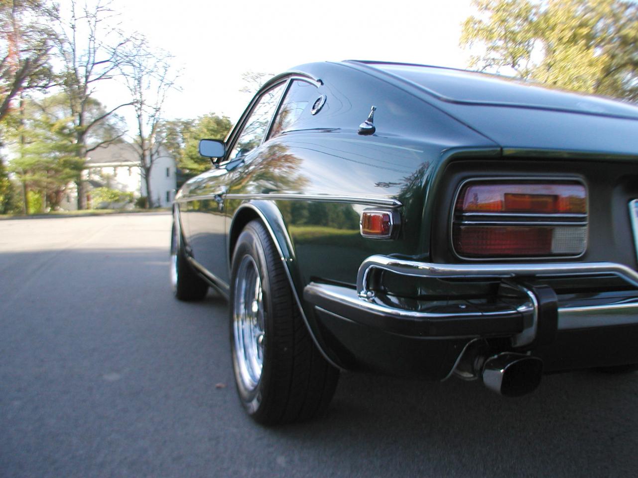

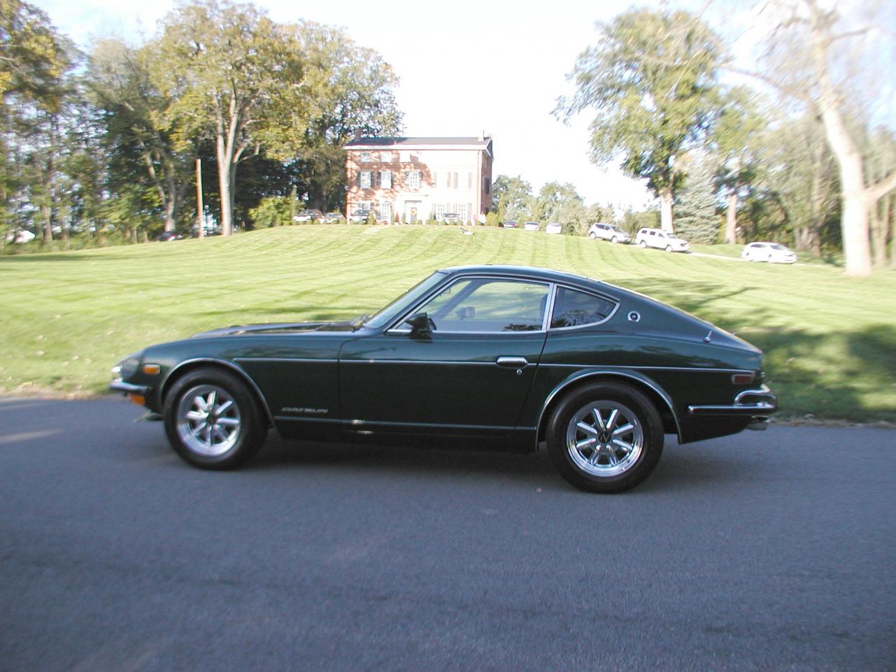

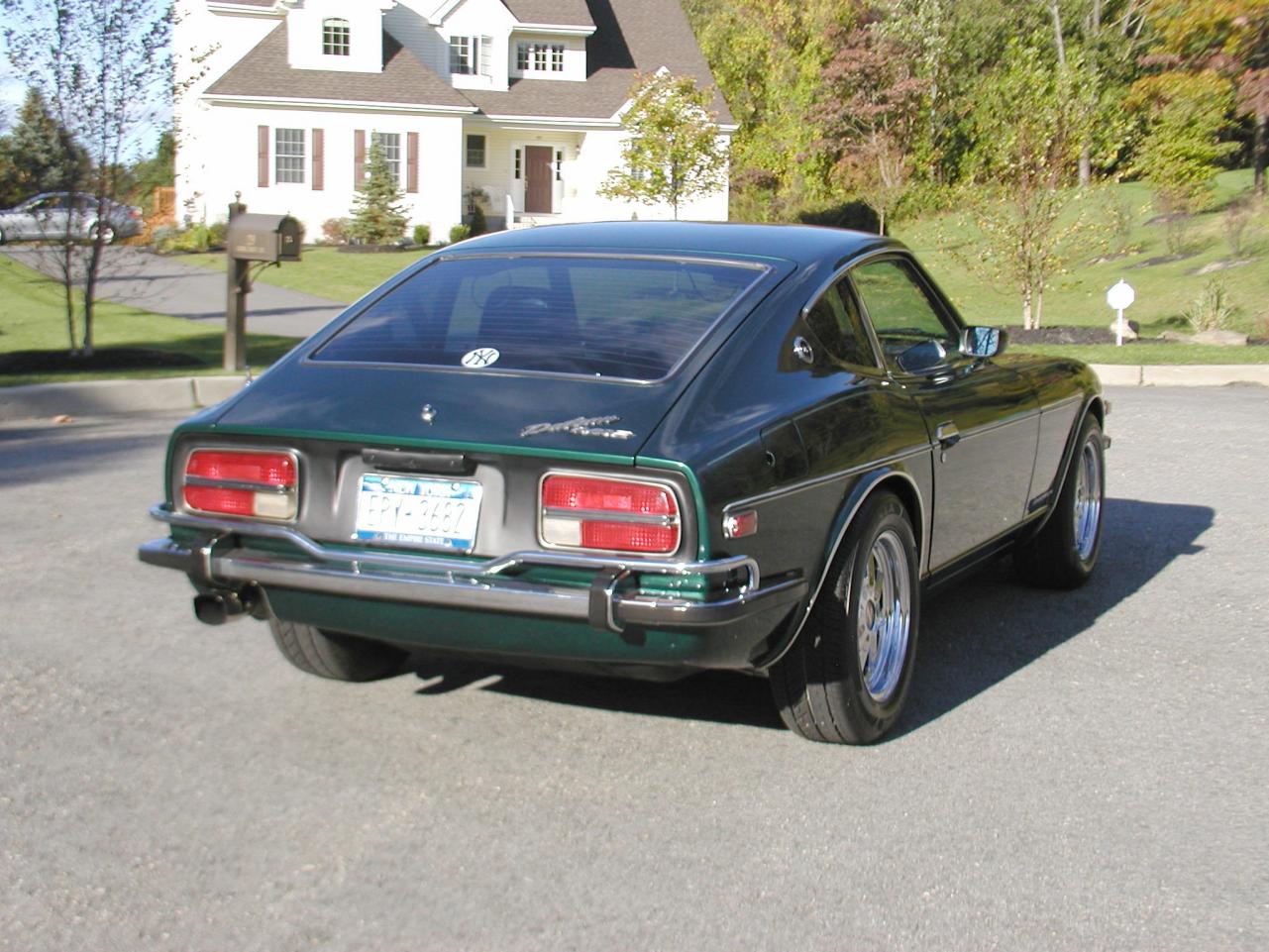

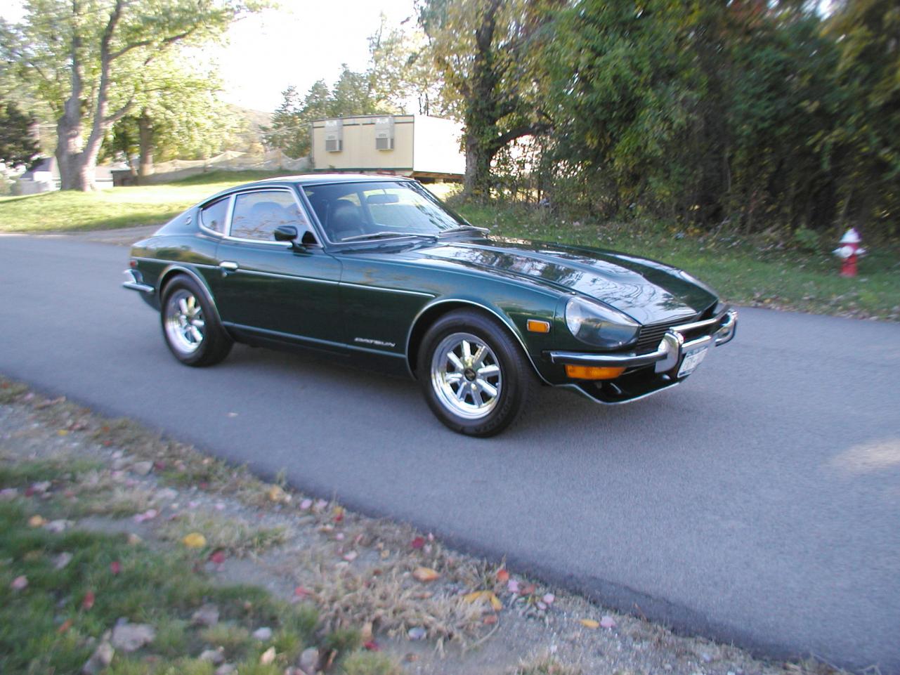

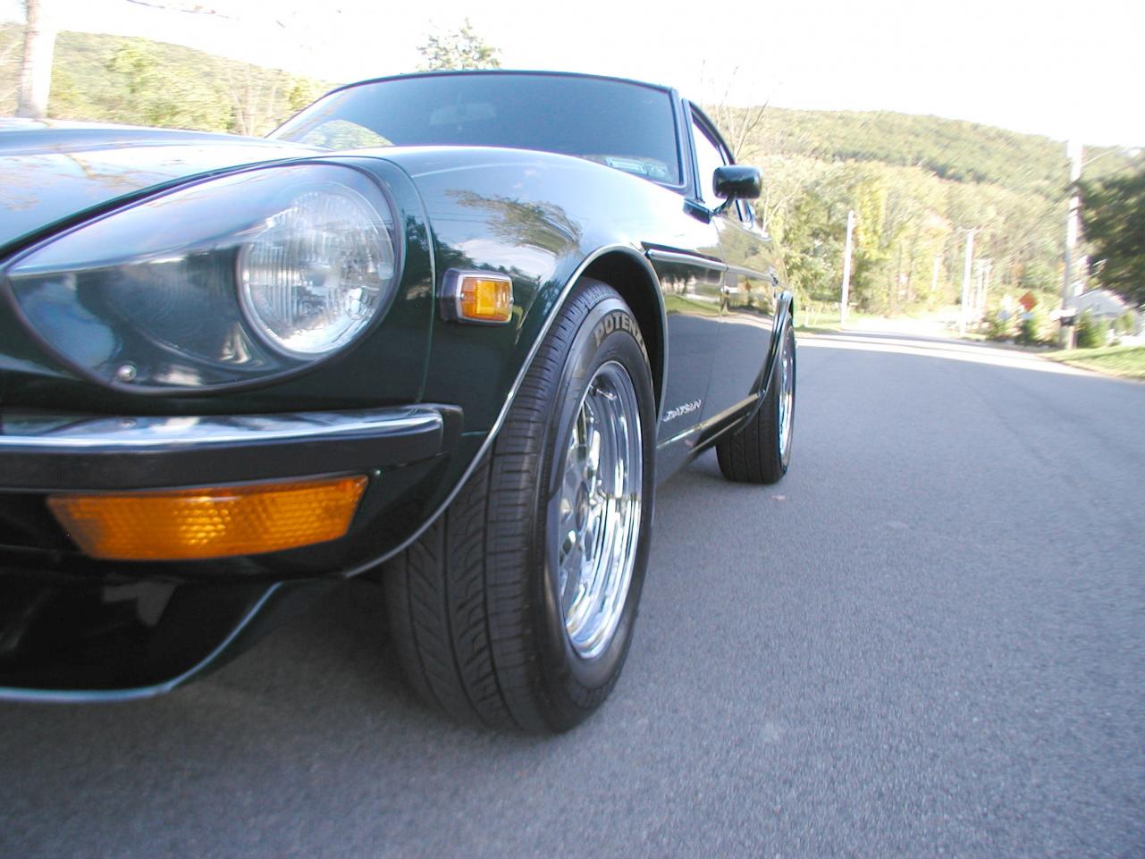

October 28, 200915 yr comment_298764 Zedyone, I have EXACTLY the same problem you did, with a rub on the right front tire against the forward lip of the fender when backing (but not pulling forward). I have the same Panosport rims, with Goodrich Comp T/A radials -- 215/60R15. I have probably half the original tread on the tires. The previous owner confirms that he experienced rubbing on occasion. I've been doing calculations, and I think I can pull in about another .3" of clearance with 205/60R15 tires -- approximately the same diameter as stock, but a bit more offset. Of course there's always the factor of the extra tread on a new tire. I'm thinking the 195/60R15 would give me another .3" still, but it would be about .25" smaller dia than stock. I'm just wondering what that looks like. I'd love to see a few pics, if you're able. Link to comment https://www.classiczcars.com/forums/topic/33495-wheel-rubbing/#findComment-298764 Share on other sites More sharing options...
October 28, 200915 yr Author comment_298804 NO problem. I will snap some for you this evening. To be perfectly honest, I cannot tell the difference in size at all. It is so close to the naked eye, it looks identical. Let me snap some pics for you.215's would have rubbed really bad for me as well. I like the looks of the 195's. I am loving the refinement of the Grips I bought, but I do wish they had a stiffer sidewall. I am still a corner carver at heart, and the Z is so much fun to drive into and out of the corners. If I had my choice again... I would definitely go with a 195/60/15 again, but I would probably go with a summer tire vs an all season. What I gained in ride quality, I lost in all out steering feel. Edited October 28, 200915 yr by Zedyone_kenobi Link to comment https://www.classiczcars.com/forums/topic/33495-wheel-rubbing/#findComment-298804 Share on other sites More sharing options...
October 28, 200915 yr comment_298807 Thanks, Zedyone! Link to comment https://www.classiczcars.com/forums/topic/33495-wheel-rubbing/#findComment-298807 Share on other sites More sharing options...
