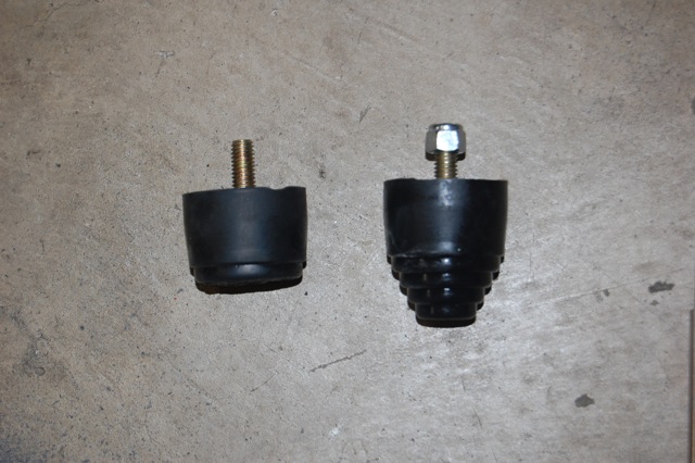

Installed mine this morning. Took about 2 hours. I did not completely drop the diff as I was lazy and didn't want to disconnect the driveshaft or halfshafts. Was probably a bit harder that way, but not too bad.
The mount was a VERY snug fit into my car's tunnel. Took some persuading to get it up far enough to get the bolts in place. Nothing too bad, but some work, none the less.
I used the stock mount on the crossmember with a black #9.9101G bumpstop as noted earlier in this thread. On my car with the R180 in the stock '70-71 (forward) position and a reasonably fresh lower mount, I had to trim three 1/4" steps off the bumpstop (3/4" total, see attached picture). This gave me a really snug fit, there is pressure on the bumpstop at all times. I didn't want it to get too sloppy if bumpstop breaks in.
Been waiting for someone to post dimensions,now I can drag my lazy backside out and get this done. Thanks Arne.
I think that's what I did to my bump stop. Maybe one more step, but That looks good. That's a good thought about the bump stop settling down.
Thanks for the pic.

I thought I would put this out there about finding the bump stops.
Advance Auto Parts-- energy suspension $12.99 per pair
Checker- #11.99/pair
When you go to your local auto parts store, check the "Performance" section of the store. If they have them they will be near the sway bar links and ES transmission mounts.
As far as price, You can go to ES suppliers and get them cheaper, but add to that shipping and handling it will be over the local parts store prices.
