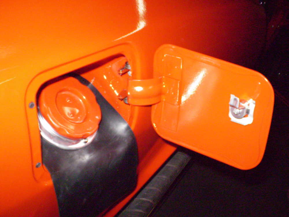

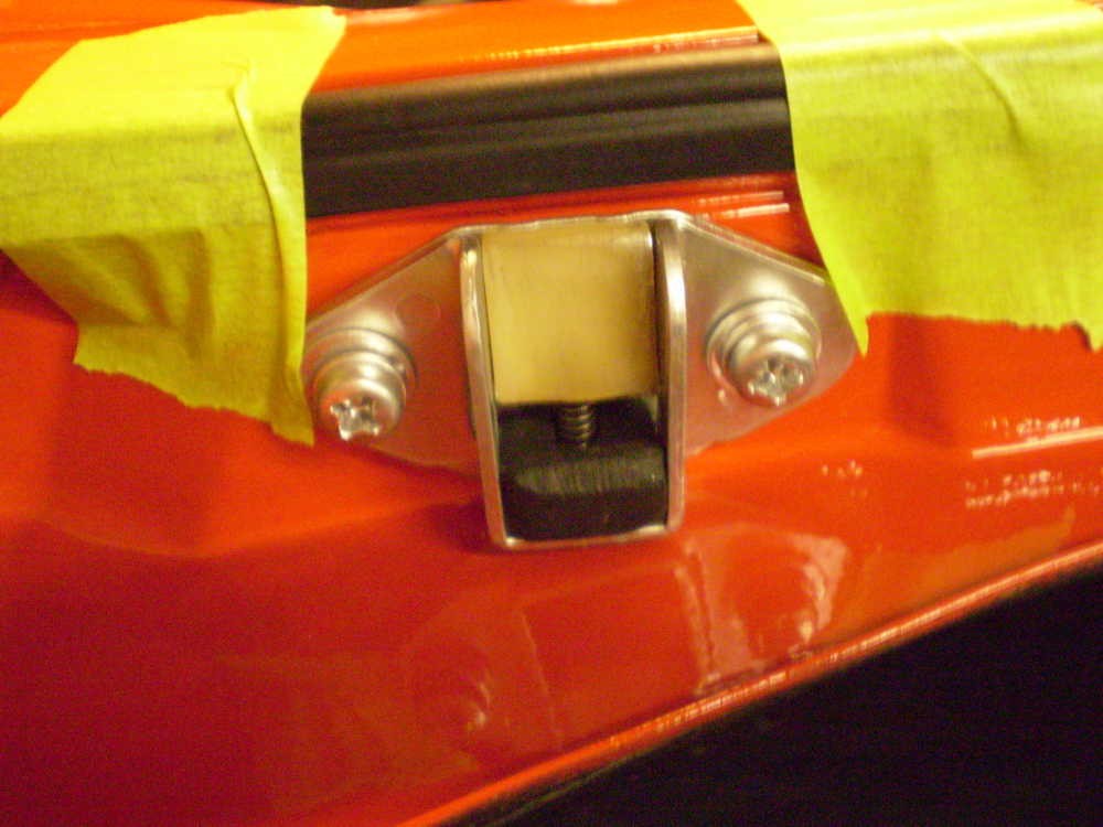

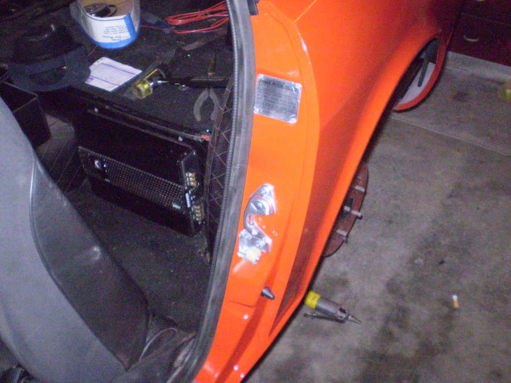

The fuel filler ring and the fuel doors lock clip, the hatch stopper and the doors lock clasp were all plated with the Tin-Zinc :finger: plating kit. Then polished with a soft cotton towel or a light metal polish.
