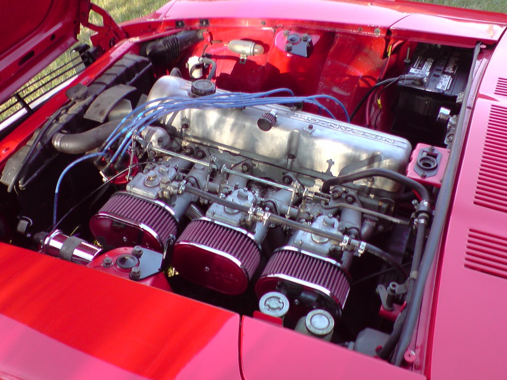

I had the single ITG on a triple Weber 240 I used to own (now Lazeum's car). It was big $$$ and was hard to get on and off for tuning, but from everything I read, it was supposed to be the best for performance. I think I paid close to $300 for it many years ago. I doubt I would buy that one again due to the cost and pain to R&R.
Hi Jeff! The ITG is still in my garage but it has always been a pain to install/remove and to work around with it. Moreover each time, we (me & Glenn before) have to remove it, it was sliding along the brake master cylinders. the foam is no more in good shape.
So I switch to 3 K&N filters. I haven't felt any difference by changing the filters and it is more practical. I think also it looks good.
