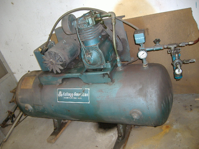

Another thing on air compressors that they never told me, or read. Every now and then, depending on use and weather, you must drain the TANK of water that has accumulated in the bottom. If you don't, after many years you will have a hole in your tank, as I do now. It took 28 years to eat through. Painted 2 cars before I got it. Mostly tire duty the years I had it.
It wouldn't be too bad if it was a small inexpensive unit, but it is a very large Kellogg-American 2 stage 5 horse. About fell over looking at prices of new ones. The tank is 5.5 feet by 2 ft in diameter. No telling what it would will run to replace the tank. I might just sell it as it is and get a smaller one. Can't complain too much, it came with the house/garage, and a small envelope to the PO. ;)

You should release the air every three months or when you have high humidity and cold nights. Where you live you could consider, but not as important as what has been mentioned a pre-humidity filter that goes over the intake. the problem is your always replacing the filter material.
Replacing the tank would be cheaper than getting a used compressor. It can also be repaired by a certified welder. In your climate, drain daily. The air pressure will clear out the water if cracked open a hair. Replace the drain valve with a ball valve.
They also make an automatic drain, but if you don't use it continually it's overkill.
