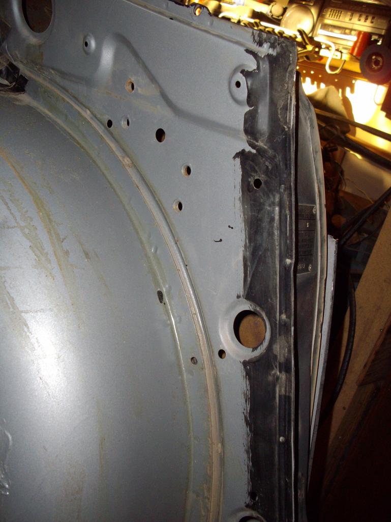

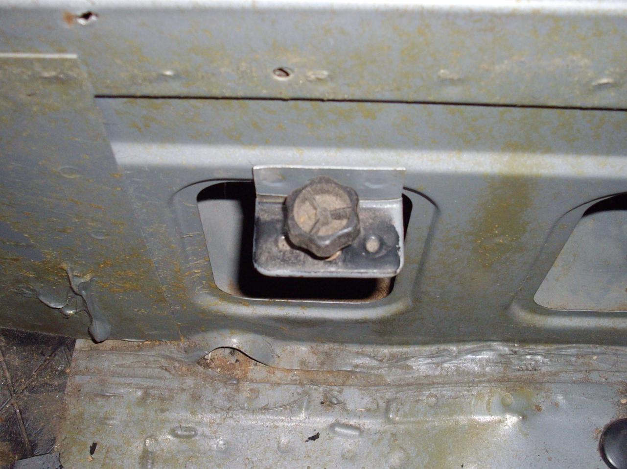

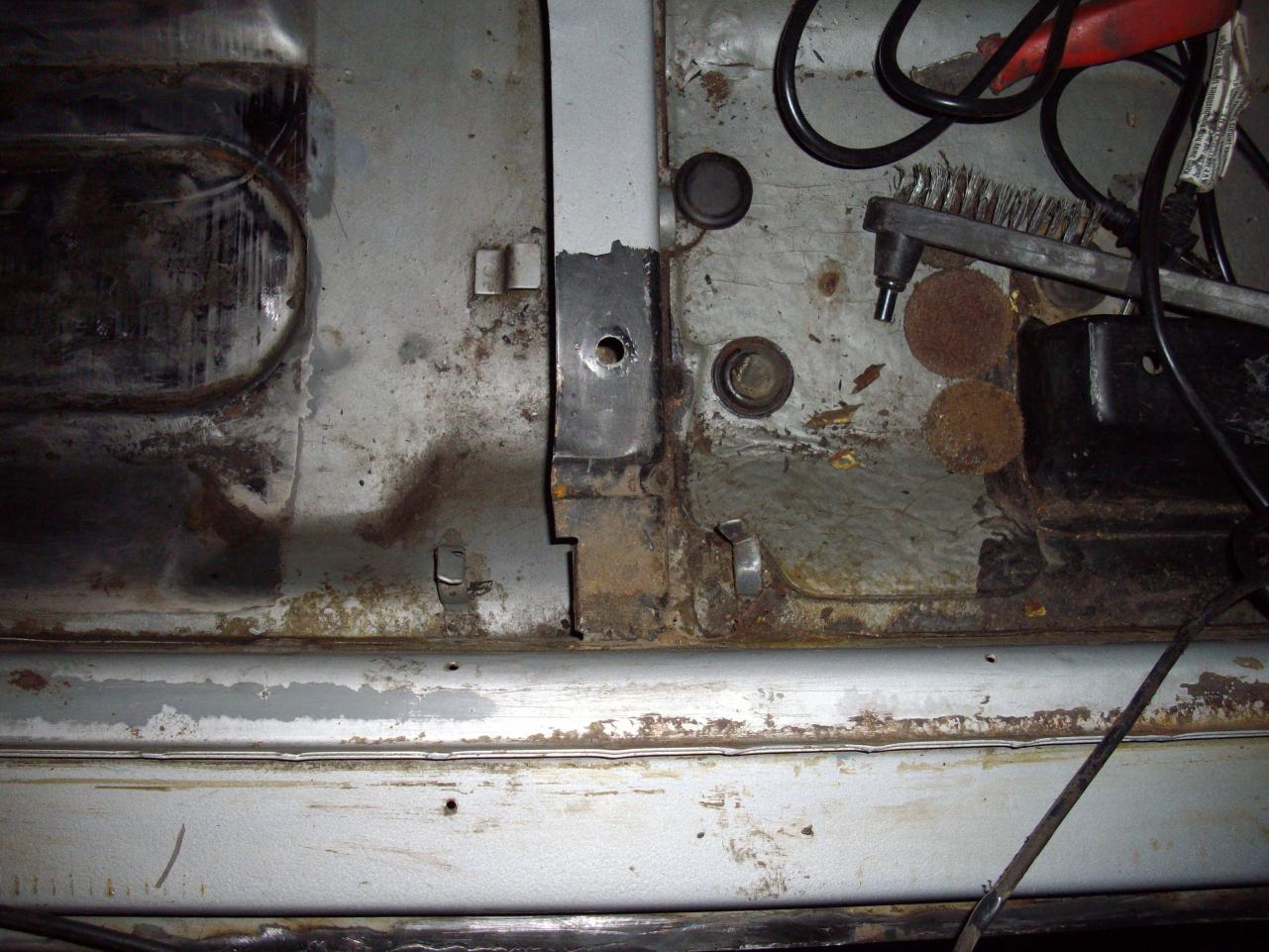

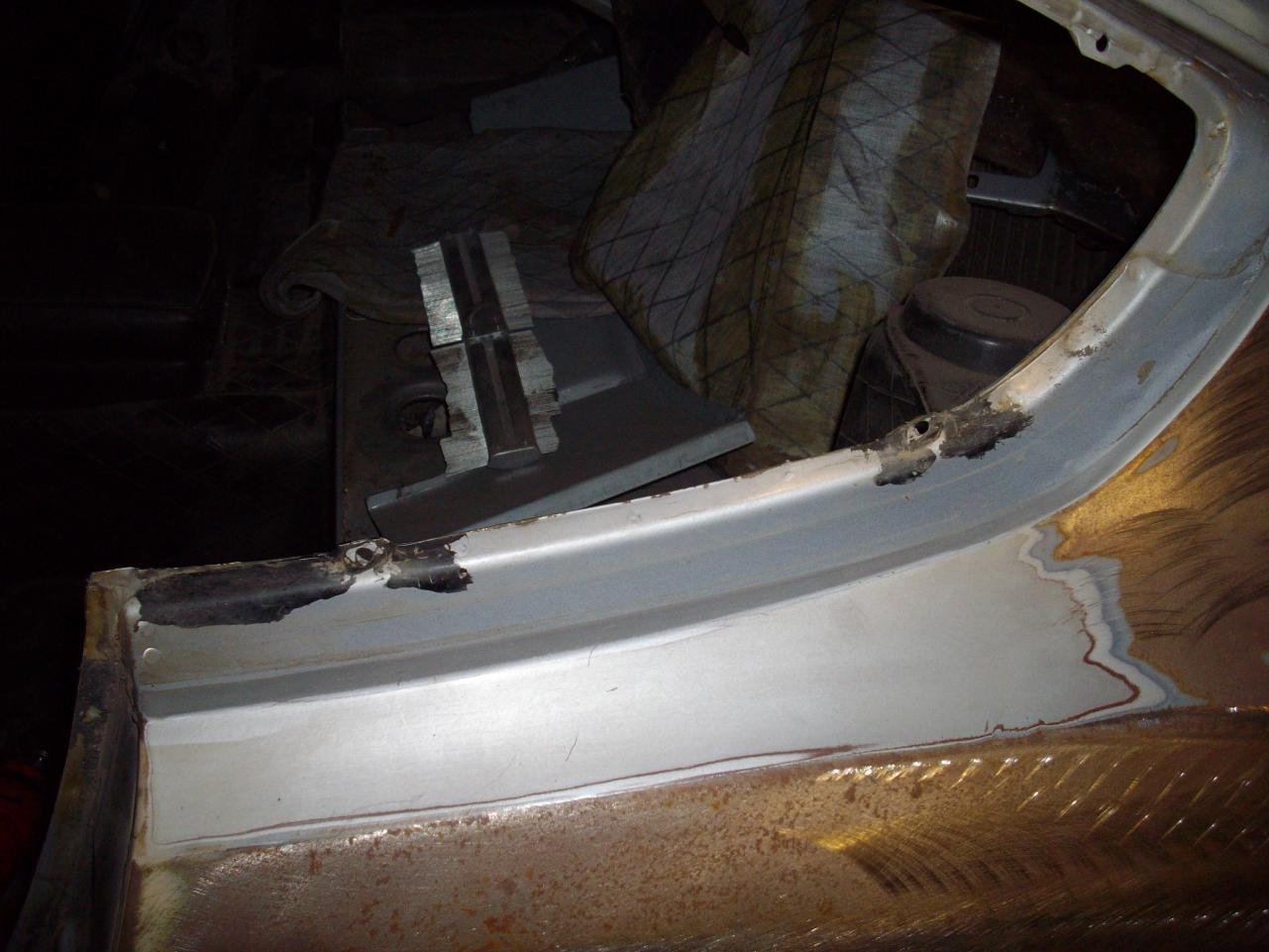

Richard: here are a few photos of some of the areas. I did not take any of the front,rad support area. I can not get at the front without opening the large door on my garage and it is -38 C today:sick:.
Dan
Dan
If you look at the fourth picture of this post, this shows the aft door opening bead edge. If the do the same black across the bottom of the threshold open and then up the front door opening edge to the pillar post, and, also, extend this threshold door opening painted edge both forward to the fire wall and aft to the wheel housing, along the top edge of the inner rocker panel, this will hide any body color which may show below the rear dog leg panel or the front kick panel and the rocker panel vinyl trim piece.
