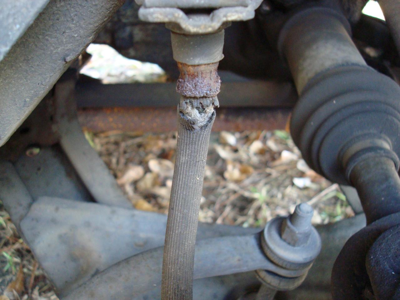

My rear brake line is toast like yours, glad i purchased SS brake lines not even knowing what condition mine were in. I figured 32 years old they had to be bad and i was loosing brake fluid some where.
Ouch! I haven't gotten to the rears yet. Now I'm scared. LOL
