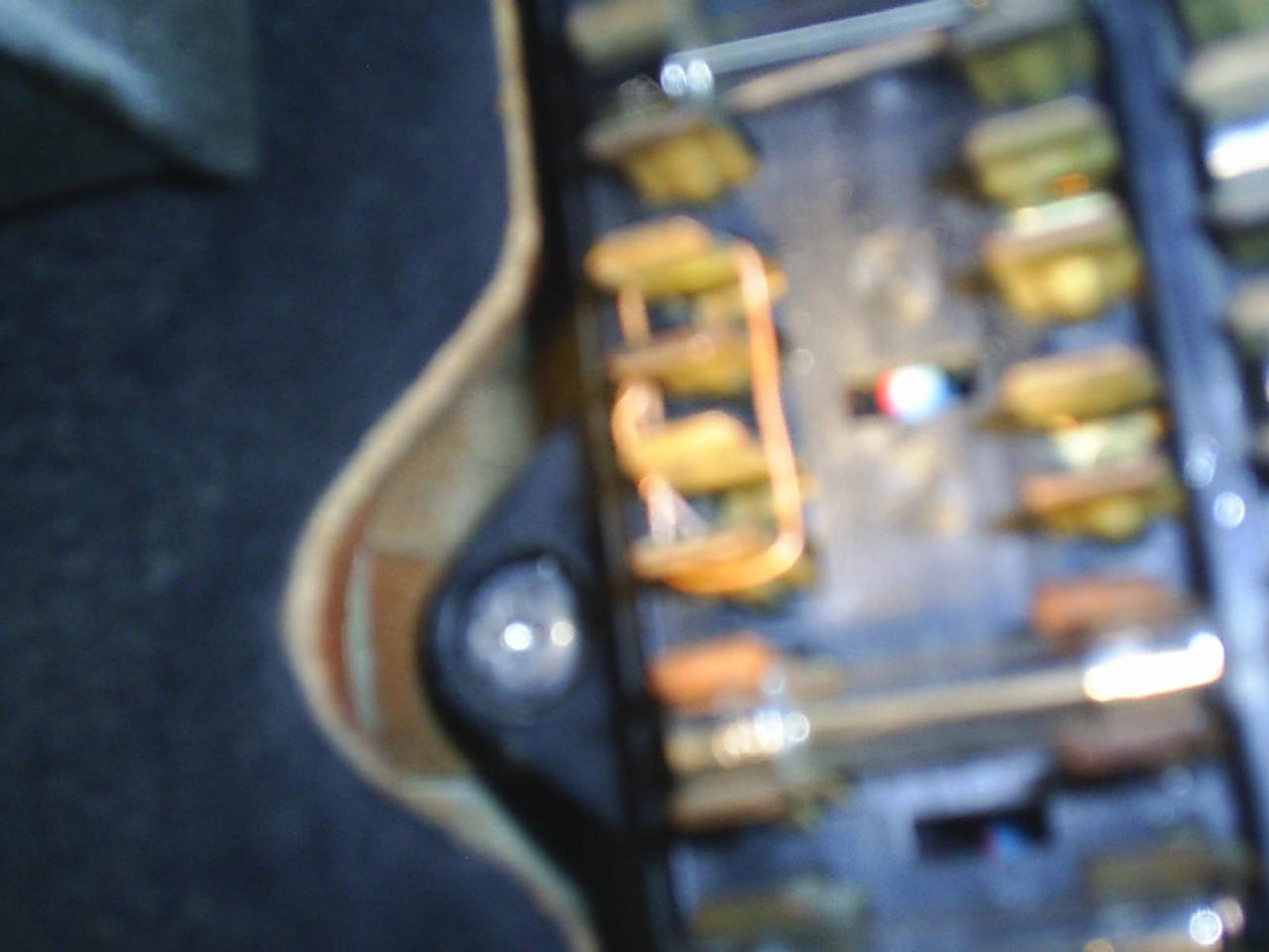

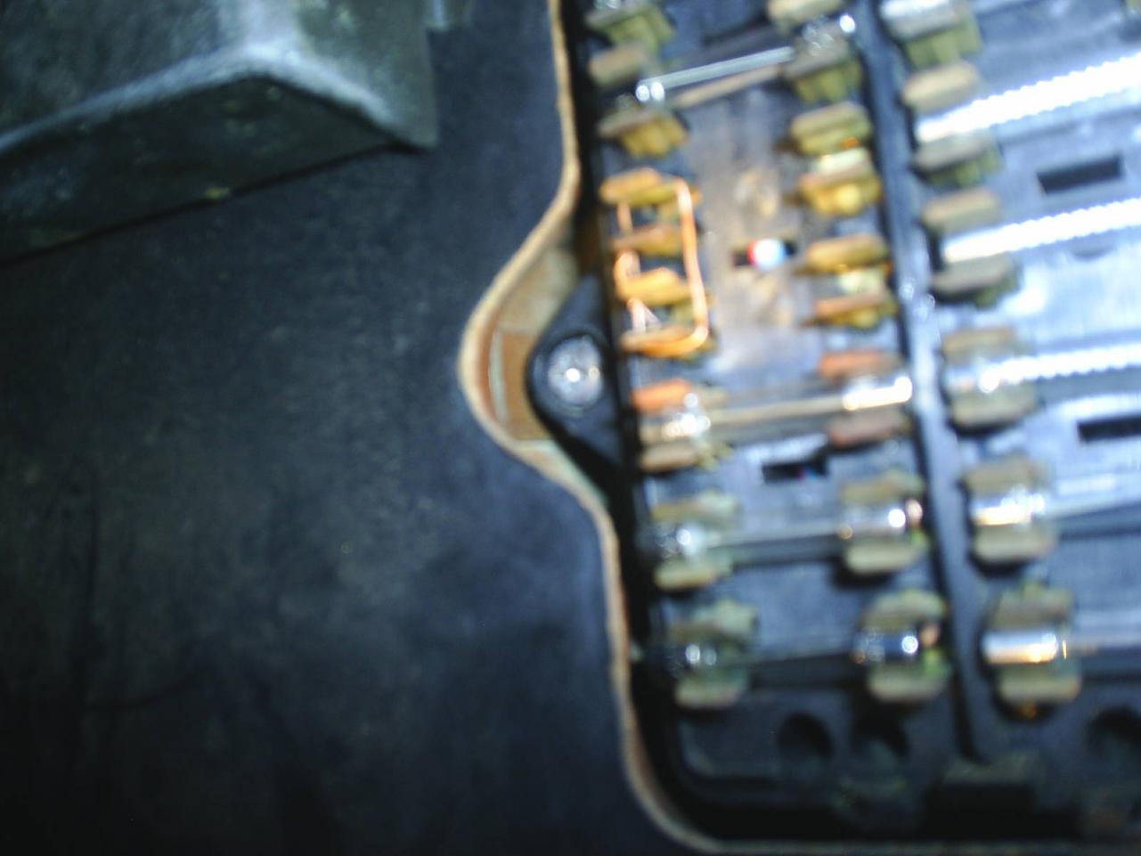

I found this thing attached to my fuse block. I'm sorry for the blurry/crappy pics. I'll take better ones tomorrow. My little digital cam sucks, and I didn't feel like lugging the Nikon D40 down stairs. Anyway, what is that? It looks like a piece of copper wire. It's not connected to anything, just makes a loop. It's sort of twisty-tied to itself.

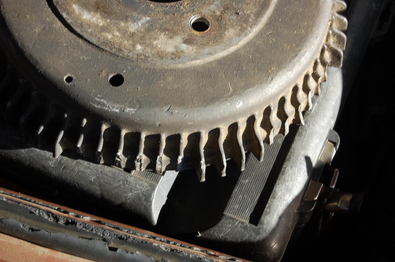

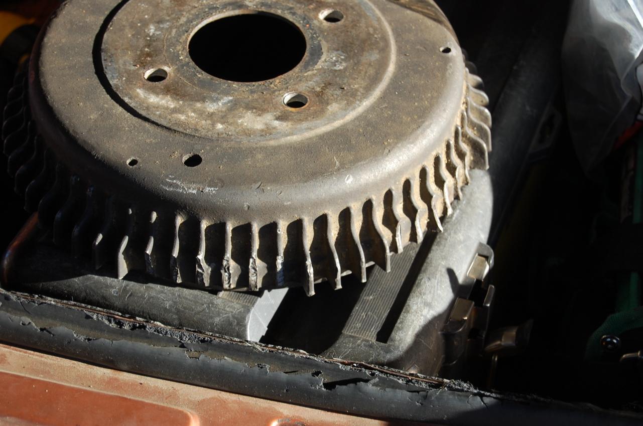

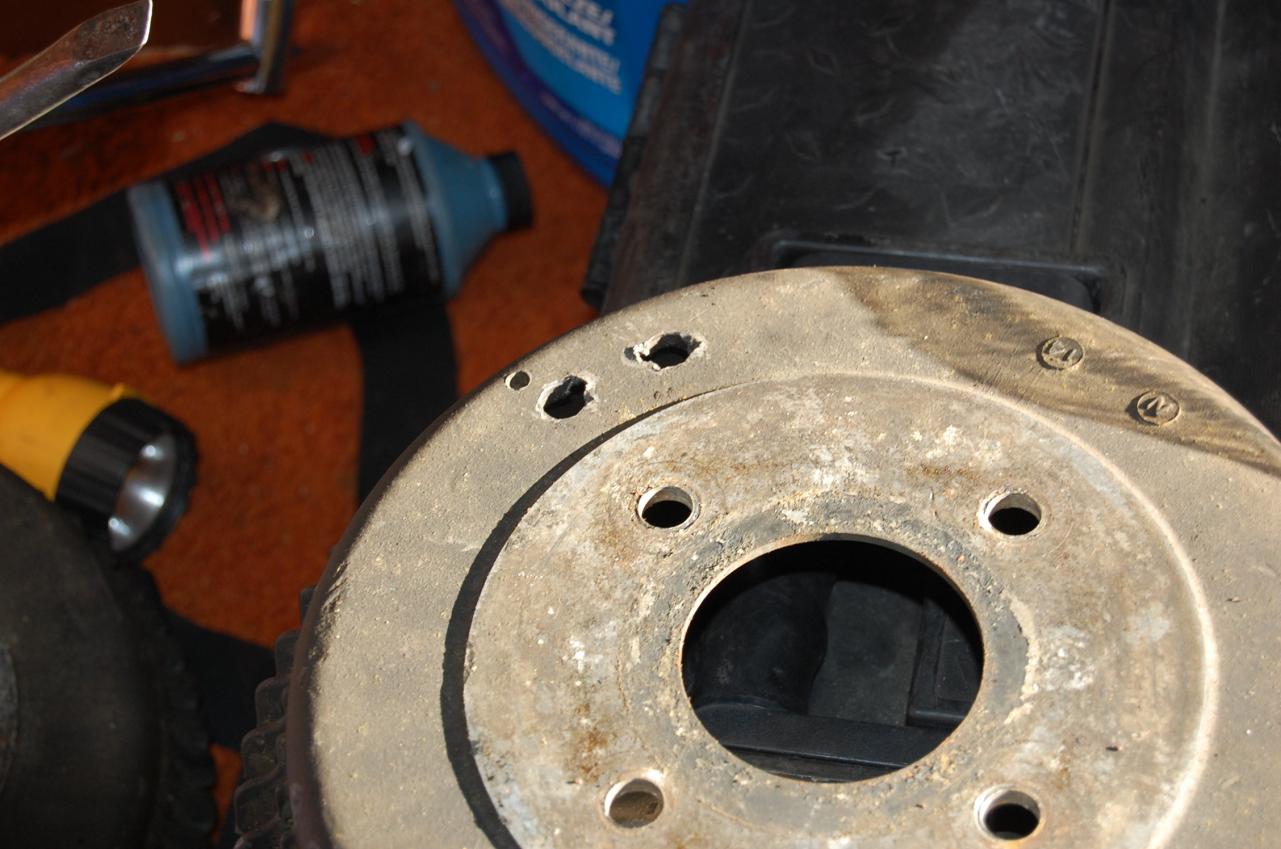

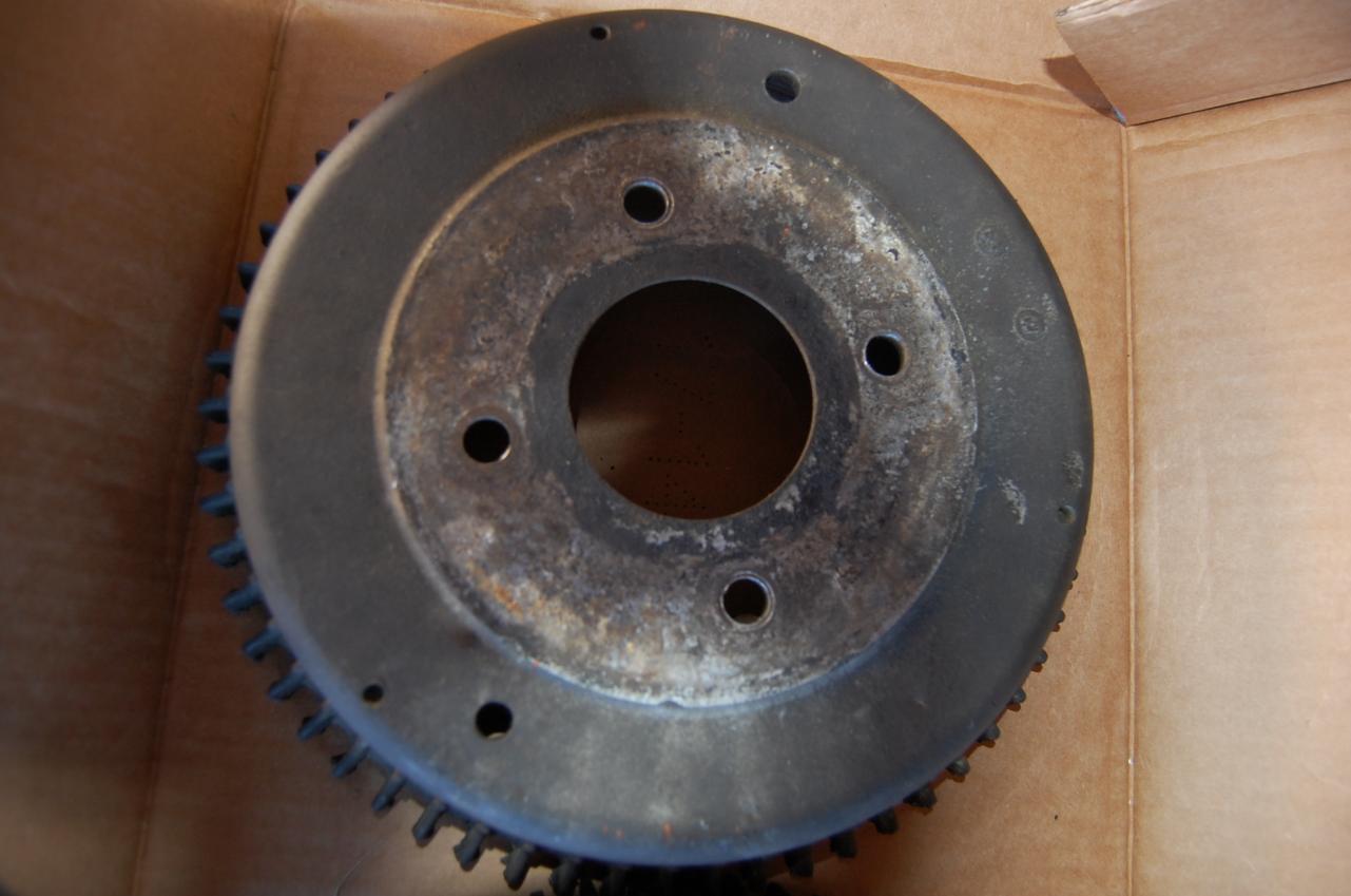

And now for those drums. As promised, here's the pics of them. I don't know what he was doing or what he was thinking when he did this but you can see from the pics the damage done to the drum. The damage is to the Drivers side drum. It has several "teeth" broken off and two holes that were drilled into it, right next to each other. The passenger side just looks like it was drilled into a few times.
Far as I can tell, replacing the drums/shoes has solved the brake issue. They no longer seem to be frozen. I still have the volt gauge charge light on, and the e-brake light is on. I even when the car is completely turned off and key is out... both lights stay on...I'm thinking maybe a relay switch somewhere? Have to look at that tomorrow after I replace the CSC.
Edited by Sparx Macgyver
I thing Geezer is correct. I had one of mine lockup and a "mechanic" had to break off the arm to free up the star wheel to get the drum off. I never fixed it and its been like that since 1978. Soon, I will have to fix that now that I am trying to revive the car.
