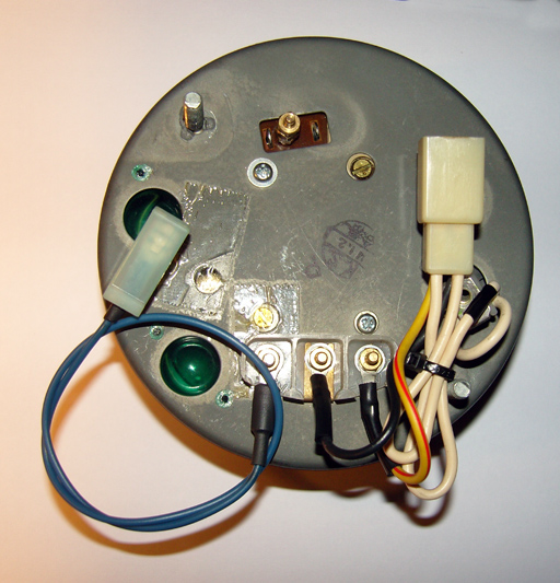

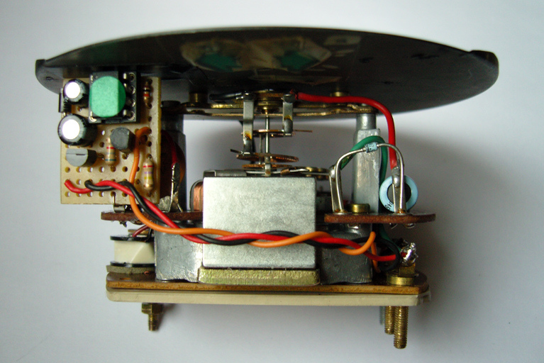

Converting a four wire tacho (current driven) to an electronic tacho
As part of my switch to a Megajolt ignition i build a small electronic circuit to convert the "four wire" current driven Datsun tacho in my '72 240Z into an electronic tacho, which can directly be connected to the tacho output of the Megajolt, MSD, Bosch, Crane or other electronic ignition.
Quite surprisingly, the 38 year old tacho was very precise after a calibration, with the highest display error below 3%.
You'll find a complete description including the wiring diagram, pcb files and images here:
http://www.dinoplex.org/tachoconversion/

I've set up a new project which contains a full replacement of the existing board. It is as simple to build as my previous conversion but is based on standard components and does not require an attiny programmer or programming software anymore.
The old project is now deprecated, the new one can be found at the same link: http://www.dinoplex.org/tachoconversion/

added picture of converted 240Z tach
