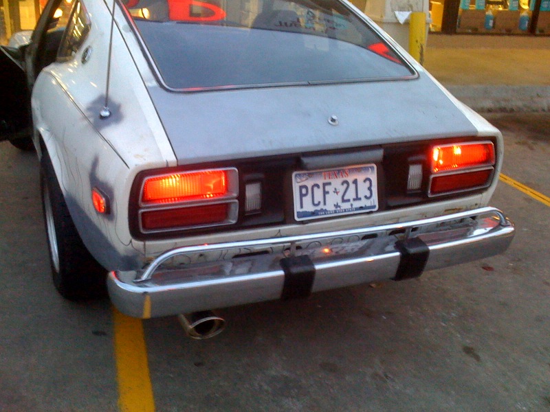

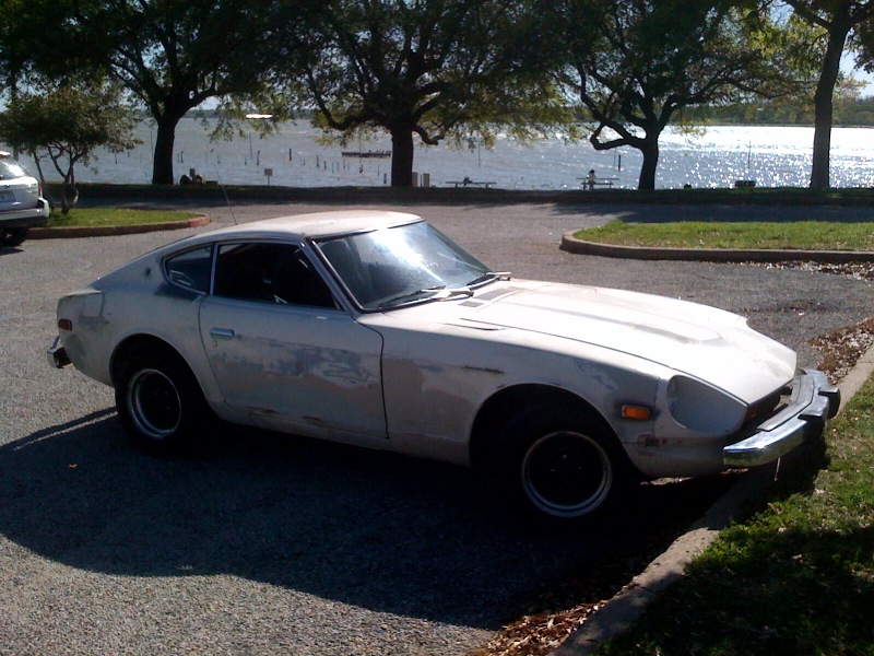

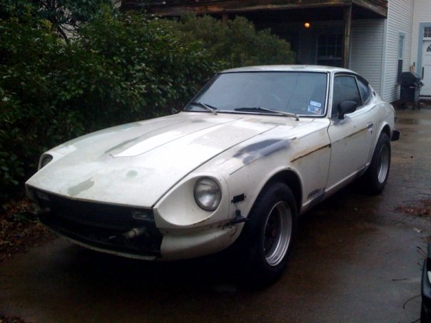

now i feel horrible about my car, and though i've thought that it was easily salvageable since i bought it, now i'm not so sure. please look at the pictures i've attached and at my flickr gallery at www.flickr.com/76280z and tell me what yall think. positive thinking would be valuable :/

Based on the pictures here, it doesn't look too bad. I guess the big things are the frame rails, support structures, and floor pans. What kind of shape are those in? Also, the rockers don't look horrible but hard to see. Is there a lot of bondo holding things together? It may be more than what they want to do but nothing looks terminal. The main thing that I have have been told is everything is fixable, it just depends on how much money you have to spend. They may be thinking a cheap fix and don't think they can get enough air time to cover the expense. Hang in there.

That's certainly going to need new metal and I'm not aware of a patch panel for that area. I'd have to see more body pictures to see what else they might be balking at. A typical insurance work body shop simply doesn't do that sort of thing so they may be doing you a favor - they're probably not qualified. From the rest of your pictures it appears to be that you've done a lot of great work already so you shouldn't get discouraged. I'd find a shop that specializes in restorations and make sure it's done right - even if you can't trade air time for it.
These rust repair jobs are hard to make any money at. Most shops wont touch them. Way too much time involved for the dollars the average owner is willing to spend. Seeing that one shot of the inner fender by the headlight, if the rest of the areas that we can't see is the same, then grab your check book and hang on......
that spot behind the headlight bucket is the worst of it that i can find. that rust extends two inches into the engine bay. the other side is much better, the hole only being maybe 4 inches long. the driver's side floor pan has surface rust from having water sit in it recently, and the passenger side has a couple of rust holes just forward of the seat that are less than a cm in diameter. the rails look good. i spent a lot of time with them during the engine bay restore, and i'm pretty sure they're solid all the way down the car.
the only bondo on the car is what you can see on the outside. the interior hasn't been touched. most of the bondo is on the front right fender and the right door. there's some bubbling at the lower rear right fender. the guy at the shop said that the right quarter window would have to go, which surprised me, but he said it's got rust on it, for what that's worth.
i know that these shops need to make money and they won't make it on this car, but i wish they hadn't taken the car and strung me along for a day, thinking they'd do it and then renege. i just wasn't sure if they just didn't want to waste their time on me, or if the car really is as bad as they say. also keep in mind, the guy there didn't get much of a better look at it than yall are getting. as far as i know, he basically stood back and eyeballed it.
Well, I'd say that they are being fairly up front and ethical about it. No way any decent body-paint shop or person wants to paint over someone else's filler work, especially filler that has not been sealed to keep moisture out of it. No good can come of that. From their perspective, to do a decent job that they can be reasonably certain will hold up, all the exposed filler needs to be re-done. And that's way more work than they are willing to trade for advertising, that's all.
