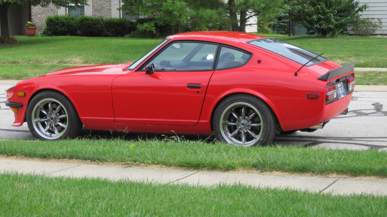

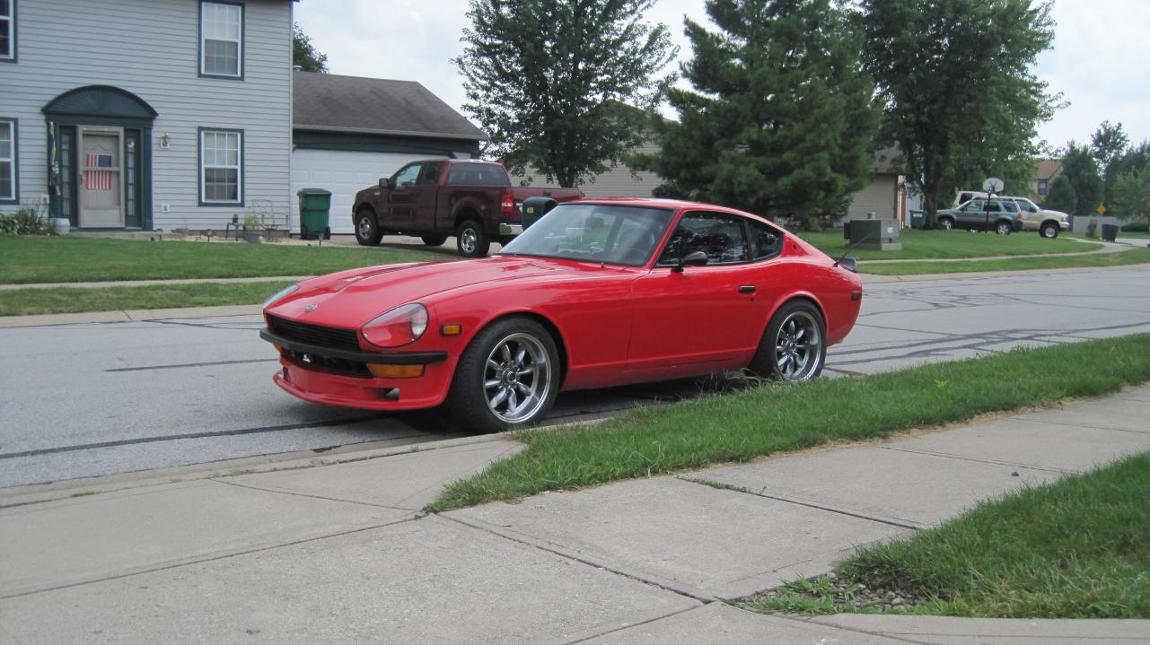

Well guys I was sweating it for the whole trip, but she made it with flying colors.The last few days were hairy since I was fretting over a noise in the rear, but the noise never got worse or any better during the trip. I also had a SU problem with the front cylinders running rich, so I decided to adjust the float-well that almost became a disaster. It seemed to get worse, but somehow straightened itself out at the last second.
I was supposed to join up with the Indy z club and come down with them, but I missed the connection by about 5 minutes. It took me about 75 miles to catch up to them, but I finally did-and I felt better traveling in a group incase something went wrong with the car. The pace was faster then I wanted with an untested car, but my car does like to cruise at highway speed. We must have averaged 75mph, which was about 85mph on my speedo. Good thing about that was I couldn't here that damn diff noise.
What was really cool was that I made it all the way on 1 tank of gas. My odometer showed close to 350 miles, which is a little inaccurate because of the speedo being off, but it is pretty close since mapquest showed this to be a 300 mile trip(and I started with about 40 miles on that tank).I didn't fill up to check mileage because I didn't want all that weight, but I must have got +25mpg minimum. That BWt-5 with overdrive is great. I will check the mileage on the trip home.
Everyone is great and this is a lot of fun. Going to the track tomorrow-to watch-I'm not ready for prime time yet. My rear tires bottom out in the wheel well so I guess it's ZG time. If I hadn't got greedy with tire size(245/17/45) and went with maybe 235's I might have cleared. You can't hardly see on the tire where it rubbs, but in an autocross style race it might be worse.
I hope everyone shares the luck I've had in making it here-and back home. I will post some pictures soon.
