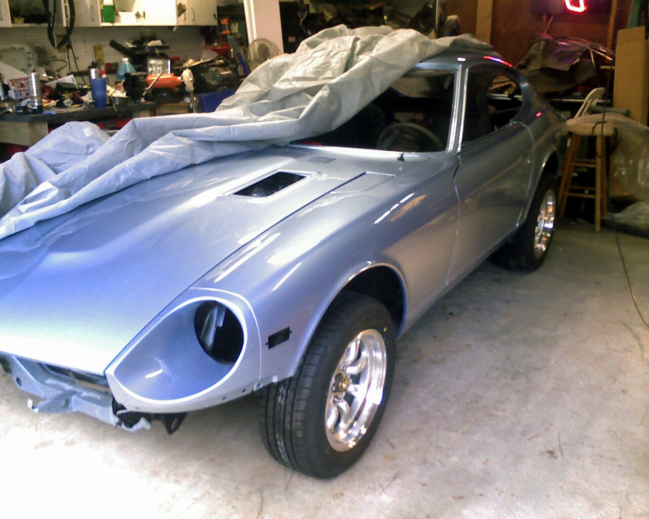

ZCurves Posted January 25, 2010 Author Share #30 Posted January 25, 2010 Update - Here is a slightly blurry pic of my Konig Rewinds on the car. They are 205-60-R15 with Yoko Avid TRZ's. I will post a better pic later. Thanks again for everyones input. Link to comment https://www.classiczcars.com/topic/34438-opinions-please/?page=3#findComment-307446 Share on other sites More sharing options...
