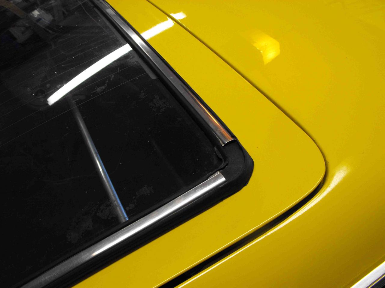

The tool is really very simple and I actually believe it is not even needed. The picture is self explanatory. It is just slightly wider than the stainless strips, holds the “lips” in an open position and allows the trim to fall into place. The tool doesn’t come into contact with the bright surface at all. If the rubber has been sufficiently heated and lubricated, it can be installed easy enough with only a blunt fiber stick. The corners of the trim are the most difficult to finesse but still only as difficult as the flexibility of the rubber makes it.

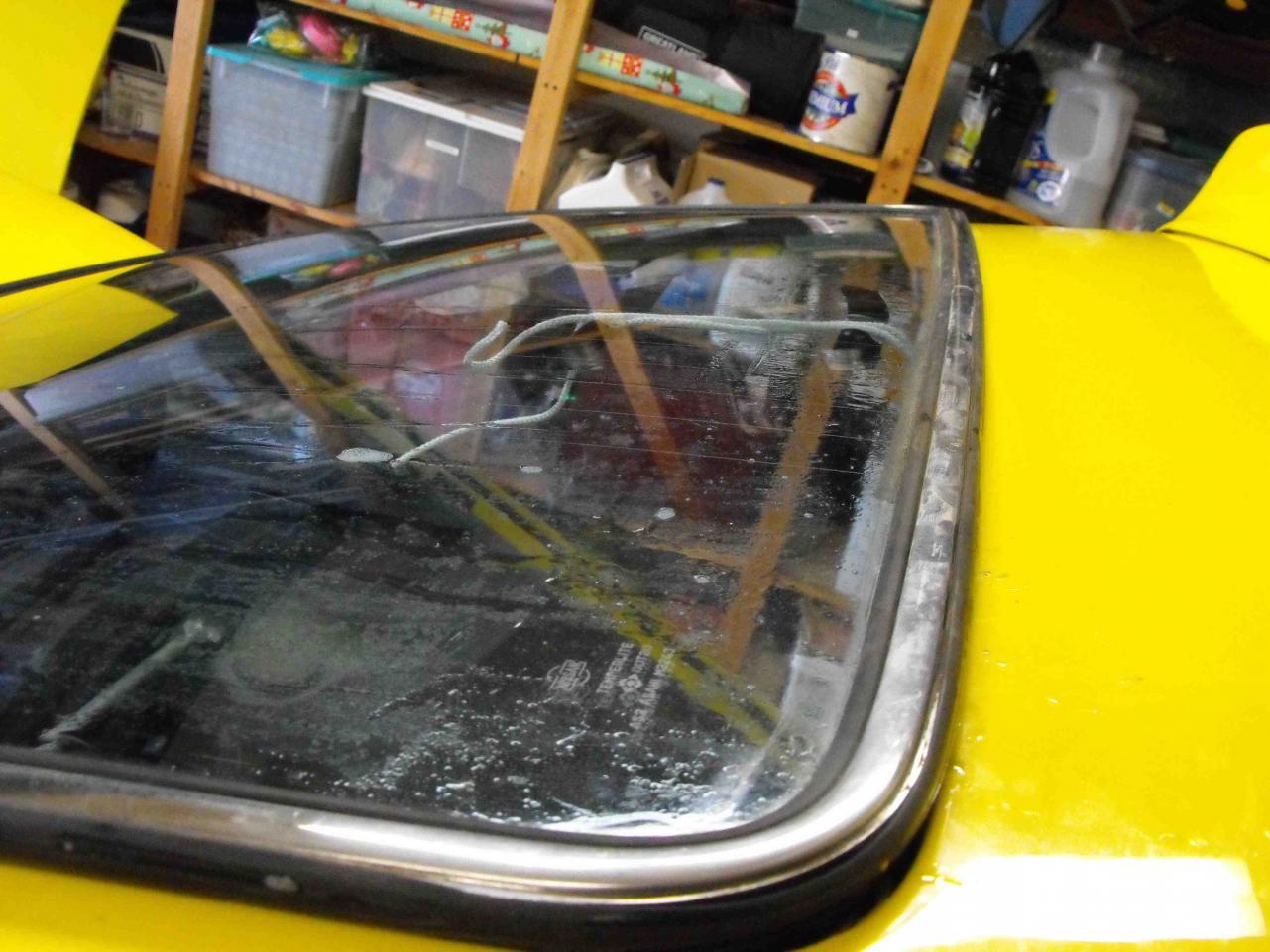

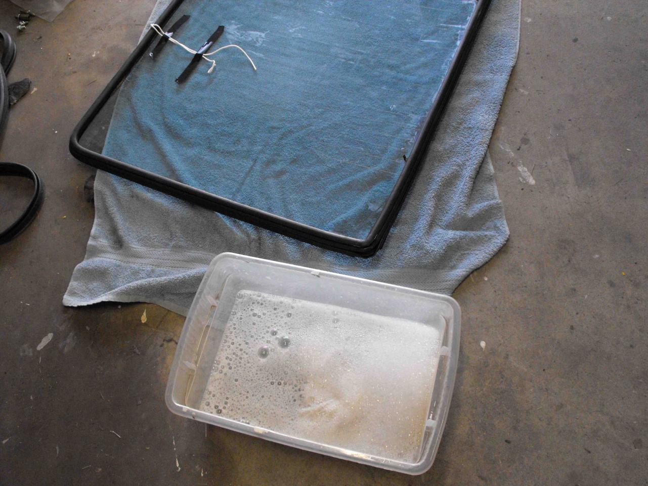

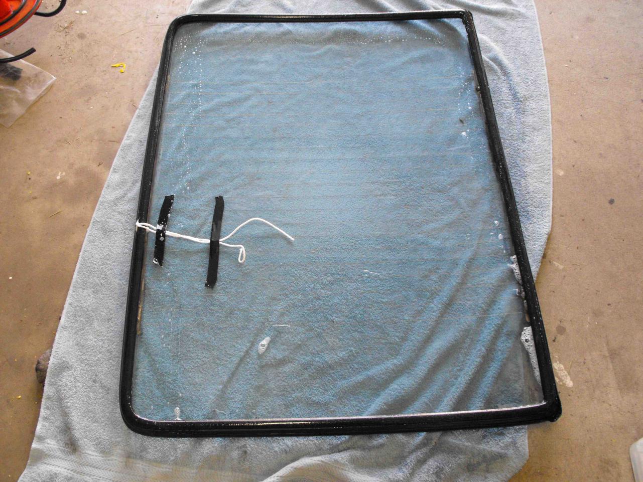

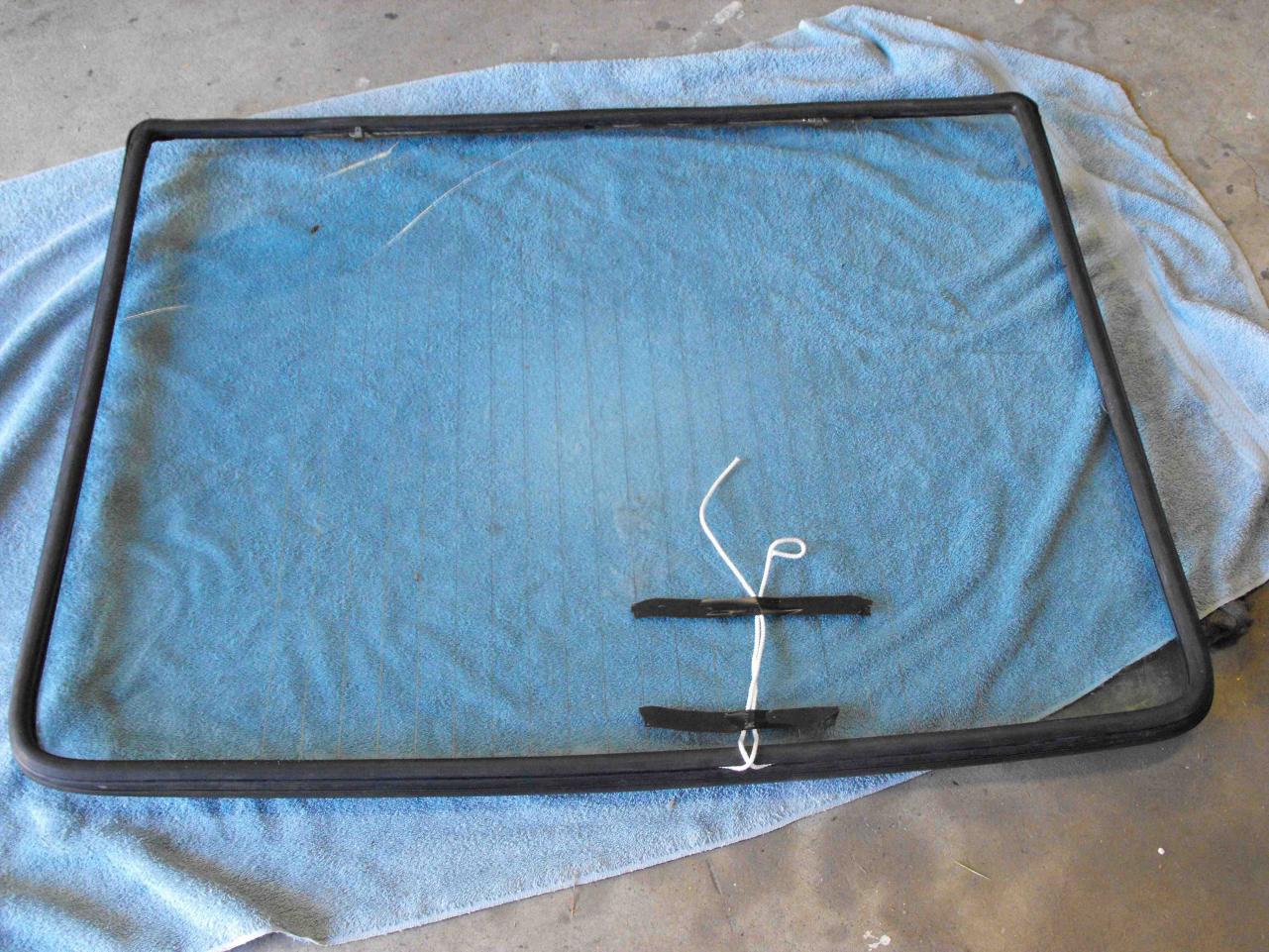

I started off with the rear hatch glass, because I felt that would be good to practice on. I put the rubber around the glass and put in the metal trim except for the corners. I figured I would put those on after the install. Everything fit well at this point. I then inserted the cord into the groove, all the way around. I overlapped the ends by about six inches. I taped the ends to the inside of the glass.

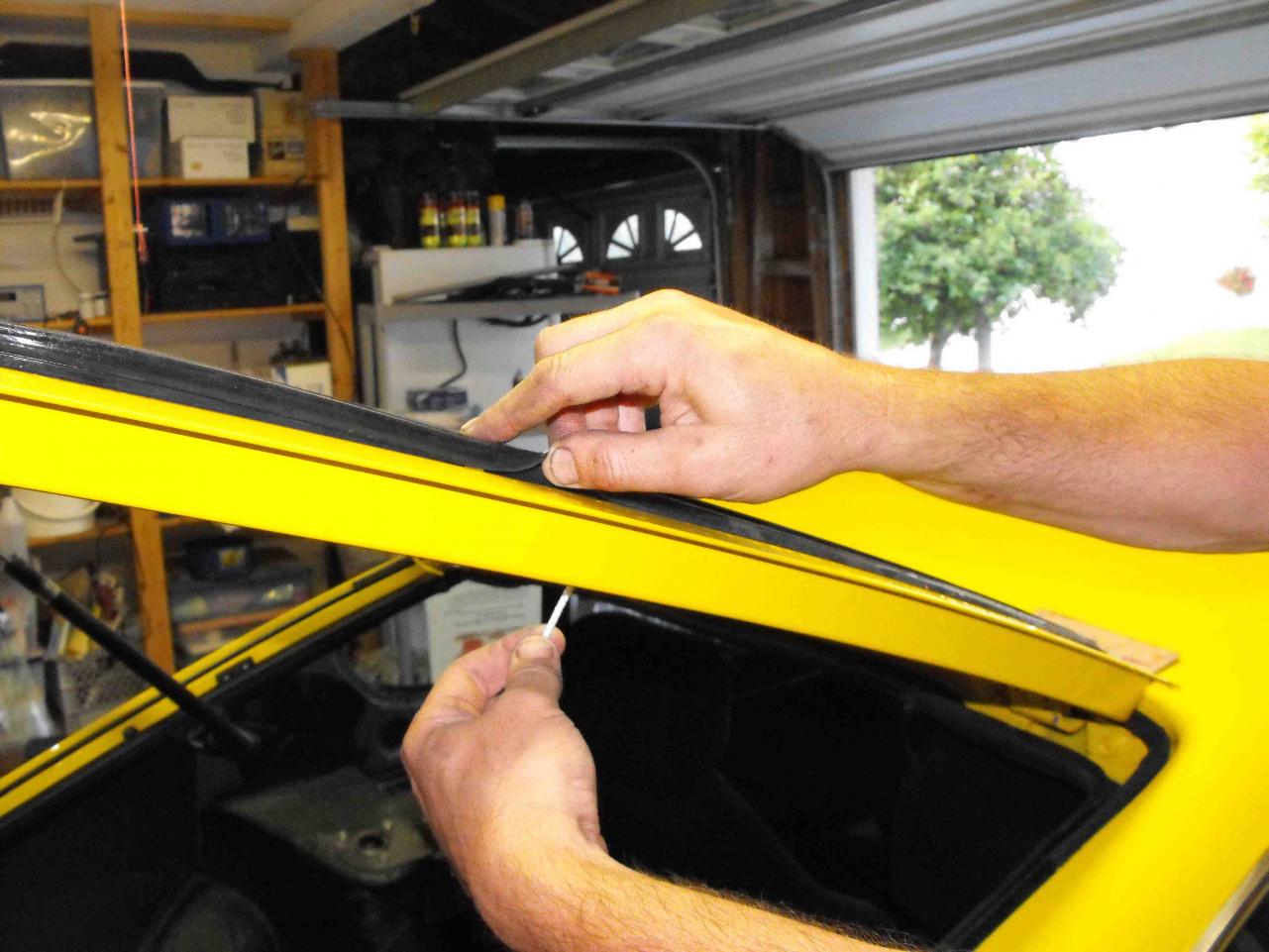

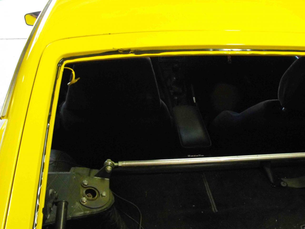

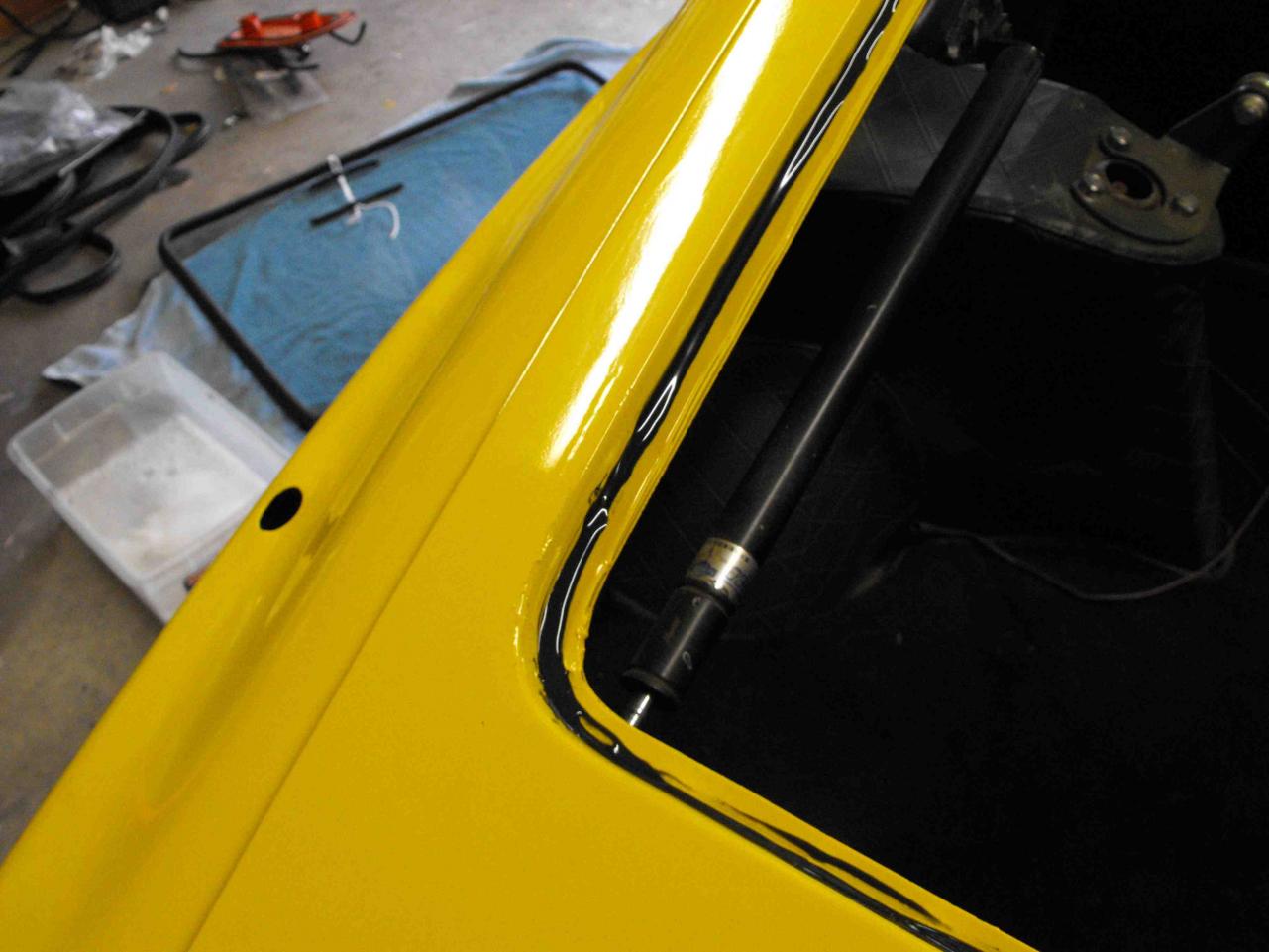

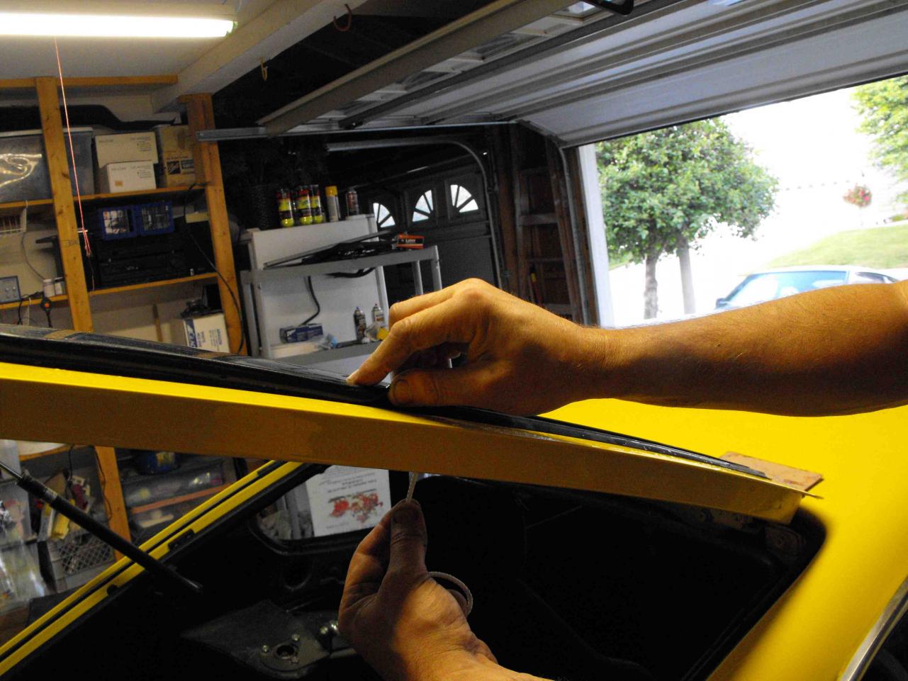

Next, I put the sealant in the hatch groove as shown in the pics.I then made a tub of warm soapy water (dish soap) and soaked the rubber and glass edge with a rag. I then placed the soaped window and rubber onto the hatch.

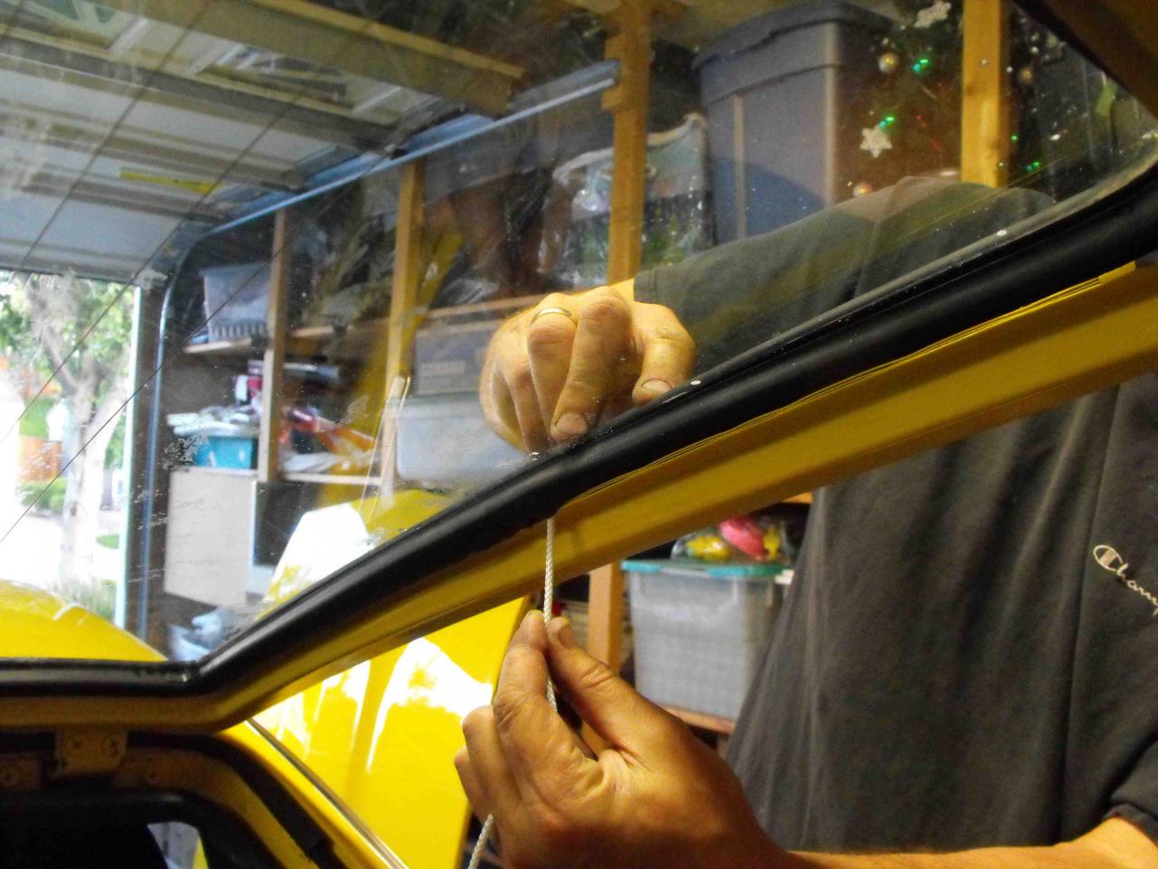

This is where things got tricky. I undid the rope on the inside and started pulling it along so that the inner lip would move over the pinchweld. This part on the inside was easy. The problem was getting the outside flap out of the groove and onto the flat portion of the hatch. The rubber flap wanted to fold over and stay in the groove where the sealant was. I had to try and lift it out of there and get it to lay flat on the flat portion of the hatch (hopefully that makes sense). Anyway, This did not work well. I would get 6" done, then lose 2"; 2" done then lose 5". After a frustrating 15 minutes of getting nowhere, I took out the metal trim.
With the trim out, things were way easier. I slid my thumb along the top edge to get the flap onto the body while pulling the string underneath. ( I could not do this with the trim in because it made the rubber too stiff) This worked just like a zipper and went pretty fast. After I was about half way around, the glass settled into place. The rest of the install was easy, I just zipped it in.
The front windshield was the exact same process, no trim. The only difference was that I started at the bottom middle, moving towards the drivers side, and once I was half way around (at the top middle), it got a difficult to do my zipper technique. So I went back to the bottom middle and pulled the cord and zippered along the passenger side and then up. This went very smooth. Once I moved past the lower passenger corner, the windshield settled into place. The rest zipped easy. Once I was finished, my daughter cleaned the glass.
