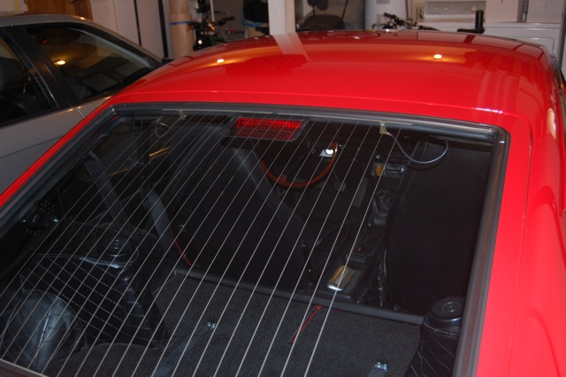

I installed the third brake light I got from Dave today. But I did make a small change in mine. In an effort to make the installed light less obvious when it is not lit up, I added a red lens in front of the LEDs, and also extended the top cover to ensure that the LEDs can't be seen behind the lens from above.
The red lens over red LEDs does not change the brightness noticeably, but actually tends to widen the angle a view some, which can't be bad.
I like how it turned out, the picture on the car was with flash and so it lit the red slightly, it's not this visible in most lighting conditions.

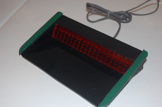

I finished my light recently.
It's a cheap  eBay  unit with LEDs and an aerodynamic design that mounts on the bootlid or hatch.  I also got a neat little electronic thing with some electronics and a 3-D accelerometer in it, that has a programmable flash pattern, and reacts to different braking.  If you brake lightly, the light will come on in the usual way, but if you brake hard, the accelerometer will sense that and the LED flashing pattern kicks in.  I mounted it on the glass with a long wire, using some rare-earth magnets, and is detachable for shows.

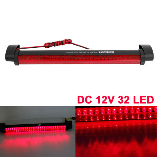

I am also awaiting my ebay third brake light (upon the advice of a member) that sticks to the rear glass.  Several sizes are available, I got the 11" 32 LED version.  I have the louvre on my hatch.  I got those "T tap" elec connectors.  the mounts swivel so you can position it.  I actually ordered 3 of them, 1 from the US for $10 so I can get it soon, and then 2 for $5 each as spares, since you cannot easily replace the bulbs.  Should be a great addition.

Cool, thanks Dennis!  I received mine today and installed it- I also ordred 2 more of the same ones from China for $5 each/free shipping as spares. The upside is they are exactly the same, downside is the shipping time could be a month.  Took me most of the evening though, lots of breaks since it's been mid 90's all month here, which is very rare this time of year in Omaha.  We have VERY hot and humid summers as well as brutally cold and snowy winters (which the Z doesn't see).
As the amazon reviews state, the mounting tape is crap.  I had to scratch off the mounting tape and use 3M emblem tape, as it fell off the window within a few minutes.  It is adjustable (loosen screws on side and rotate mounts), which is great for the angle of the Z glass.  Kind of expected this.
Ran the wire under the trim and grounded to one of the shock tower screws.  Had to add wire length to both wires, as they're like 22".  Not long enough.  The wire is very thin, smaller gauge than anything my hardware store had.  Used butt connectors/elec tape and used wire strippers to "clamp" them good.
My Chilton manual wasn't accurate on the wiring:  I had a 50/50 shot of getting the brake wire right:  a green with white stripe and a green with yellow stripe (and obviously the black ground).  I guessed wrong.  The brake wire is the Green with yellow stripe for an early 1976 280z (build date 9/75).  I used those "quick taps".  I like them.  Had to use pliers to snap them closed.  40 year old wiring is hard.
Lights up just as bright as the ZEVO LED's, and you can position it with louvres so it is mostly visible.  Some angles will block it, but it glows pretty nicely.  The 32 LED 11" model is about the right size for a Z.  The LEDs look good, close enough together to look stock.
Great subtle and removable addition to a Z.  As for the wiring, well I had to splice the stock brake wire, but I see it as a permanent upgrade.  And mine isn't mint original anyway.
This specific item is highly recommended by me.
