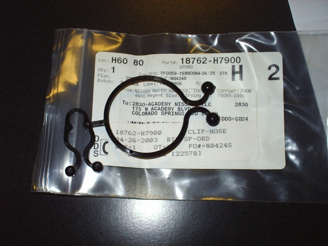

hey arne, i notices that on the braided top rad hose there's no plastic tie
that holds the temp wire in place, but in the final pic with the new rad hose that tie is present. did u find that or did u always have it. where can i get one?
I bought a replacement hose clip back in 2003 that I have in storage. The part number listed is 18762-H7900. Hope this helps.
not refering to the hose clamp. it's the black plastic (becomes brittle over time) tie that wraps around the rad hose to hold the temp sensor wire from dangling into the fan area. a zip tie will do the job but it's not period correct.
i have mine but when i replaced the temp sensor one ball on the end broke off. never though but i could have superglued it back on, now i can't find it.
Here's a photo of the part I was referring to.
Reference from post #17 above picture didn't copy to quote
Kats website shows you the difference between the new ones and the old wire support their is a difference. I could not find the picture today but this is a great site I learn a lot looking thru the restorations. What you have it the later one, but if your not too picky it works great.
