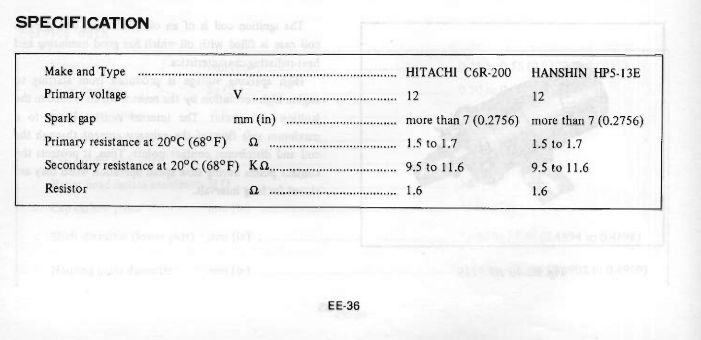

How hot should the petronix 1.5 coil get during idle? Mine is so hot you cannot leave your hand for more than 2 seconds. Is this normal?
Is it being used with a Pertronix Ignitor?  What are the details of the whole ignition system?  Coils should not get that hot.
Have you checked resistance through the ballast resistor?  Its purpose is to reduce the current through the coil so that it doesn't get too hot.
Disconnect it and measure resistance from one terminal to the other.  It should be 1.6 ohms.  Maybe somebody shorted the terminals and it's not correct.  Buena suerte!     (Thank you Google Translate).
