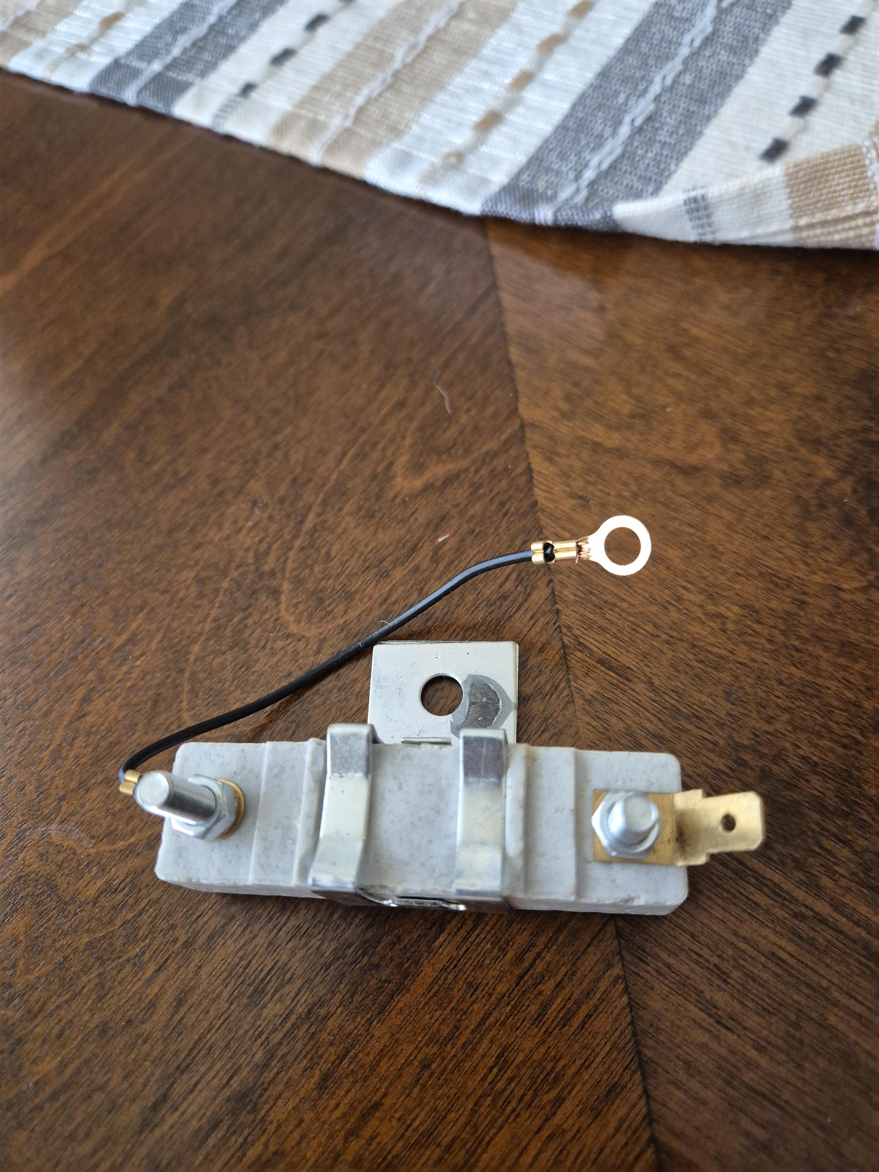

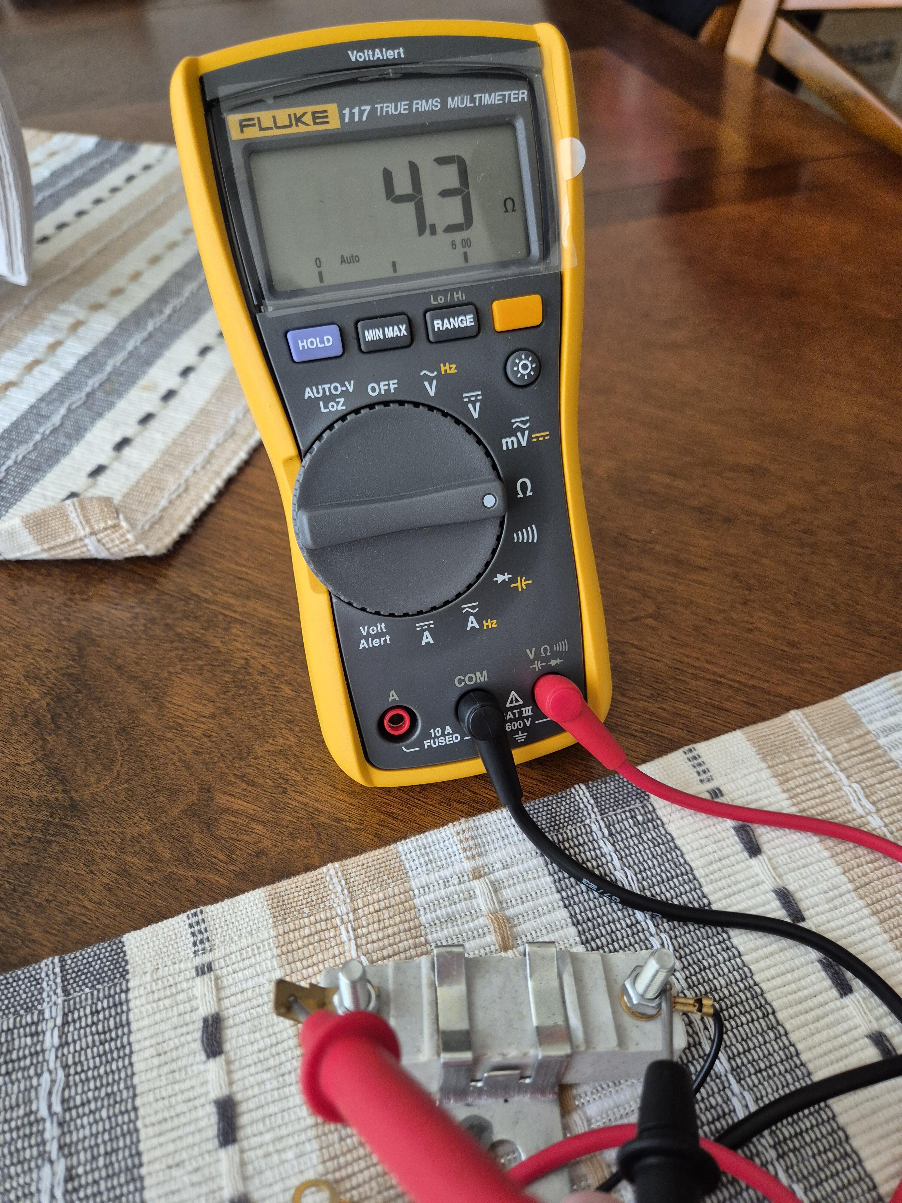

Just checked the resistance of a ballast resistor i bought 3 years ago stored in my house. I bought this ceramic resistor from amazon. Guess they send me a wrong one and this value wont work with my 1.5 ohm petronix flamethrower coil. Isnt it supposed to measure 1.5 - 1.6 ohms?
