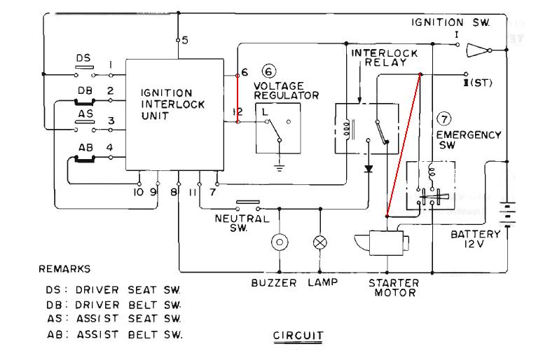

Here is a picture from the FSM (along with my suggestion on how to jumper it out once it's disconnected). The neutral switch completes a circuit to the ignition interlock unit if the transmission is in neutral, a seat is occupied without the seatbelt in use, and the key is in the run position. This will light the seatbelt warning light and sound the buzzer. (Note: the drawing shows a normally open switch, and that's how I described the operation. However, it doesn't make sense to me. I would think it should be a normally closed switch, so if the car is in gear, the buzzer & light would be present.)
The interlock was the idea of the brilliant bureaucrats in the federal government. (Disclaimer: At one time I was a bureaucrat, but I was disgusted by the thought of wasting the taxpayers' money, so I got a real job.) If someone set a bag of groceries down in the passenger seat, the car would not start unless the bag was securely buckled in. Of course, I do not advocate utilizing the passenger seat (or driver seat) for grocery storage during transit, but the system just didn't work that well. Many people just left their seatbelts buckled all of the time to reduce the headaches.
