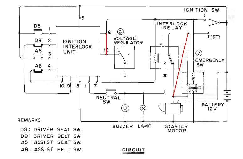

From looking at pages EE-13 and BE-91 in the FSM, I think the red lines in the attached picture show what should be jumpered out to bypass the interlocks. Dave, feel free to correct me.

The black thing in your picture is your seat belt interlock relay. The other thing is your fusible links - the cover just pops off. When you took the seats out, did you notice some wires plugged into the seats on the floor? There is a pressure sensor on the bottom of the seats that plug into those wires. I wonder if that is what is stopping you? I just unplugged them the 1st day I owned my Z and they never presented a problem afterward.
There should be a red push button thing that was mounted on the firewall that was supposed to be an override. Worked sometimes. Its mounted between the battery and the strut tower.
