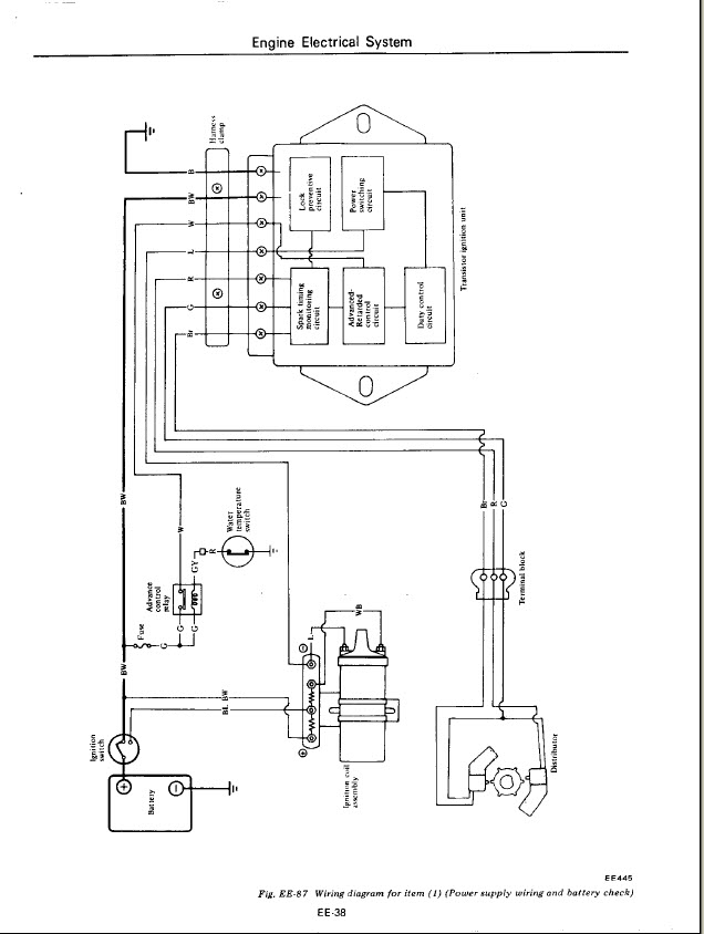

- I have the complete 1976 wiring diagram (76circuit.pdf). If I trace Pin 1 from ECU, it goes to:
White Cable -> Blue -> C4 Block -> Black with Blue (BL) -> Ignition Switch BL
I don't see how pin 1 connects to the - (negative) on the coil?
Doesn't the negative come to the ballast resistor (and coil) from the ignition transistor unit which sends pulses (see attached picture)?
Here is the diagram (sorry about the size, it is 10MB):

- I have 12.2V at the coil (+) terminal when the ignition switch is in 'ON' position (good news). I guess no need to run a direct (+) battery wire to the coil's one.
- When the engine is cranking, I see 9.6V at the + coil post.
- The transistor's BW post shows 12.1V when the key is in 'ON'. When cranking, it shows 9.6V.
- If I remove the coil's wire to the distributor, I am getting a nice size spark.
I traced both green/red wires from the engine coil area (2 wires which also go to the distributor) back to the transistor's red/green posts. There is continuity on both.
Still no injectors' clicking noise at all.
I am wondering if the transistor is failing, time to convert it to the GM HEI module? The engine doesn't even 'cough' for the 1st time I try to start it.
