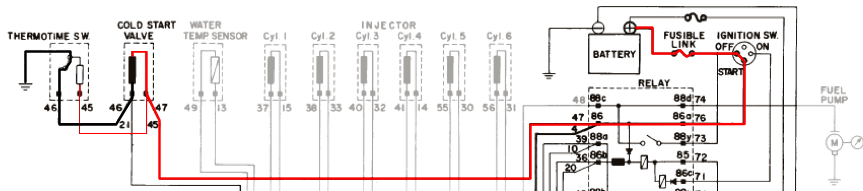

Trace and check the wire marked red in the attachment, it connects the fuel relay pin 86 to pin 47 (original CSV connector) of the CSV. I bet this connection is broken, so you need to fix it first. If the thermotime switch itself is ok, we we might be quite close to a running engine.
Excellent, thanks - I will trace the wire (my 2 fuel inj. relays are out, should be a pretty straight forward operation).
