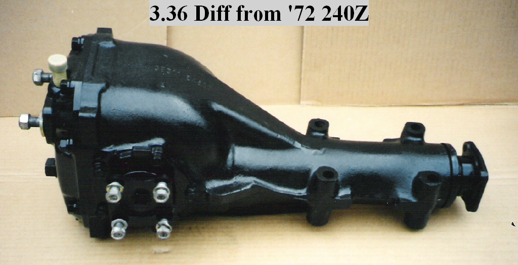

Thanks guys! :) Looks like I just need some spray cleaner and a wire brush for the worst of it. I'd like to pull the rear cover to see what gear ratio it is and just to look becuz I've never opened a differential before, so maybe I'll do the external wire brush scrub and then open it up and refill it with fresh oil and paint it so it's shiny like Kinfish's.
