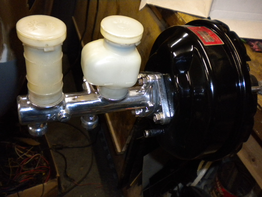

On my washer fluid bottle, I tested on an inconspicuas spot (bottom) but ended up cleaning the whole thing with brake cleaner spray. I sprayed it on a clean towel and was able to make it much cleaner. I didn't appeer to soften or hurt the plastic at all.
Your results may differ but it worked on mine.

The Resevoirs cleaned up nicely with brake cleaner and I tested the side of my bottle for the picture.
