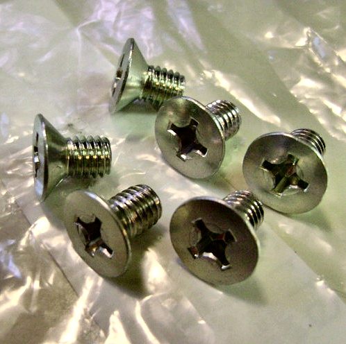

There are 2 long and 3 short counter-sunk screws that hold the dovetail and the latch mechanisim in the door... of the 3 screws that hold the mechanism, the screw closest to the car must be short or the locking mechanism will hang up on it... I found out.... slightly longer than stock ss screw caused me grief.
