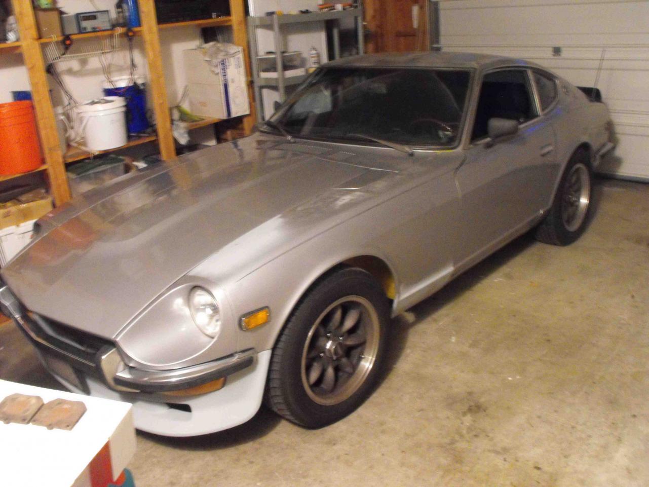

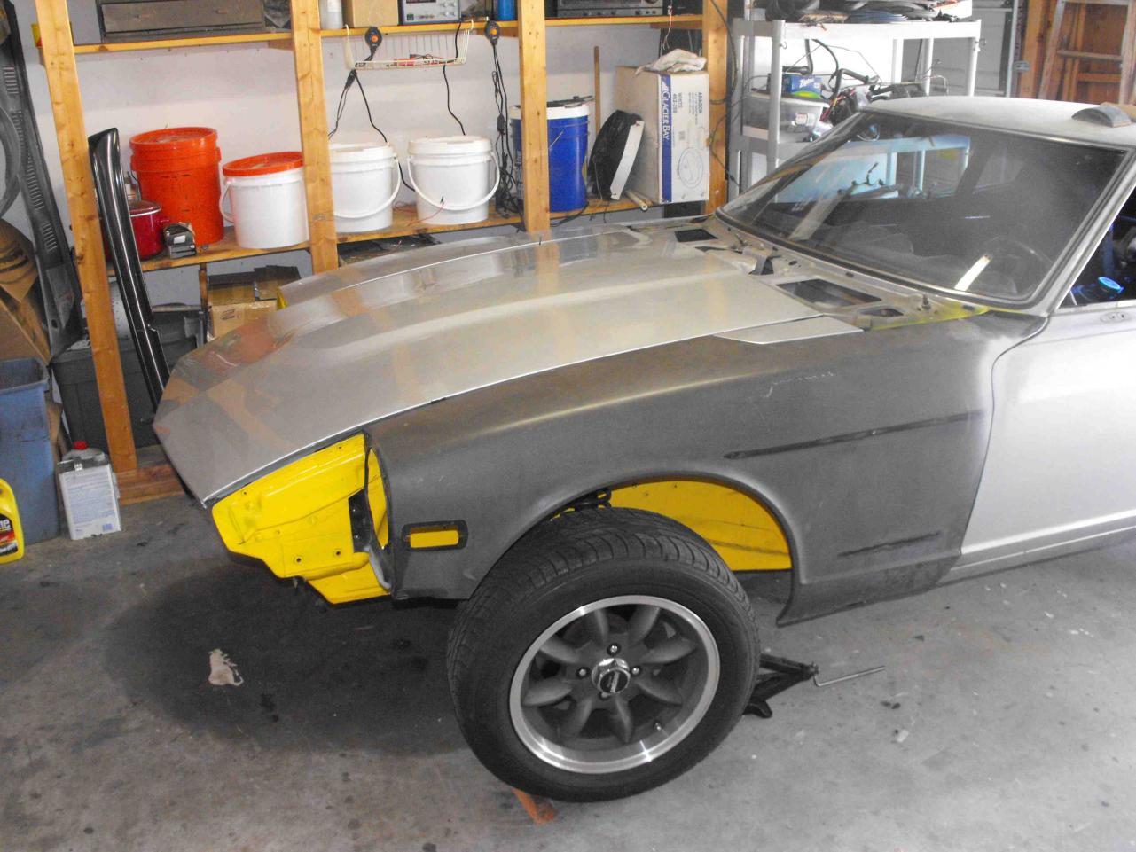

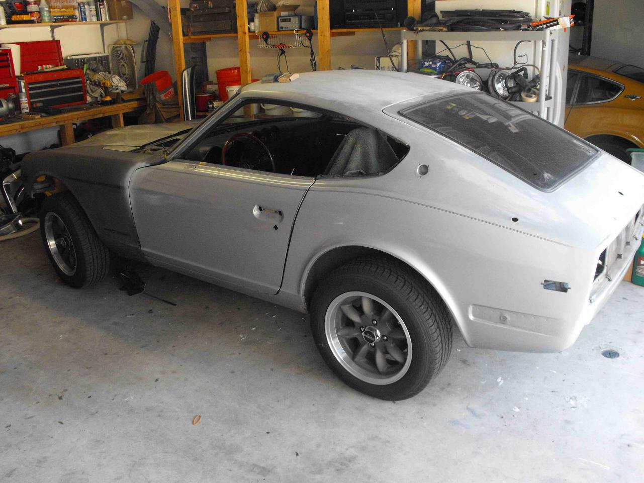

I spent most of the day stripping my silver '71 in prep for paint. I am figuring it will take about two or three weeks to get it ready ( Unfortunately that usually means four to six REAL week). I should be able to finish the part strip tomorrow (Friday) and then begin sanding and rust repair.

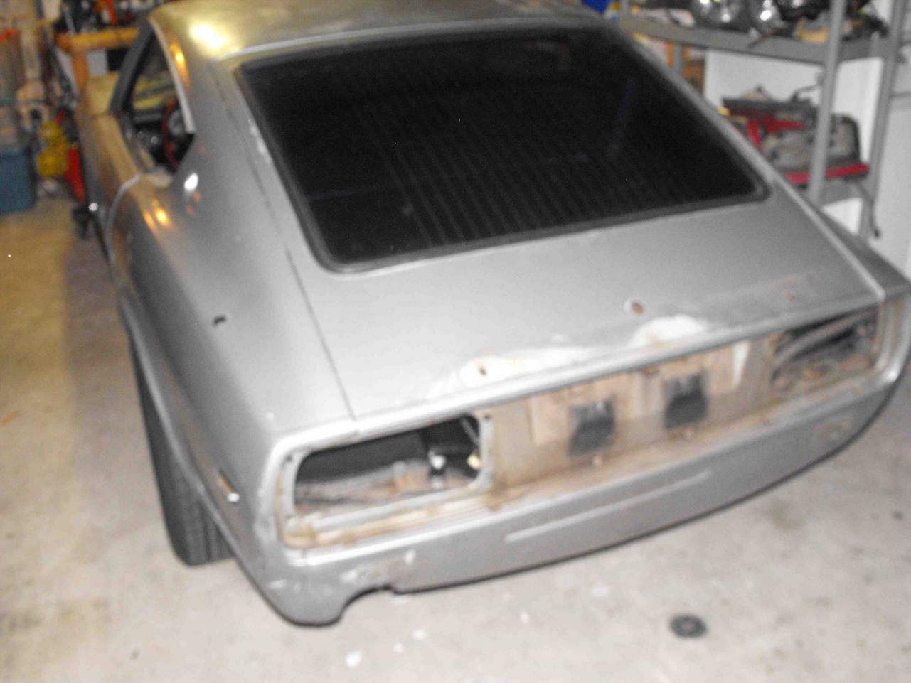

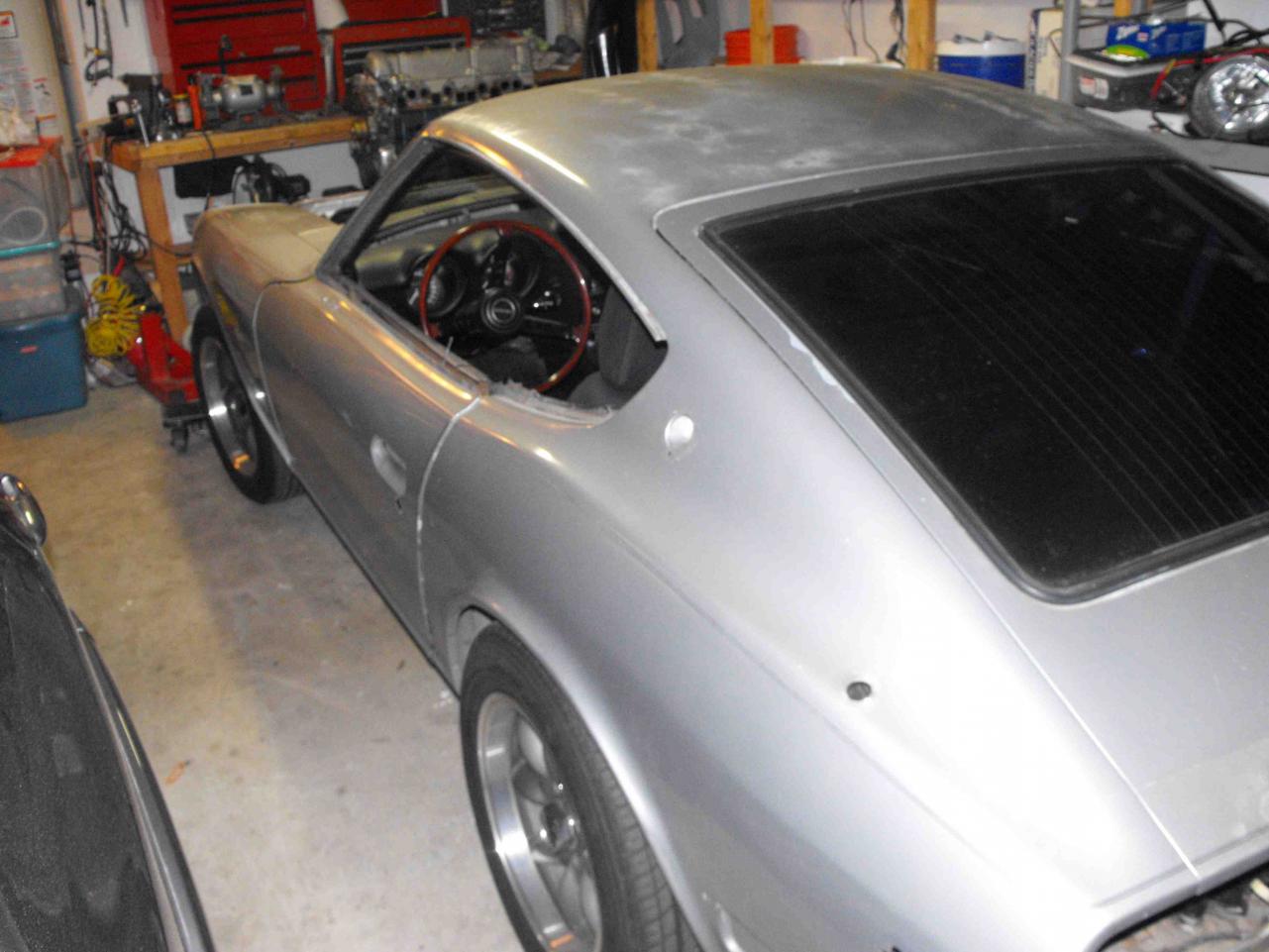

The one glitch I ran into was the front and rear glass removal. I was thinking I could get a glass company to come and remove them for me for about $40. Unfortunately, the first place I called wanted more than double that amount to remove the front and rear glass.:disappoin The second place said they don't work on old cars. So, I think I will read some of the treads here and try it myself. I think I can take the glass out, but will probably have to pay the price to have someone else install it when it's time to re-assemble.
Since the car is a "mutt" there is no need to paint it an official Z color. I was leaning toward the an original Z green, but have decided to go with a bright yellow (I was out voted). I am looking at painting it a yellow similar to the current 350Z or the PPG base yellow. I want a color that is bright and grabs attention. It should work well with the Panasports.
I am planning on doing the majority of the paint prep and then taking the Z to the paint shop. I am also planning on having Lance (jackboxxx) do the paint job up at the Maaco in Orange County.
I am hoping to get a little input here on the paint prep. I haven't had a car painted for quite some time. I am not sure that I want to take the car down to the bare metal, but I would at least like to get to the original primer at the least. Currently the car is an oxidized silver.

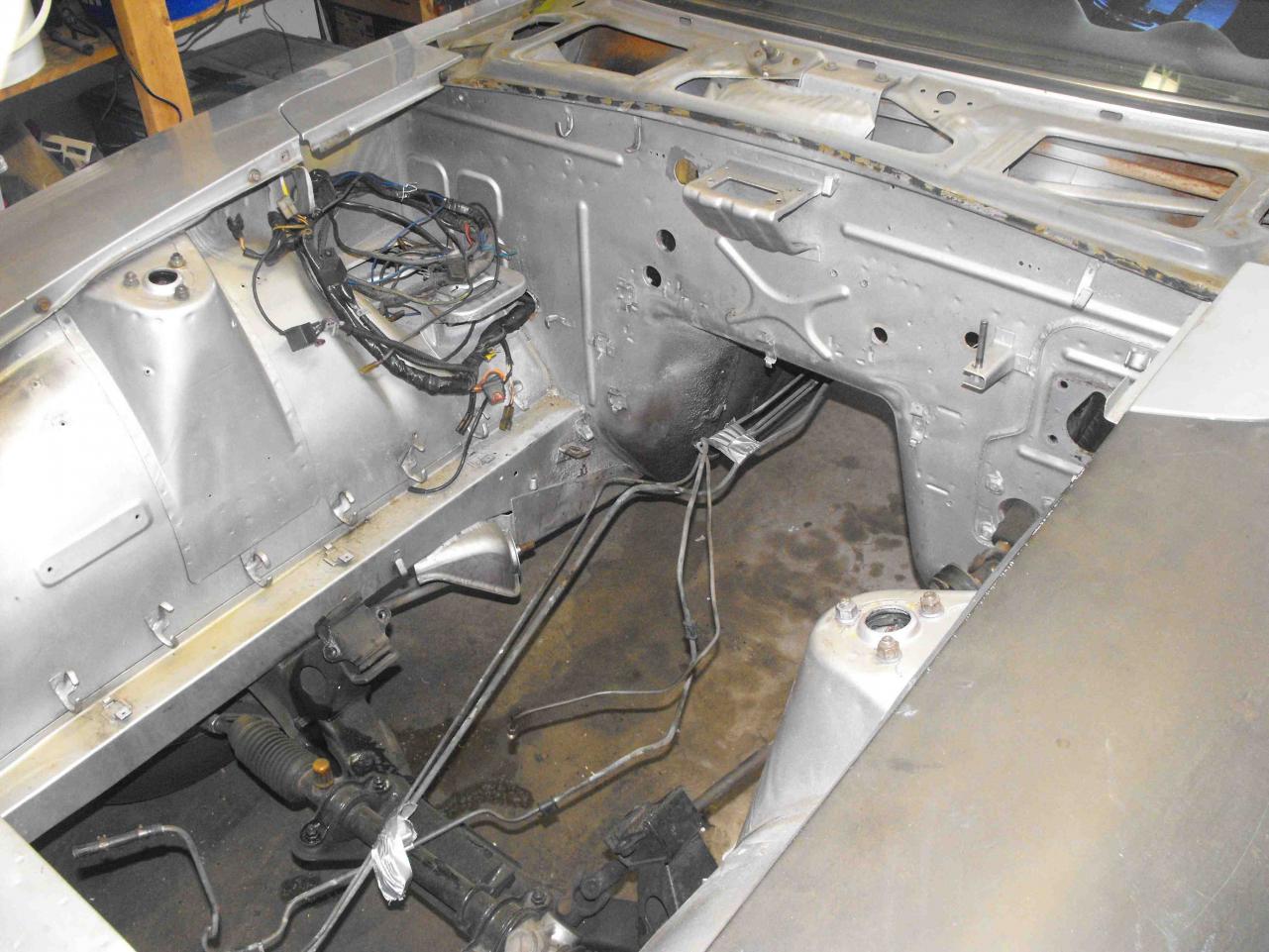

So, here are some pics of the teardown. i'll post more as the project progresses.
Rich

As for the glass, you will have to replace the gaskets anyway. On the front, using a straight blade knife/box cutter, remove the chrome trim and simply cut around the edge of the window through the gasket and take it out. Takes one guy about 5 minutes. Same with the rear window. I can't imagine you ever being able to save the gasket as it is going to be brittle. It looks to me like we are very similar in progress. I hope you can stick to your timeline, I can't even get close to mine.

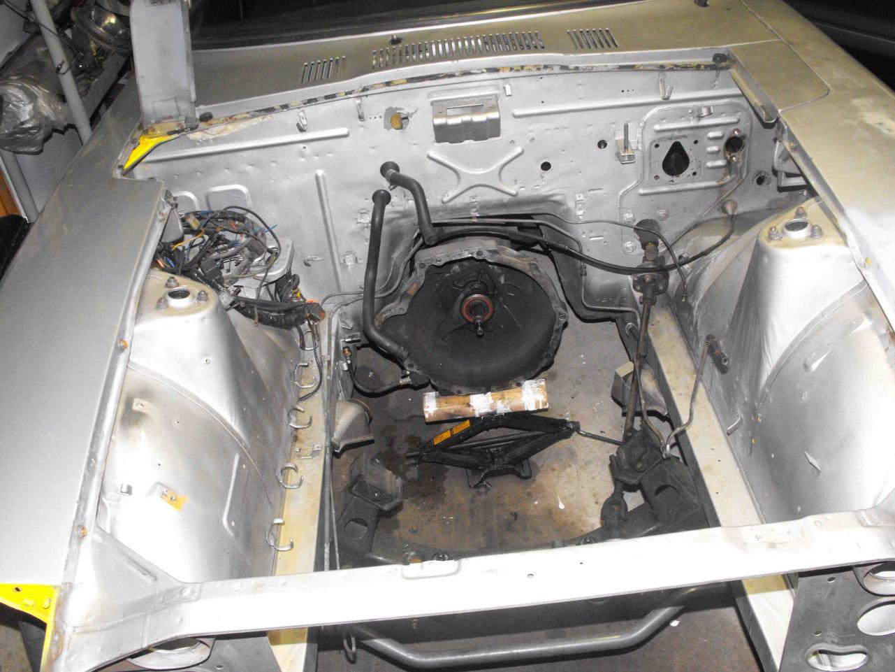

As for painting the car a different color than the original, my plan is to just have painted the areas that are typically visible. So, the door jams, hatch area and engine bay will all be painted the same yellow. One of my pet peeves is an engine bay that doesn't match the car color. Plus, only takes about half a day to pop the engine out, so might as well take it out.
I am not sure what to do with the wheel wells. I painted the front ones a yellow spray can color as you can see in the pics.and not sure I like the look. I may revert it back to the black undercoating. Will have to look at some pics and see how that looks.
Thanks for the tips on the windshield with the razor knife. The gaskets leak, so they will be replaced. No harm cutting off the old one.
I will also have the trans serviced at this time and rebuild my brake master cylinder. Also need a new booster. So, lots to do. Ah, and of course re-zinc my bolts.

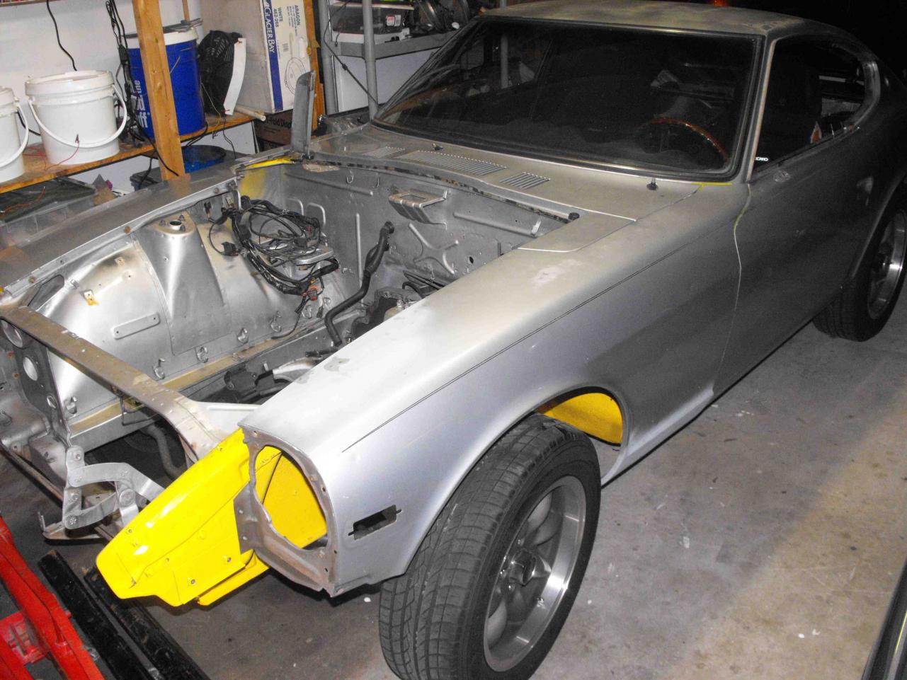

Attached are some pics of the progress today. Got the tranny pulled and the rest of the firewall stuff off. I tied some of the tubes to the center of the engine area to keep them out of the way of the painter. Also will bag and stow the harness. For now it's just resting on the battery tray. Got the left fender replaced. Massaged out a few small dings and started a bit of sanding.

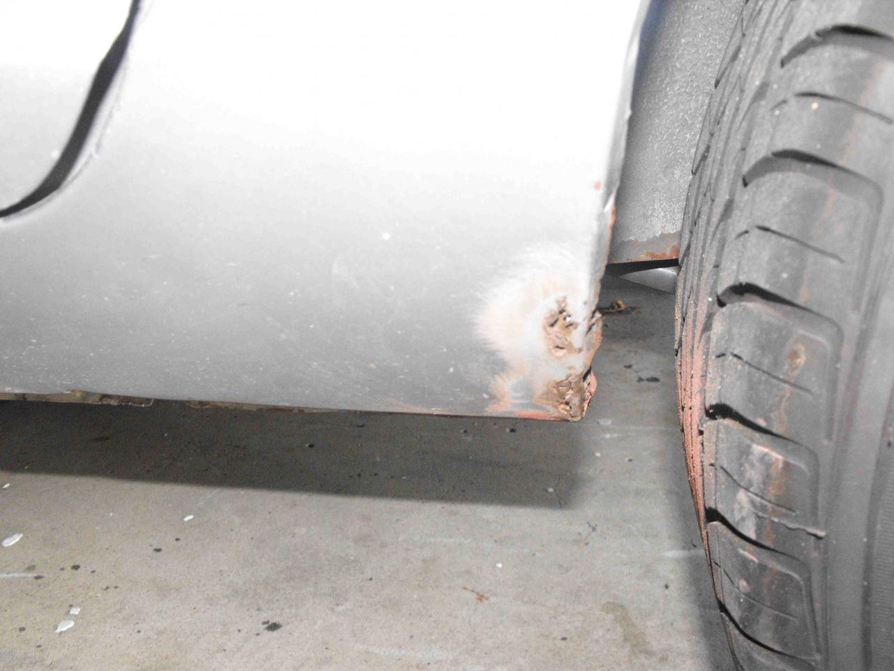

I have some rust near the doglegs. I was thinking of brazing up the hole and grinding flush.
