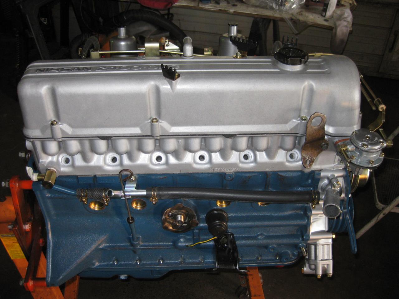

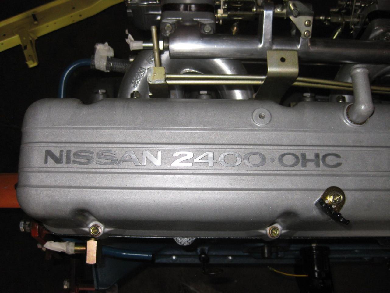

media blast it with glass beads to natural satin---detail lettering with fine grit paper---soak it with Gibbs Brand---wipe off excess
I'm not a fan of aluminum paint
I'm simple, but it suits me just fine--- :love:

I did what Zup did. I painted the block after I masked off the brass Water Jacket plugs. I kept the Head and Intake clean- brushed aluminum. I got tired of polishing the valve cover so I had it powder coated silver (I have a couple of spares in case I get motivated to go back to a polished finish). I purchased a can Stainless High-Temp paint from Eastwood and painted the exhaust manifold and heat shields with that.
P.S. If you want to remove paint, try coating it with Brake Fluid. It should peel off without messing up the aluminum finish.
