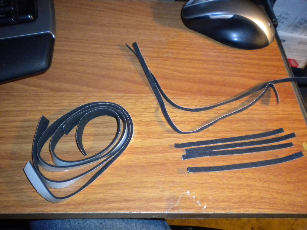

Nissan used to sell a repair kit for the "Squeek" issue. It was a bag on adhesive backed, 3/16" wide felt strips to be used where ever plastic contacted opther plastic?? I guess.
4) 4" felt strips
2) 12" felt strips
2) 18" 1/16" thick closed cell foam strips (10mm wide)
I don't have a part number but here's a picture of the contents....
