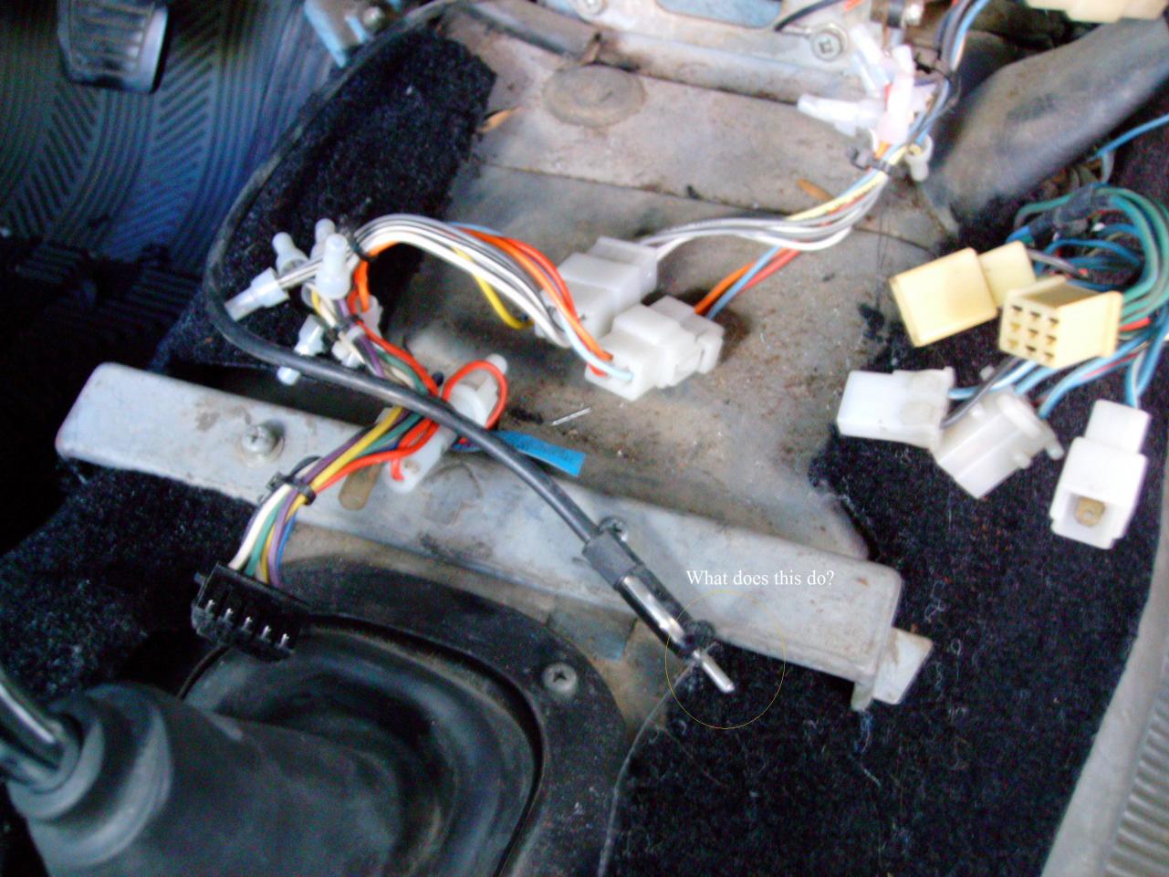

Decided this weekend was a great time to pull out the center consul and see what is under it. Found two things that caught my eye. First off there is a weird wire that comes from the firewall area to the where the radio is (first pic). Can someone please tell me what this does and where it should be connected?

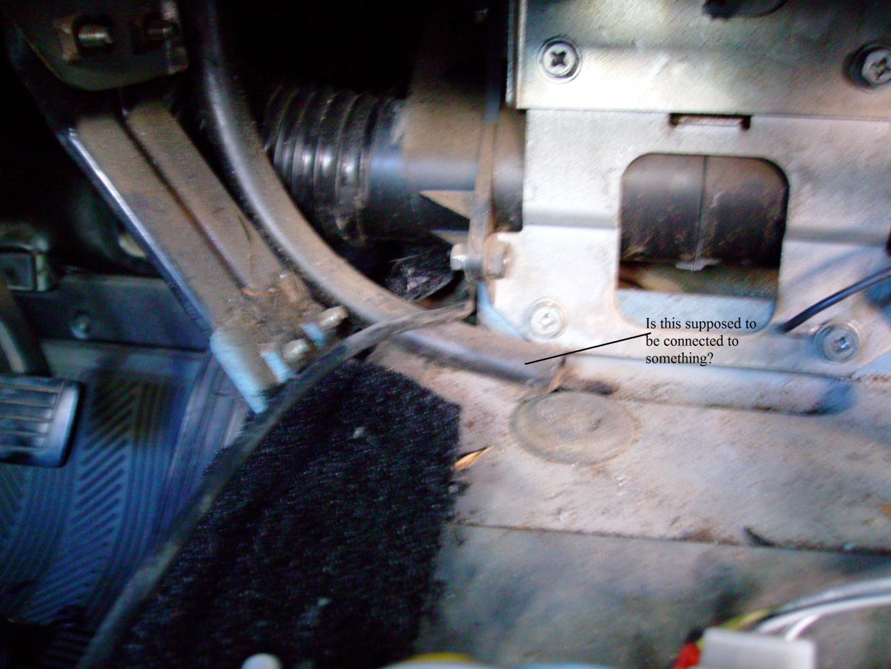

Secondly I found a vacuum line that is not connected to anything. Does it need to go someplace?

Hard to tell from the pics. The first pic looks like it could be the antenna lead, which would plug into the back of the radio. The second pic doesn't look like a vaccum hose. It almost looks like a drain hose of some sort. Can you tell what the other end is hooked to?

Thanks guys for the help. Did find that the hose was actually the drain for the A/C system. It would explain the hole in the top of the tranny tunnel I've found earlier. Did put everything back together and noticed that one yellow connection and one while connection were left free. Didn't find any wires around that were unhooked so I'm assuming that they are for the radio.
