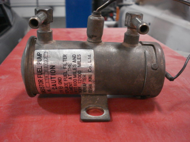

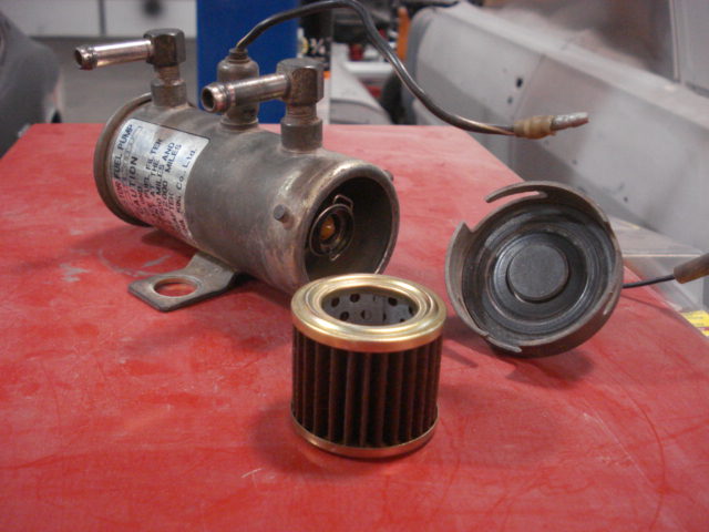

Check to see if your Z has an electric fuel pump back by the tank on the passenger side (most '73's do, I think). If so, there is a fuel filter inside the pump. If the filter is clogged it can cause the problems you are experiencing when you drive your car. Ask me how I know... ;)
Remove the bottom of the pump to access the filter. Here are a few photos:

so then is this seperate from the fuel pump at the motor? if so then ill definently check it. what exactly did your z do LOL

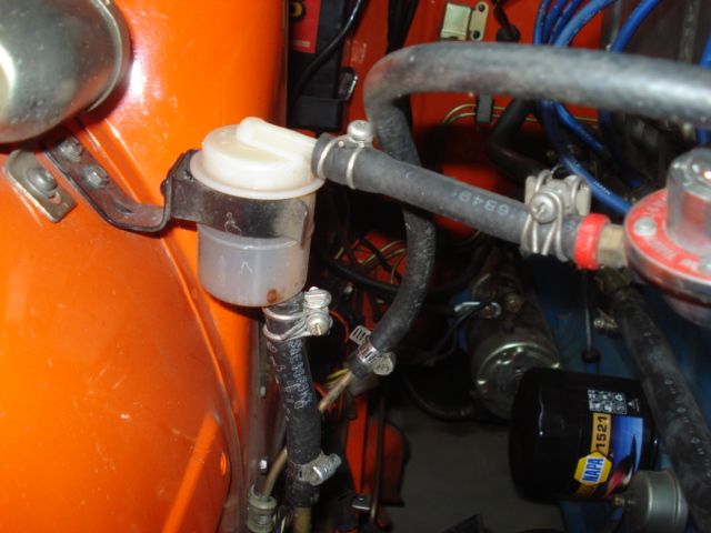

Yes, it is separate from the fuel filter in the engine bay.:rolleyes: Here's a photo...
When I got my '73 running it would idle just fine. I could drive it a short distance, but then it would start to lose power and ultimately the engine would die.:cry: I went through everything, points, rotor, plugs, plug wires, fuel filter (by the engine), replaced all the fuel hoses, etc.. and nothing helped.:ermm: I finally discovered the fuel filter in the electric pump and it was clogged with sediment.
I replaced it and the car ran better, but still not 100%. Turns out enough of the crud had gotten through that the new fuel filter in the engine bay was already clogged up, too.:mad: So, I replaced that one again and the car ran fine after that.:D

when you do the filter at the tank, do you clean it or replace it?
