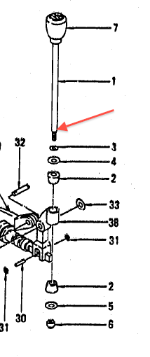

I did a search and there's a lot of threads on how to replace the bushings, but my problem is how people are getting the darned nut off at the bottom of the shifter rod. That thing is now fused to the circular rod, and i can't pull out the shifter and replace the bushings with it on there.
Any ideas? I heard mention that there is a 14mm flat spot but i don't see it ANYWHERE. Do I have to obliterate the old rubber bushings to find it?

This is the A tranny, which has the same linkage as the Datsun Roadster. On my roadster I used a 14mm wrench to hold the nut, (accessed from above) and turned the shift lever by the flats, as referenced above. I'm not sure if you access the nut on the Z from above or below, but the mechanism is the same.
