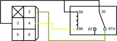

the old relay wire colors ----> new wire harness colors ----> relay pin numbers
black ---- red wire + white wire ----- 85 + 87a
yellow ---- Black ----- 86
green/white ---- Blue ----- 30
I' try to get better pics once i find my camera. and this is for a 1976 280z. Knowing nissan, they probably changed how its wired every model year, if not evey month... :)

in my pictures you can see the color of the wires on the old relay, and see where they connect inside. the setup they used was energized means light off.

on my 76 the relay color wire is solid black- solid yellow- soild blue- white with blue-white with green so how do I wire these color to the new relay
Don't worry too much about the wire colors on the relays (old or new). Only the coil and normally closed contacts are used.
I am attaching a picture of how the relay should be wired to the old connector. The colors match the main wiring harness colors according to the wiring diagram for a 76, courtesy of Phil, aka Blue. If you get everything lined up right, you'll have no problems.
Let me know if you have any questions.
