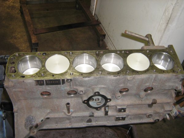

My case I was hoping it was caused by valve seals so I wouldn't have to deal with bottom end work. Took the time to do the seals myself (great learning experience) to no availe - still had to do the bottom end. Compression was excellent due to oil in the cylinders - I now guess.
Long story short - didn't feel like spending the money to repair the L24 so I bought an old zx and rebuilt the L28.

Up side is I now have a good engine - virtually the same a new with more hp.
