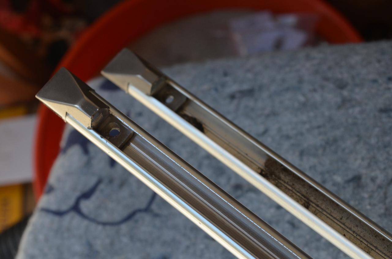

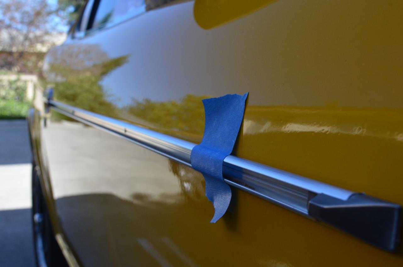

FWIW, I like the look of the side period correct, rivet-on molding, and it provides some protection from parking lot dings.
However, it's a personal preferrence kind of thing. Some like it, some don't. What's nice is that the vinyl inserts are available in different colors.
Here's a link to the correct style molding.
http://www.customautotrim.com/products/moldings/rivet.htm
