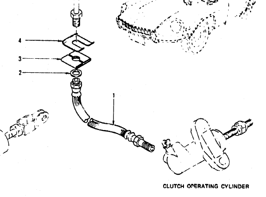

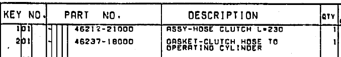

The original hose and slave on my car REQUIRED a copper washer, the part number from Nissan is 46237-18000 as shown in the attachment. (If you look at the picture on the parts fiche or CD, the washer is shown in the wrong spot, which confuses many people.)
In my experience, neither replacement cylinders nor replacement hoses come with the washer, but it is still needed.
Edited by Arne
So Arne, your saying that the washer (2) should go on the slave cylinder end versus the hose to hard line end? If so, your right, that is a terrible picture.
The first picture says so.. interesting. My old setup did not have this to my knowledge. I bought a large pack of copper washers today.
