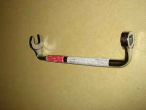

Does $50 seem to much for this valve adjusting tool?
My Z guru has one of these. He said he's saved a couple of thousand busted knuckles over the years by using it, and it's a bit faster, too.
True, you can get by just hunky-dory without it, but hey, we're largely guys and guys need tools!
The crows foot does seem just as easy and much cheaper.
What I'd like to see is a more precise (and quicker) way to get the cam lobes up. I have a hard time getting them right by bumping the starter and the fan makes getting a socket on the crankshaft bolt just about impossible.

You can put the car in gear and rock it back and forth to line-up the lobes where you want them. :beer:
