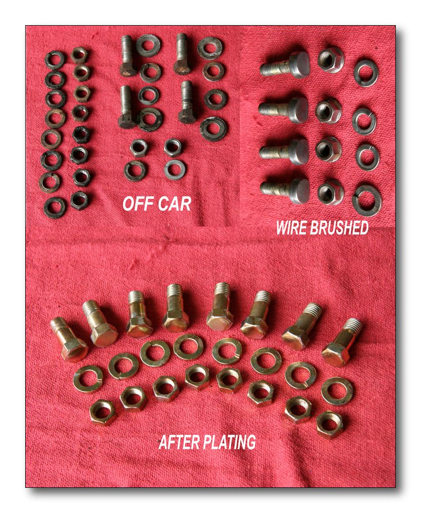

Here is a before, wire brushed and after plating picture of some of the bolts, nets, washers I have been working on for the last couple of months (I am slow because I work on it 4 hours a week). I finished my last few nuts and bolts last Sunday and will start to reassemble the rear suspension next weekend.
I plated mine with a kit from Caswell and I did buy the rectifier for the electrical supply as well.
The whole process was enjoyable, I used a wire wheel on a drill and a vice to hold each item. Once you get in the flow of the different dips (chemicals and baths) it will go fast.
