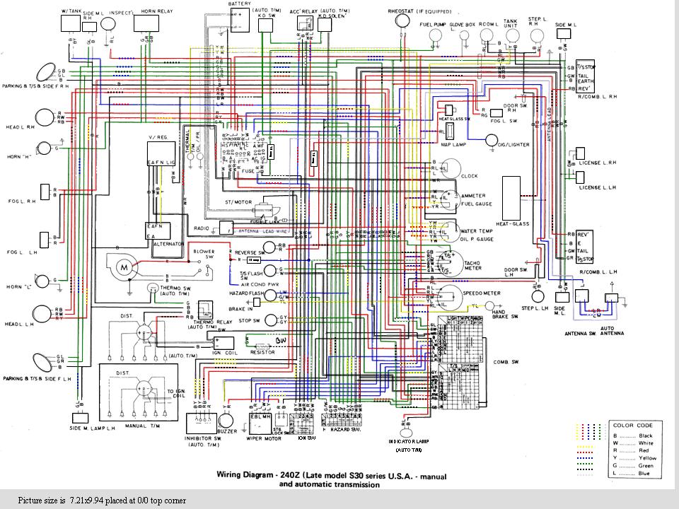

I found a decent schematic for you too. Attached.
