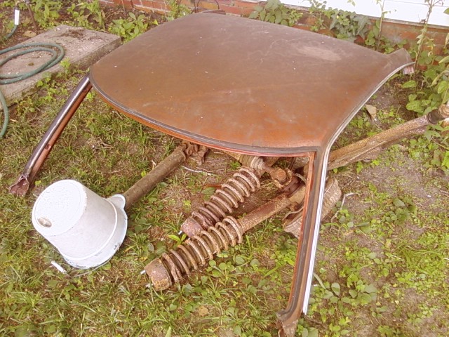

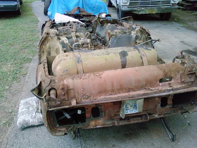

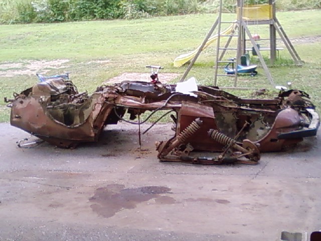

I have finally gotten rid of the parts car. This weekend I will put a battery in "Nadeen" and start fixing the damage from the battery being put in backwards (PO). I will post pics of the parts car tomorrow. (stripped and flipped, much like I like my women)
d240zx2: I have pics of the intricate stuff. When I started I thought I would post a complete pictography, it takes a lot of time to take pictures while taking a car apart. If I need a part from the bin it should be a game of "match and go".
This is the 1977, the last pic is the rusty hatch I cut my head on. It hurt like a hctib.
that rust bucket really looks like it sat at the bottom of a lake.. ive never seen rust soooo bad. (and im from california where i 4x4'ed in the ocean on a regular basis LOL)
