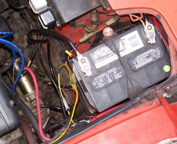

These seem like a nice length:
You might want to remeasure if you have the positive post, top or side, under the wing. I had to use a 26" with the top post and still have some slack. The OEM black one I replaced is 26", with a red one for the positive. The original black ones got me confused one day and I found out what a fuseable link smells like. :)

Long as you are not trying to win a car show in the "original" category, it makes more sense to go with side connections on the battery. No concern of the positive terminal contacting the inspection lid, and less chance of sparks fliying when servicing the connections.
I'll second that. My other Zs were outfitted that way when the batteries died and my current will be when it's battery dies.
