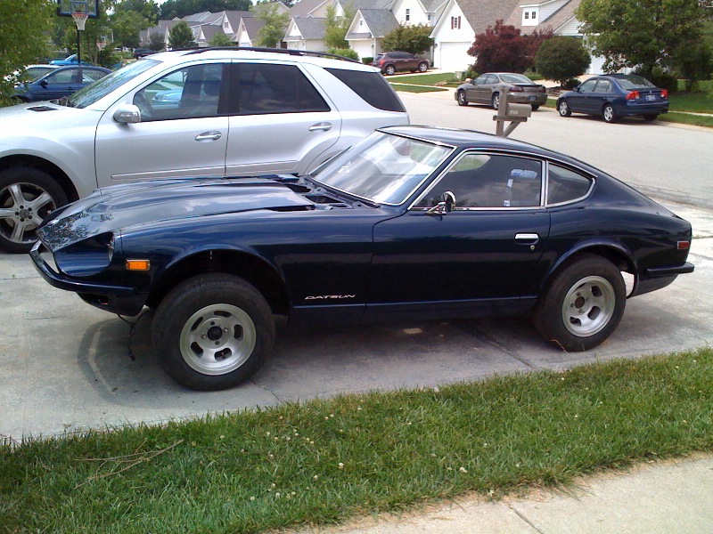

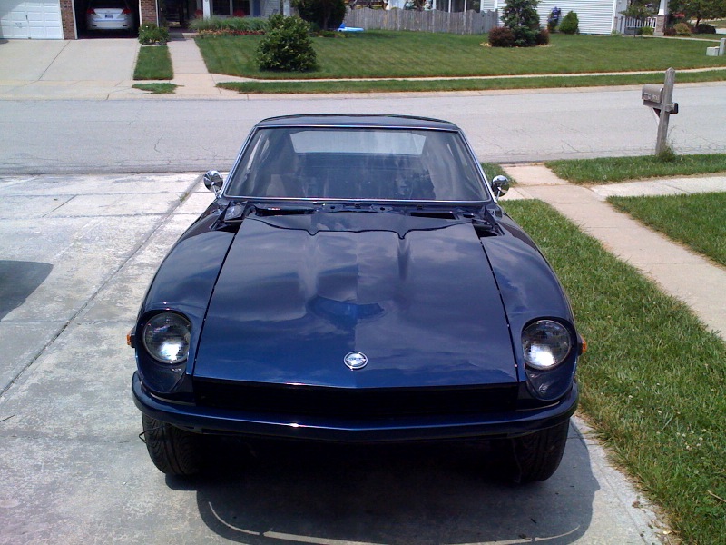

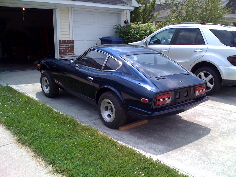

Well it was only 1 1/2 years waiting but my car is finally home. It was delivered last Friday night. I am so happy to actually start working on rebuilding it not just taking it apart. I put the marker lights and the brake/rear lights in this weekend. Also the stainless drip rail above the doors. I have been putting fat mat in today and am about halfway done with that. I am pretty darn happy to have the car home but there are a few things that need to be sorted out. The body shop guy welded over the holes for the c pillar 240z emblem and the holes for the hatch emblems. I went to put them on and stood there looking around trying to find the holes. I will figure out someway to put the c pillar ones on but I am not sure about the hatch ones. Time will tell. I replaced the bent and rusted bumpers with fiberglass ones for the time being. I think it makes the front and rear ends look dark/plain. At some point in the future when I can afford it, I will either have the old ones fixed or buy the stainless steel ones. I think shiny bumpers would really dress it up. Also, I would like to put Rota RBs or Panasports on it as well. I will post more pics as I make progress.
