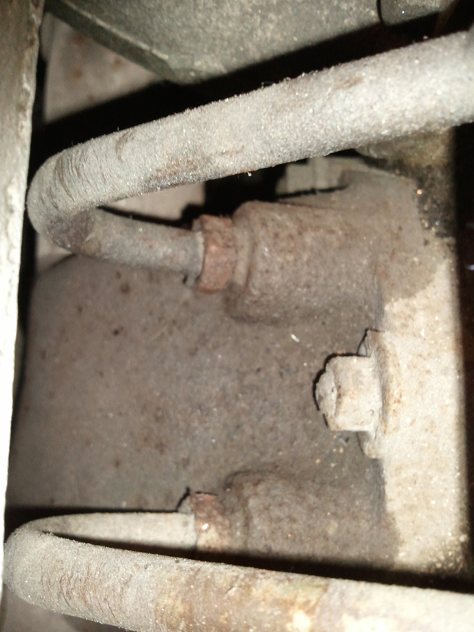

Now im stuck in this situation: i was trying to remove the air injector tubes along the manifold but they are rusted in place.. Im quite sure theyll snap broken if i try to use too much power.

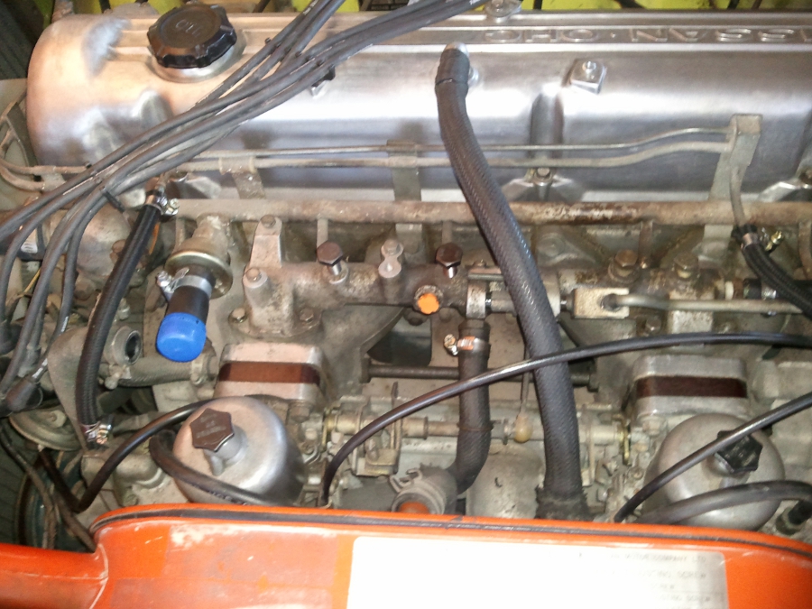

Little update. I needed to make this DIY patent in order to move the car to it's new home. I've removed everything except that injector tubes and air pump (its not connected anymore). Car starts okay and runs better than before. Carbs are running VERY lean atm but it's somewhat drivable.
BUT now it leaks exhaust or something from the engine, im quite sure that my patent doesn't leak. If car is runned inside, you have to wear gasmask. Its that bad.
I didnt have this problem before removing smog.
