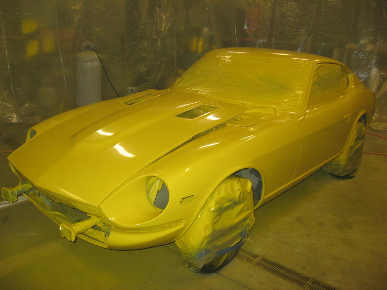

Thanks, The final prep work makes the difference I was surprised that there was no dirt or dust in the paint, most likely the plastic that was hung and cleaning the car 3 times before spraying. I also have a little over a quart of paint left over for future touch ups if I need it. :):)

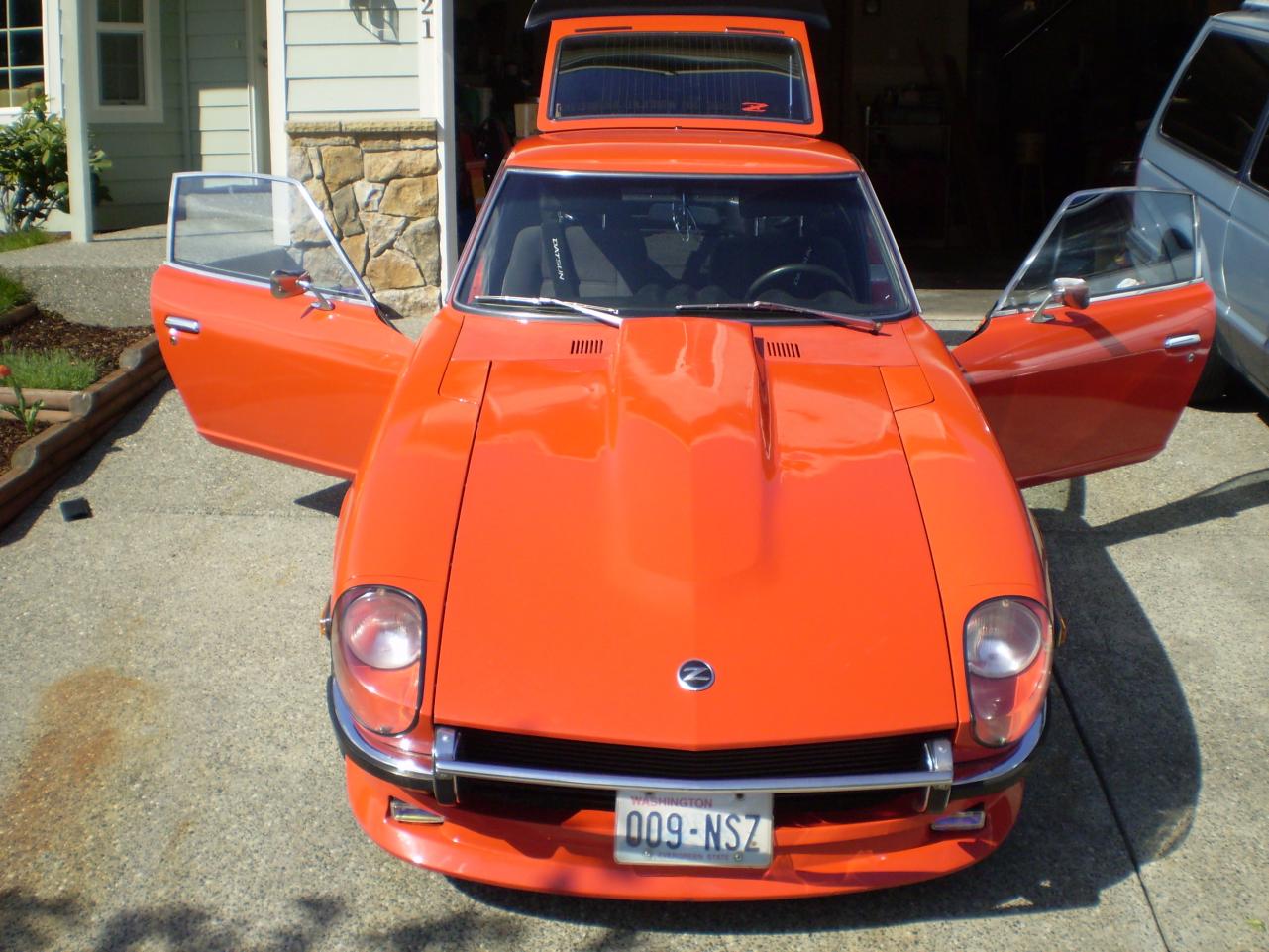

Still having fun. My car is home in the drive way. So here are two questions:

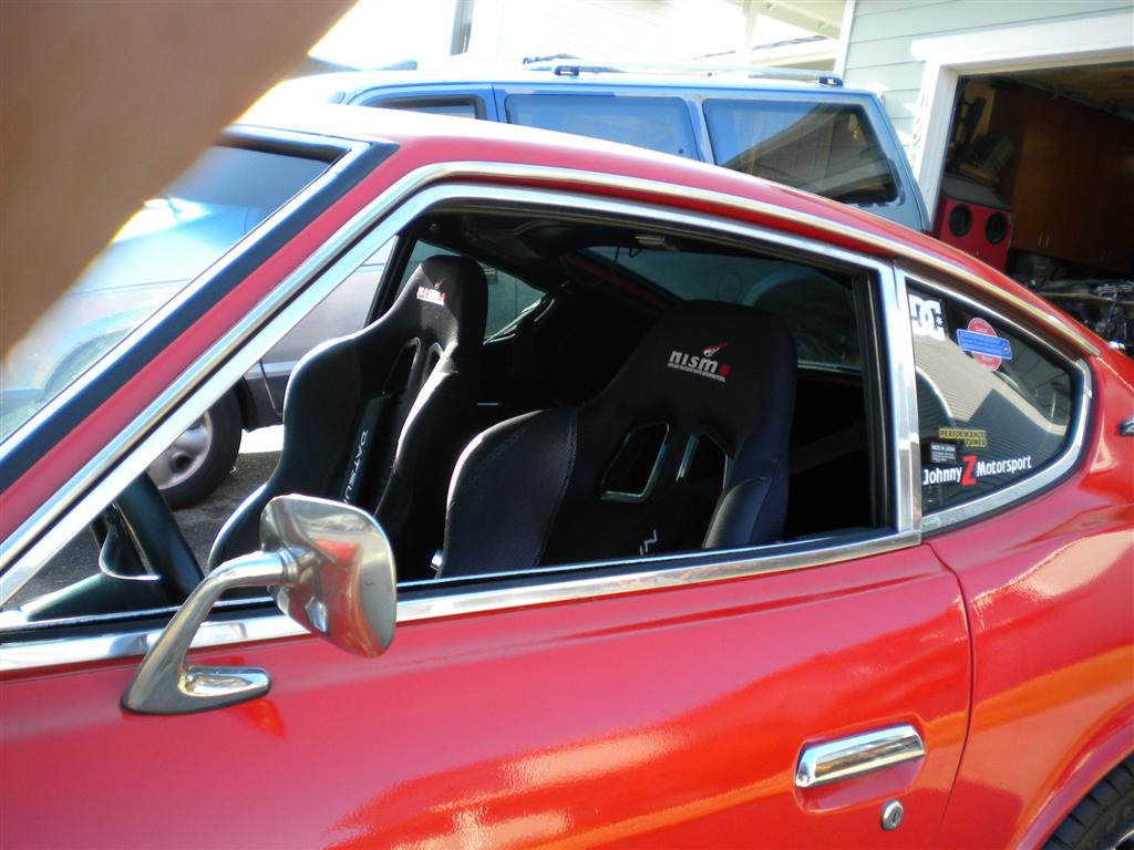

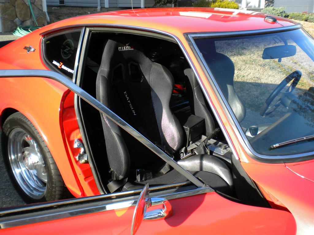

does anyone have close up photos of the "upper outer hatch seal" I am confused by what BD sent me. And any suggestion on what mirrors I should install, I have the old one that are complete crap, left and right racing mirrors, you know the ones that have the rubber ribs and are only a little lager than a dental mirror, or a pair I pulled off a 77 at the junk yard that sort of look like ones I see at shucks auto, only they are black not chrome.
anyhow pics of other mirrors that you have installed would be nice.
i hate putting the small things back together. its not that i cant, i just lose patience fast. like with door handles aligning stuff etc. of course when everything is said and done you can take a step back and enjoy the fruits of your labor... but anyways, the Z looks great!
I think your Z would look great with a set of classic Early mirrors on it. Just buy 2 Left sides, Instal the left door mirror than shave a wedge off the base of the right door mirror.
I love mine..

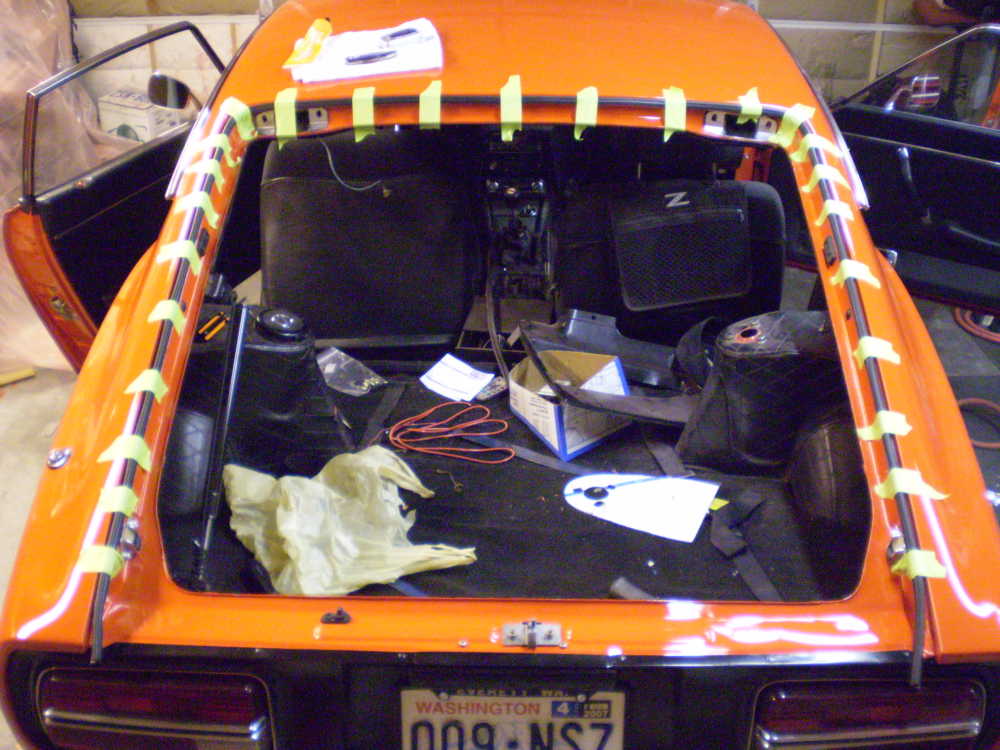

Here's a shot of me installing my outer hatch seal after paint.
A couple example pics, to give you an idea of how classy the originals were.

Thanks Dave, is you're outer seal one piece? mine came in three section from BD the sides are a no brainer it is the upper center piece that has me confused. it is a different profile more rounded with two slots.
Anyhow the car is now back home in the drive way with a cover over it, I will need to wait for warmer weather before continuing with the rubber pieces. I will post more progress pics this weekend. I have a set of mirrors but I am unsure if I want to install them. My Z budget is now broke so I may just go with what I have, but there is no rush.
Yes, mine is a 1 peice.
The center peice on a 3-peice kit is different than the 2 side peices. The 2 sides have a flat profile with a small round hump and the center peice is similar to the inner seal, in shape, but smaller.
Rough up the paint a little before applying the glue. also rough up the rubber peice to be glued as well. Use it as a contact cement. let it get tacky on both sides before applying the seal to the body.
