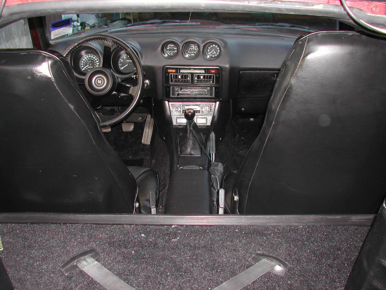

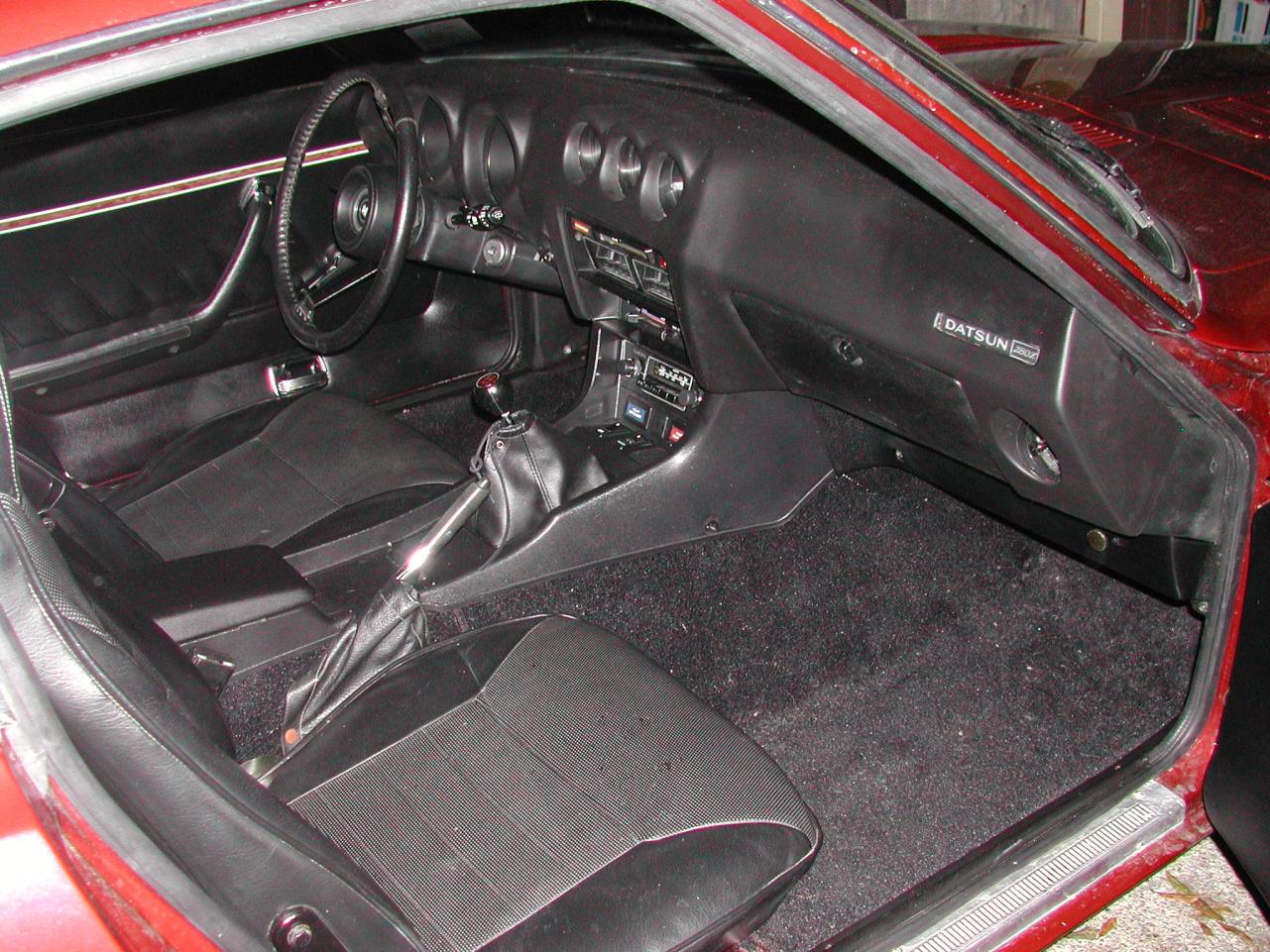

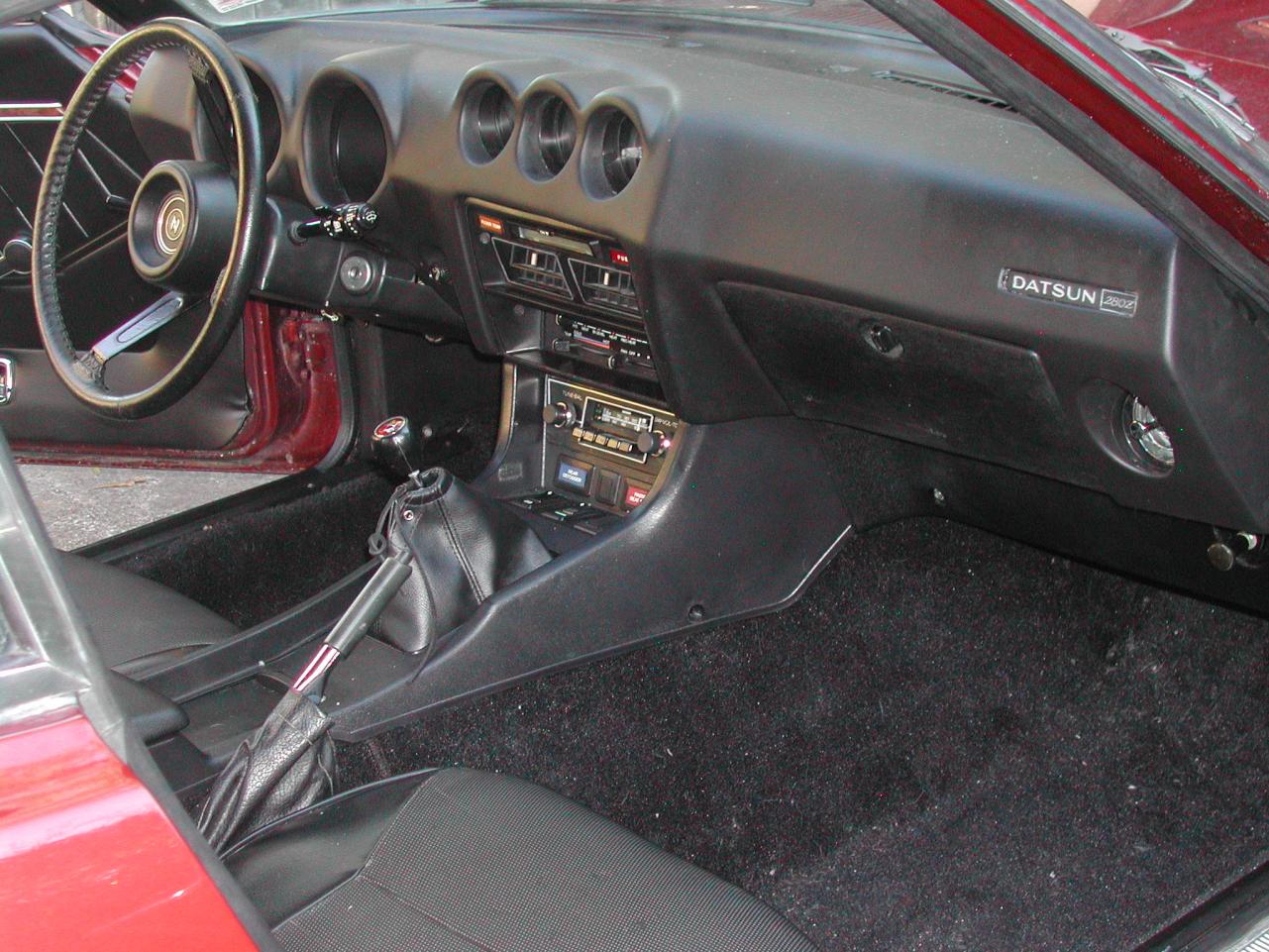

I believe there are a couple of different manufacturers. I bought mine on ebay (not from the MSA outlet) last year but don't recall who the seller was. Here are a few photos.
