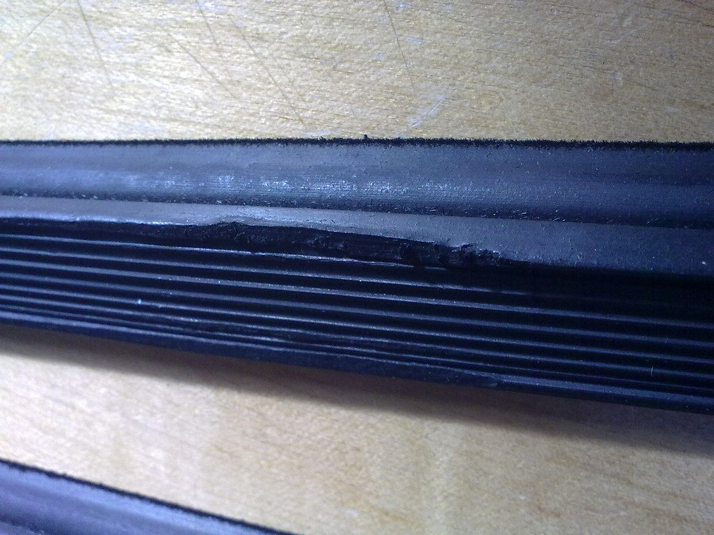

I received and installed the squeegees today. I would give them a 75 out of a 100 score. Considering they are about 1/3 the price of new molding strips, that's not bad. Also, one of them had a small gouge in the rubber that would be visible. I am not one to return things due to my lack of patience, so I used them anyway.

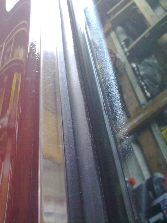

1) Remove the moldings from the car by prying on the rear portion with a plastic putty knife. Pull it up and work forwards by hand. (careful not to drop the window roller into the door. A magnet will retrieve it :stupid: )

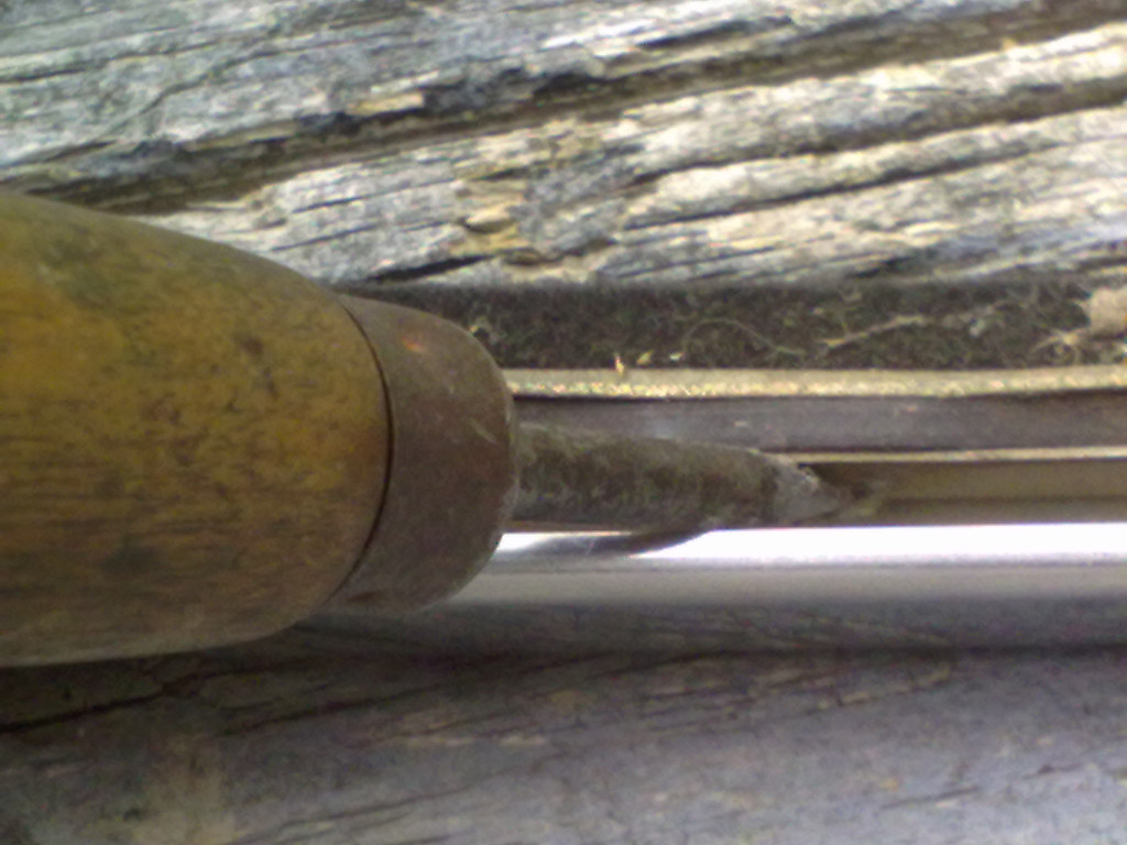

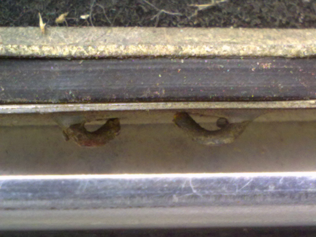

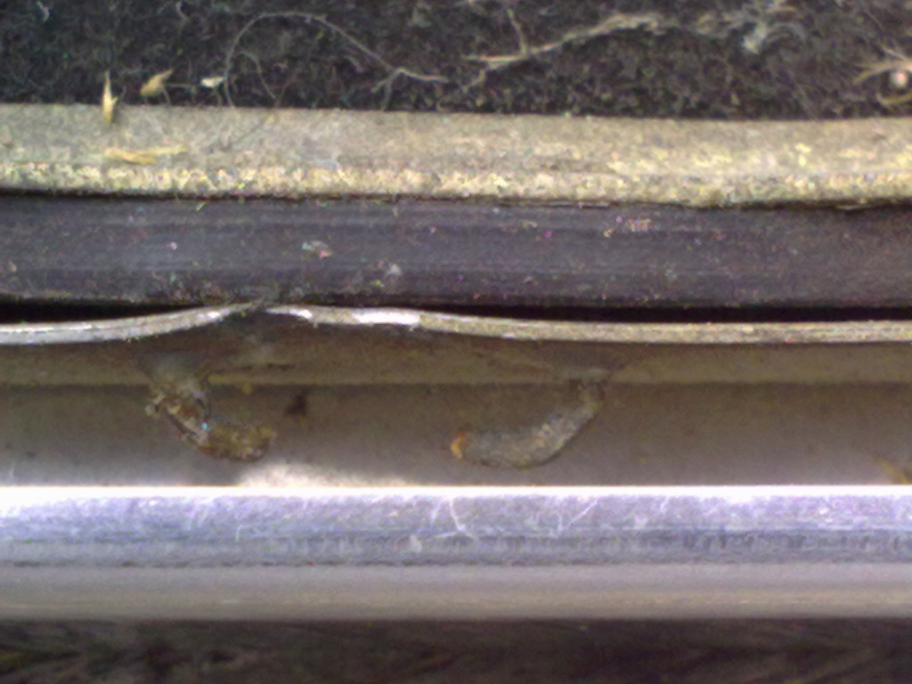

2) Use an awl to bend open the staples, and raise them up.

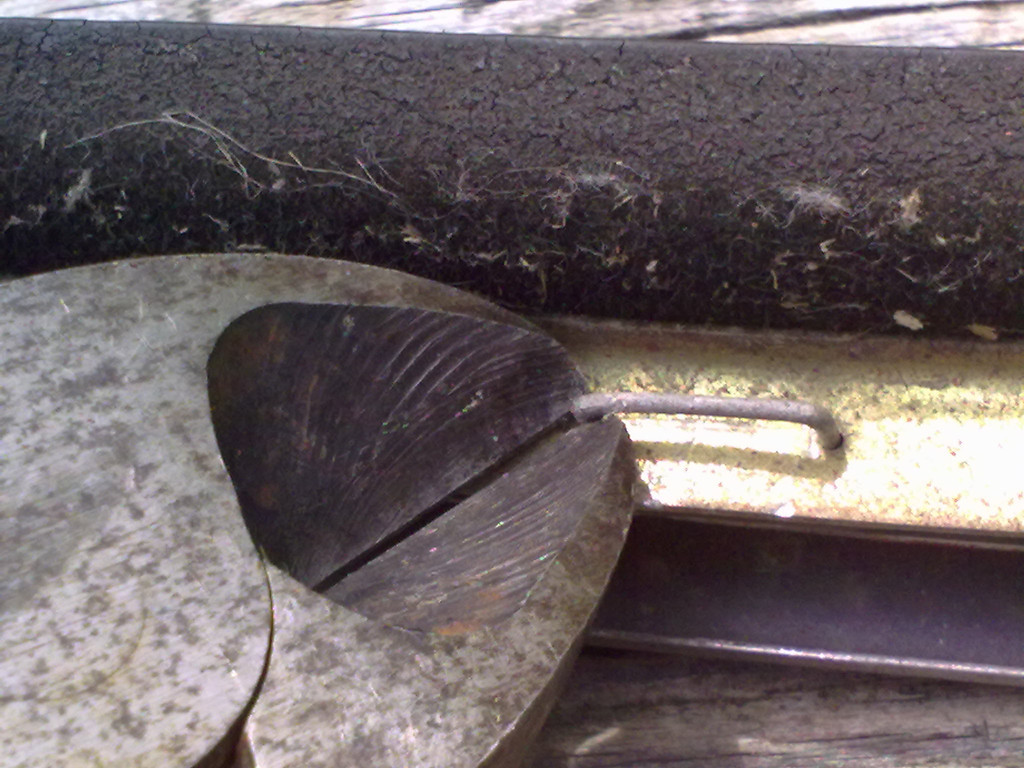

3) Snip the staples with a cutter.

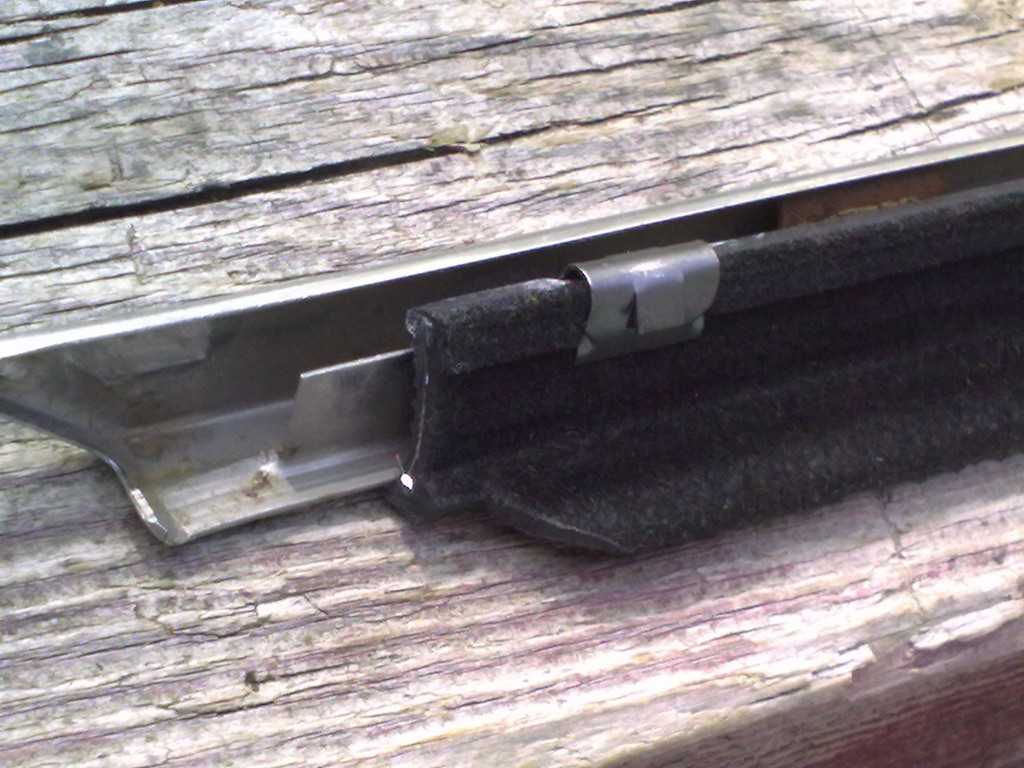

4) Line up the new rubber strips at the back of the chrome molding, note where the original strips began.

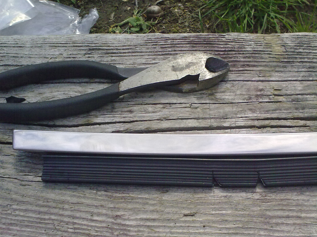

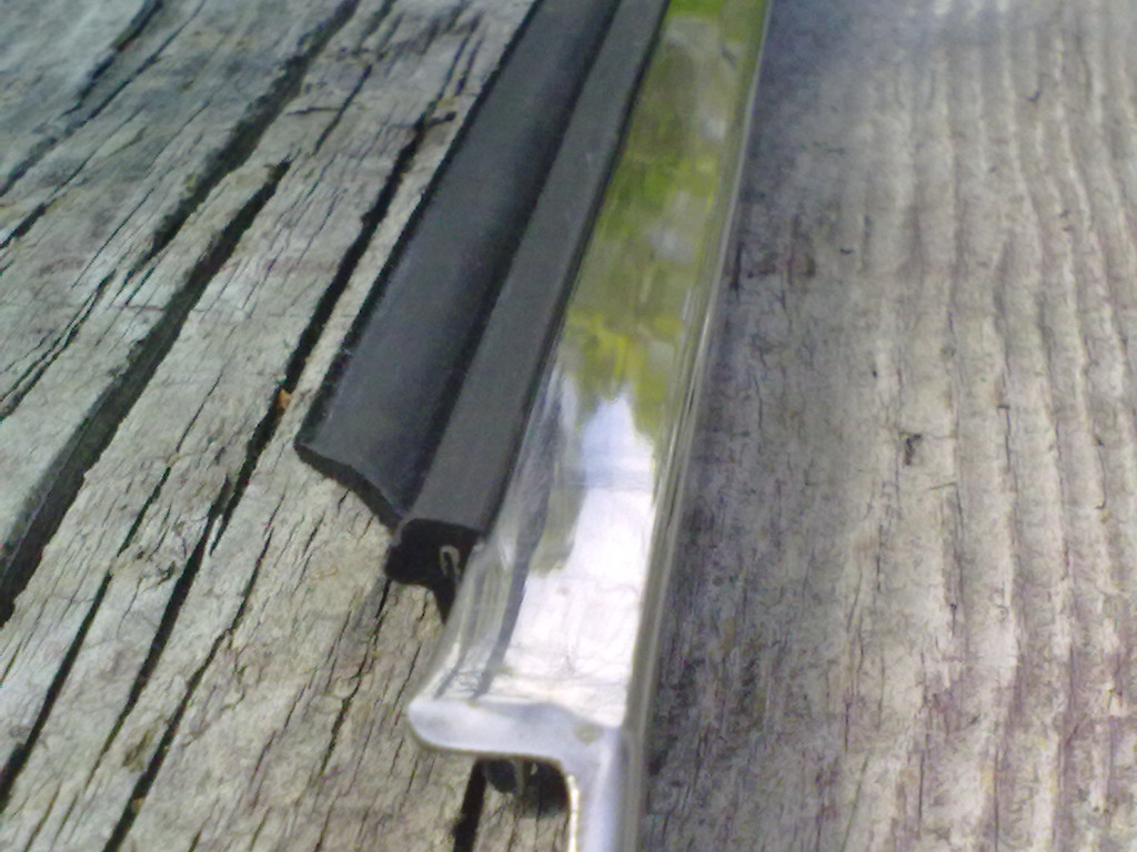

4b) TIP: To match the slight curve of the original chrome molding, snip the new rubber strip as shown, in one or two places. (photo 5 below)
5) Press on the retainer clips, longer side of the retainer should go inside the molding channel.
6) Trim the angle into the forward edge of the new rubber to match the originals.

Comments: The window stays up tighter now and does not drop down while driving at all. When the window is partially rolled down, it does not rattle over bumps. With the windows shut, the door closes with a more solid sound from the window being more tightly held in place. Looks fine to me. It took about 1:15 to do both sides. A few more retainer clips would be nice and make sure you don't place them over the OEM molding clips inside the chrome trim. Keep all forces in check. Don't strong-arm anything or you could dent your moldings. Hammer on the new clips with a hammer's wood handle, while holding the assembly in your other hand. Gentle!
