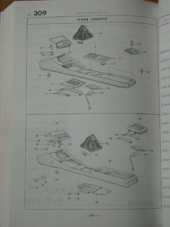

Just in case anyone wants to crunch the numbers on these parts, here they are;
*86720 - E4100 "FINISHER - floor console"
( "early" type )
*86728 - E4700 "COVER - finisher"
( "early" type )
*86720 - E8750 "LID arse'Y - floor console"
( "later" type for all models except Fairlady Z "base" model )
*86720 - E8751 "LID arse'Y - floor console"
( "later" type for Fairlady Z "base" model "S30", which had Parking Lamp system as Optional Extra )
*86723 - E8700 "GROMMET - parking switch"
( This to be used on 86720 - E8751 where Parking Lamp system is not chosen as an Option ).
Here's the schematic from the Japanese parts list manual for the cross-over period, where both types are shown;

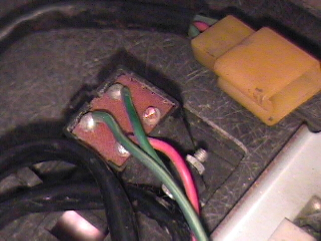

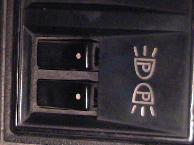

Quote: "What I'm hoping to get out of this post, is that someone will be able to post either a picture of the ACTUAL switch,..........."
- at least you got a front and rear picture of the switch. You don't seem to have been particularly pleased with what I came up with -which makes me feel I should not have bothered.

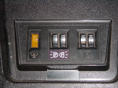

I have a question relating to the installed panel in your car (late Model) position 1 demister switch, position 2 LH& RH parking light switches, position 3 is ??????
please fill in the blanks

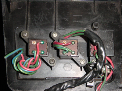

Steve, that switch on the right hand side ( position 3 as you call it ) of my installed panel on the ZG is actually now redundant. If you look at the picture of the reverse of the panel you can see that the wires have been simply cut and tied off. The switch itself is identical to the Parking Lamp switch that is in the middle, but the actual position is marked by a "fan" symbol........
When my car came over from Japan, it had a lot of aftermarket accessories / nonsense fitted to it. These included an LED panel that indicated Oil Temp. and Water Temp. and a very nasty audio setup, as well as all sorts of other iffy bits and pieces. It also had an Air Con unit fitted to it ( one of the Factory types ) and the wiring for that was pretty ugly too. The Switch on the right was performing a non-standard function in connection with the Air Con.
All that stuff came off and went straight in the dustbin. I saved some of the switches and other useful-looking Factory bits for possible recycling on other projects.
So, at the moment its unused - but it is in fact another Parking Lamp switch as far as I can make out ( the wire connections / colours are identical ).

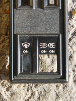

Hello Enrique,I am KATSUHIKO ENDO from japan.My english is not good but I love Z very much.
I have a switch for parking light,if you want I can sell it.But I am not sure it works or not.I was thinking about selling it to the yahoo aucyions in japan but I would rathar want to sell it whom really want it.Please take a look at it.
I met Mr.Alan Thomas at fuji speedway in japan in 2001.He is really nice man.I was surprised his knowlege it is more than japanese Z car owaners.It is exciting to me talking about Z car with him.
I put 3 photos.
